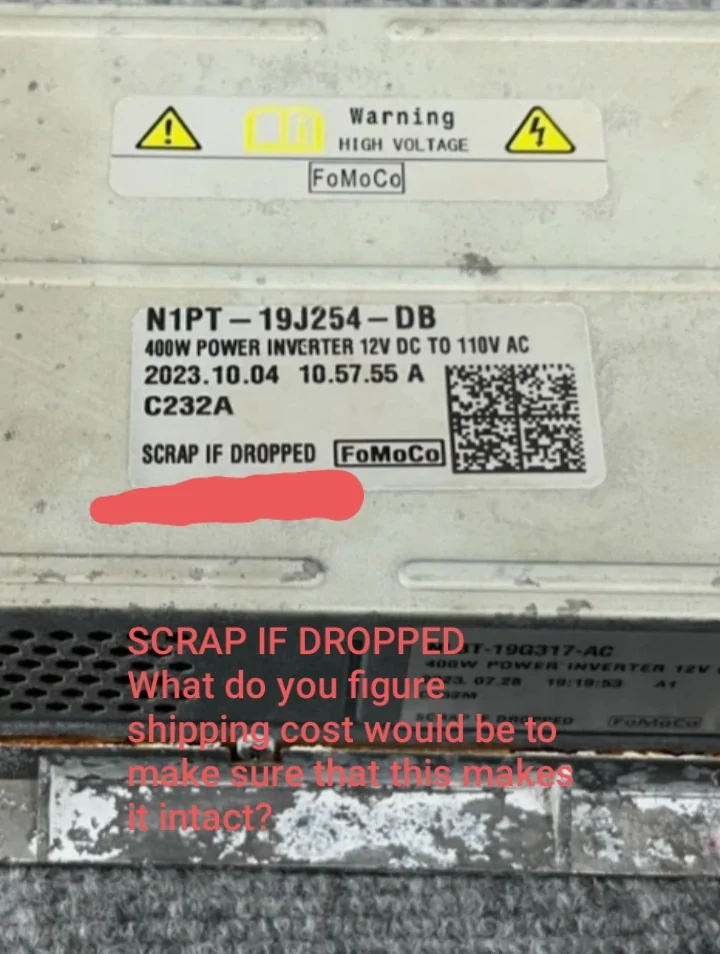

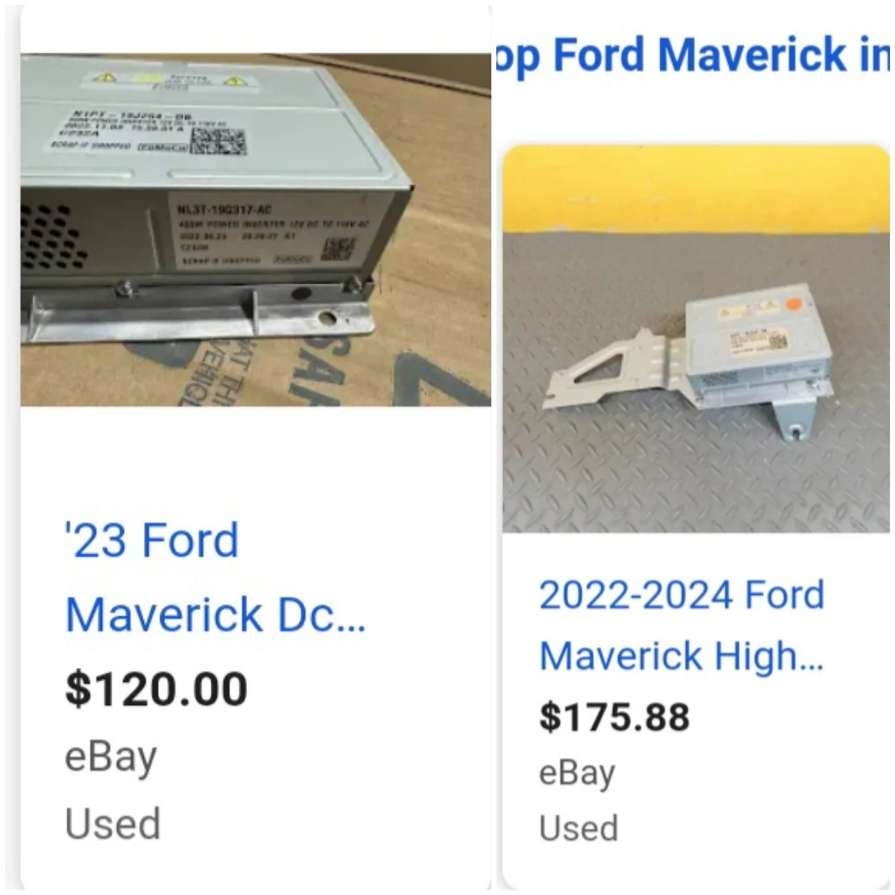

Or a part gets damaged in shipping good example is this here. This is the 400 watt inverter located under the console.
How well do you pack this while still maintaining a competitive price with those that are listed on eBay?
