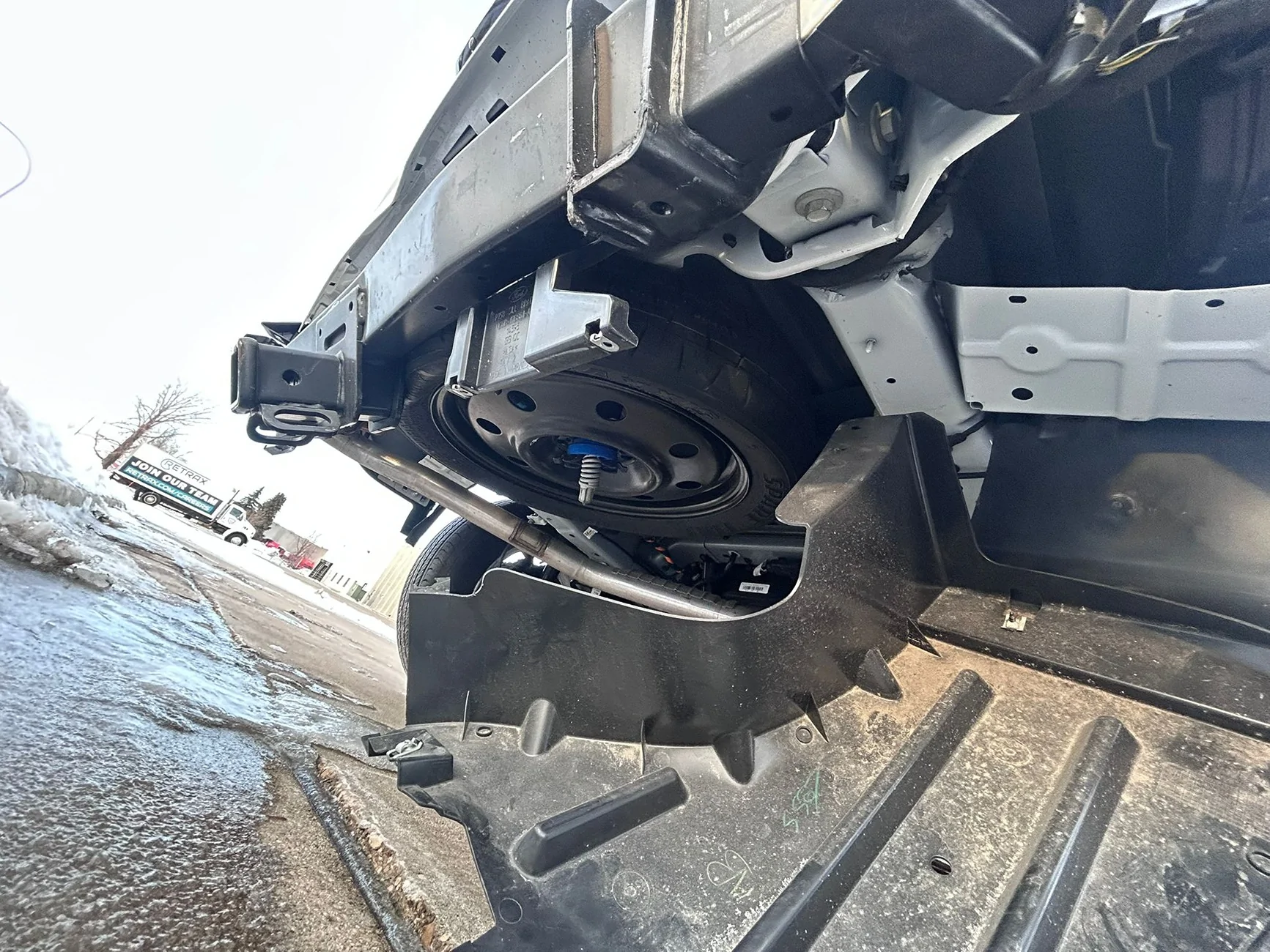

Thanks for your responses. Those professionals didn't take a look in person only pictures since am out in rural. Yes there was a damage to the rear bumper and hitch reinforcement. No Airbags deployed. I have been reading and looking online on Ford maverick diagram, and it appears it may only be the flanges or so-called Rail end‑face where the hitch connects but may be not the entire rail frame. because it its only minor rear end, if the boron steel is this hard. It shouldn't bend, if it did, then airbags should deploy but they didnt. I am having hard time determine that, I don't want it totaled i just need to fix this and get it inspected and registered. Any thoughts would be appreciated.
Air bags deploy on how fast a vehicle stops, rear end damage like that likely pushed the vehicle in forward motion, if you were parked against a brick wall or a tree or had another vehicle in front of you and your vehicle couldn't move forward when hit depending on the speed of the vehicle that hit you the bags could deploy. Many times the cost of air bags,
sensors and control unit total a vehicle alone of course including the damaged areas.
Yes that is frame damage, there are many repair shops that don't care about insurance regulations and would repair that damage. I believe there is a rail section for that right rail but the cost of replacement would total the vehicle. The Maverick holds its value well BUT its not a expensive vehicle and salvage value would be high.

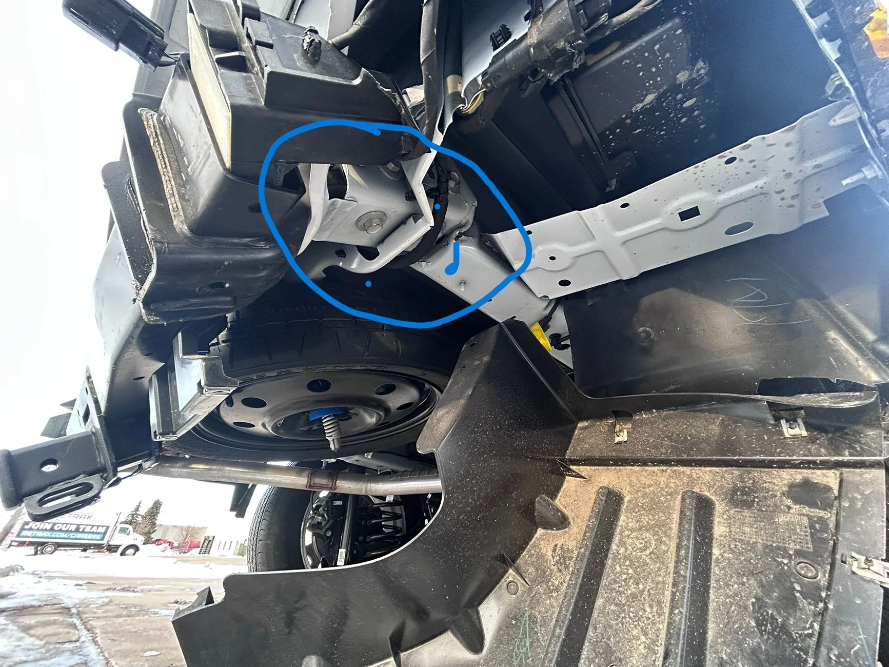

🤔 Your Maverick Is TOTALED.
The areas that you circled are part of the boron frame.
There is no heating unbending or repairing of boron steel.
It has to be replaced.
This is part of what needs to be replaced.

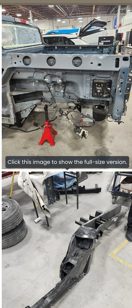

Actually the Maverick can sustain quite a crush. It's sacrifices itself instead of passing on the forces to the occupants on the inside.
Bent rails under the bed, will do it.
https://www.mavericktruckclub.com/f...hop-unable-to-drill-out-all-spot-welds.77088/
Pictures from the thread.☝🏻
If you take a look at the below threads you'll see it how little damage total a Maverick by bending the boron steel.

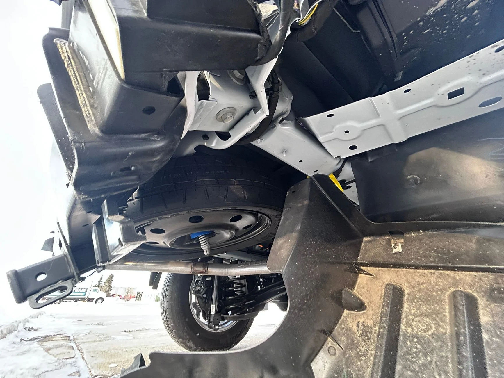

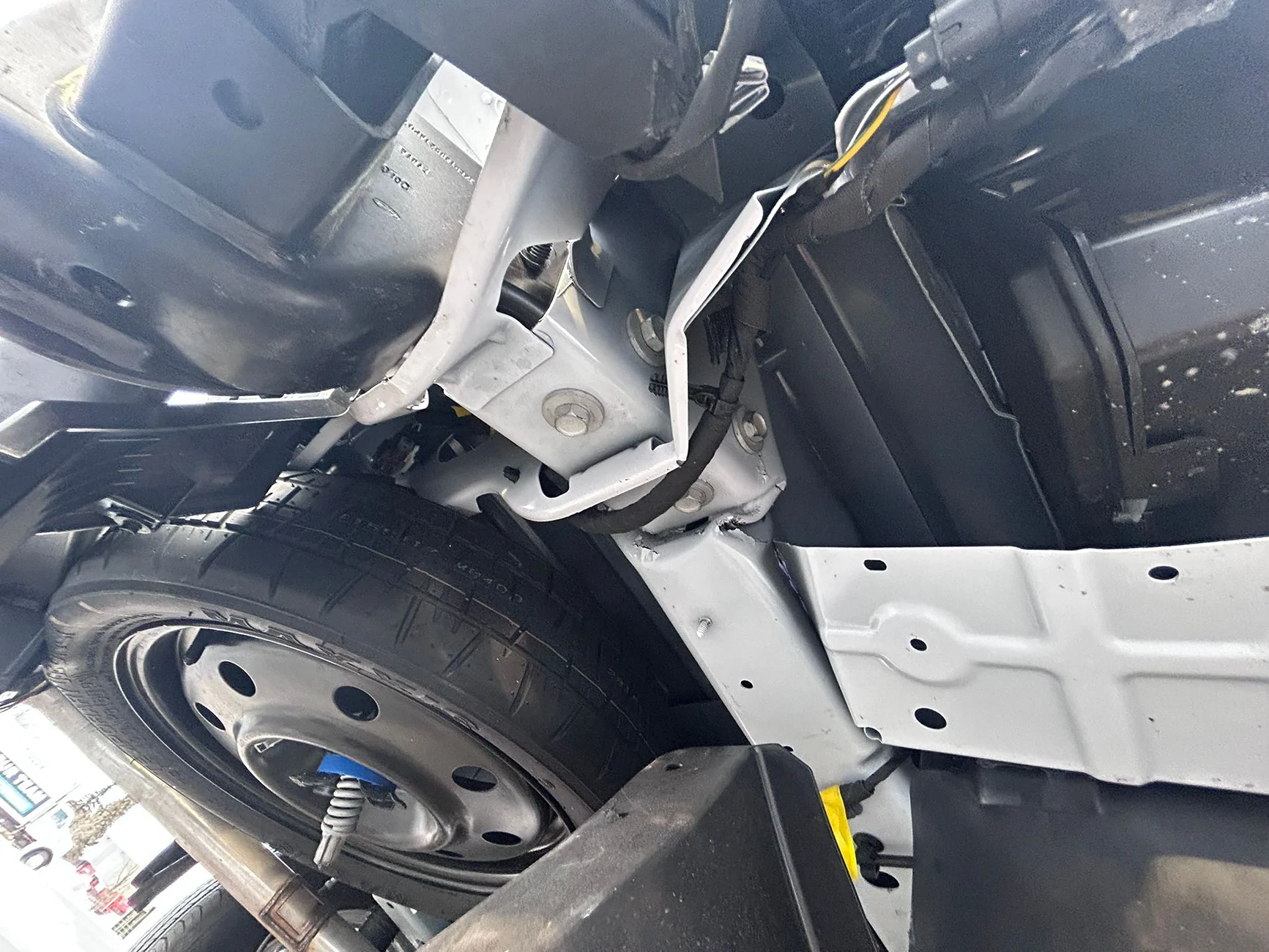

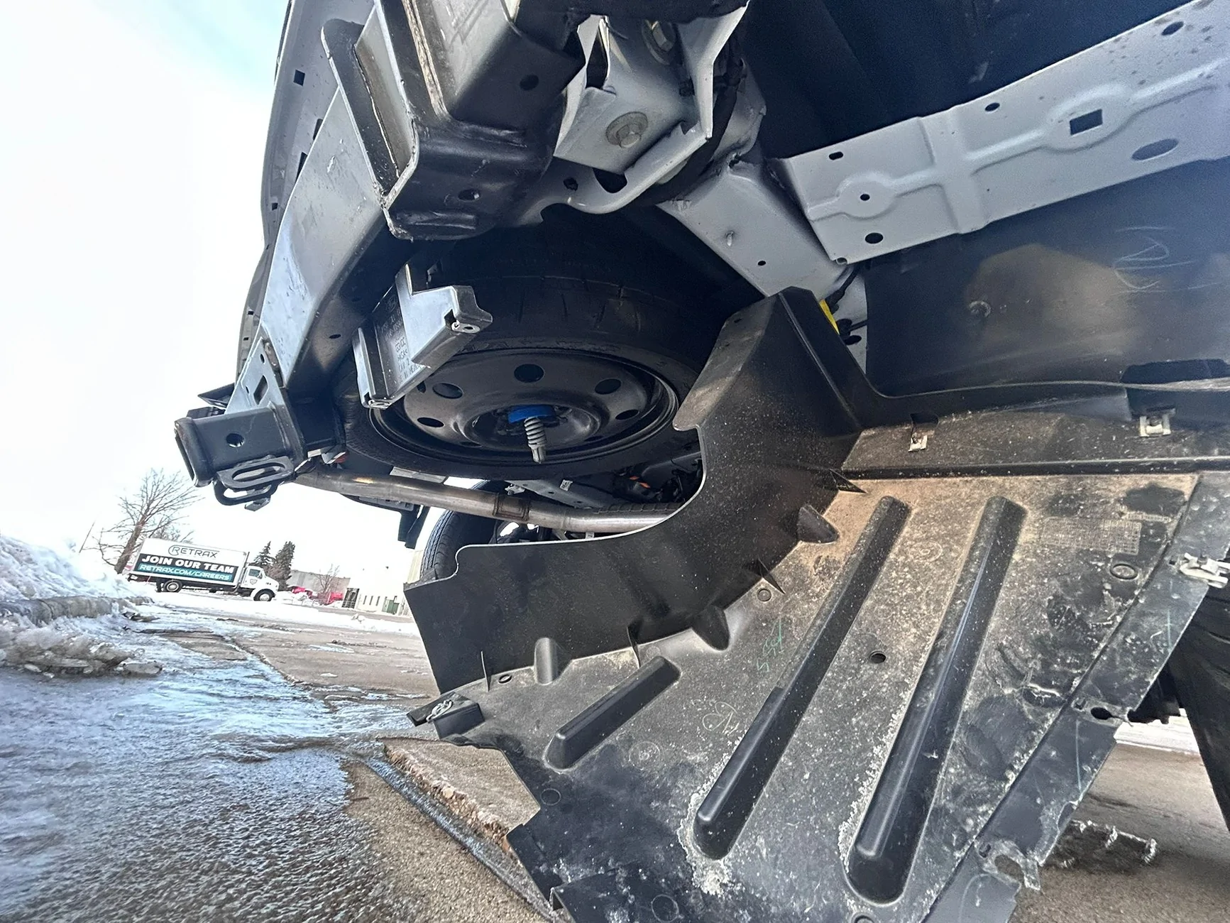

Rear tow‑beam on my 2025 Maverick Hybrid got pushed downward. Two shops say the rear rails (boron steel) must be replaced. My photos look like the integrated hitch/impact bar is bent and some thin white sheet‑metal lips got wrinkled. I need the community’s eyes: is this truly rail damage, or just the beam + thin flanges + brackets? What should I measure/check before authorizing a rail job? Is there a diagram that i can look into?

That photo gave me flashbacks instantly lol. My rear frame area got hit almost the same way after somebody rear ended me in stop and go traffic on the interstate. Then the idiot tried saying I “stopped too fast” even though traffic was already backed up for miles.
Insurance became a nightmare because the hidden damage around the frame and tow hitch kept increasing once teardown started. Eventually I went through SAM LAW OFFICE for it and thank god because after months of arguing I finally got the damage covered and repaired properly.

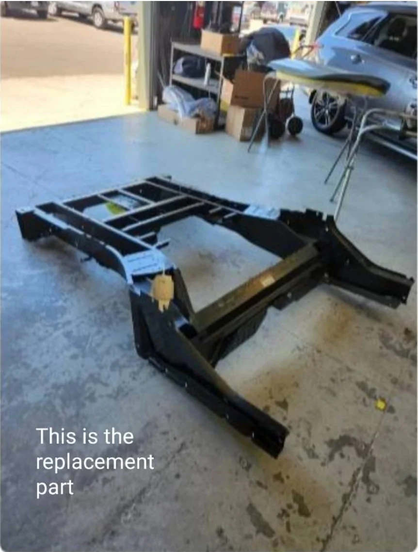

There is no heating unbending or repairing of boron steel. Once boron steel has been compromised. It has to be replaced.
