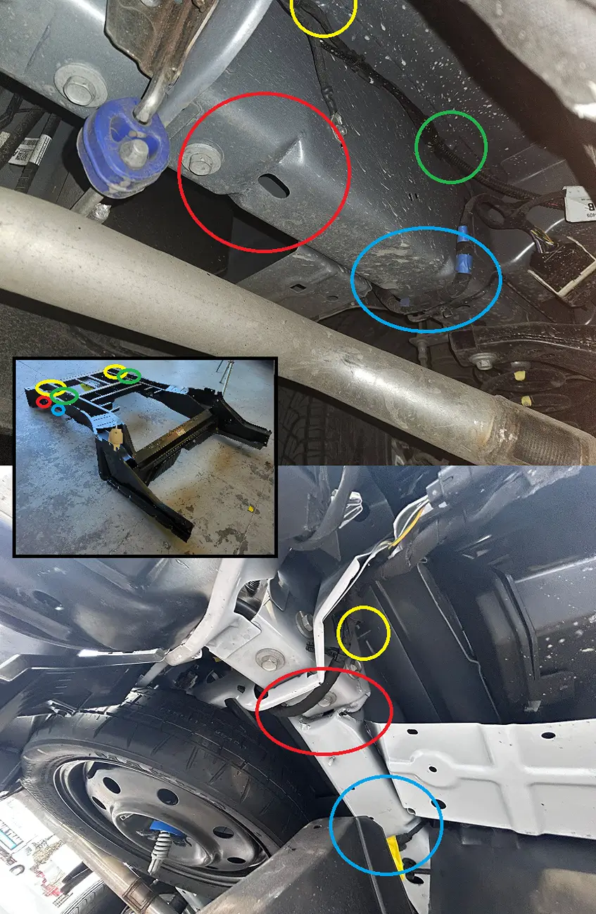

Rear tow‑beam on my 2025 Maverick Hybrid got pushed downward. Two shops say the rear rails (boron steel) must be replaced. My photos look like the integrated hitch/impact bar is bent and some thin white sheet‑metal lips got wrinkled. I need the community’s eyes: is this truly rail damage, or just the beam + thin flanges + brackets? What should I measure/check before authorizing a rail job? Is there a diagram that i can look into?
These are the engineered crumple points on the frame (top pic is driver side but they are the same). The red pair on your truck is obviously damaged but even the blue is crushed a little. I assume the other side is similar.
It looks like the rails had their own part numbers (can't find it listed for 2025) inside the assembly but even replacing just that would likely require taking almost everything apart.

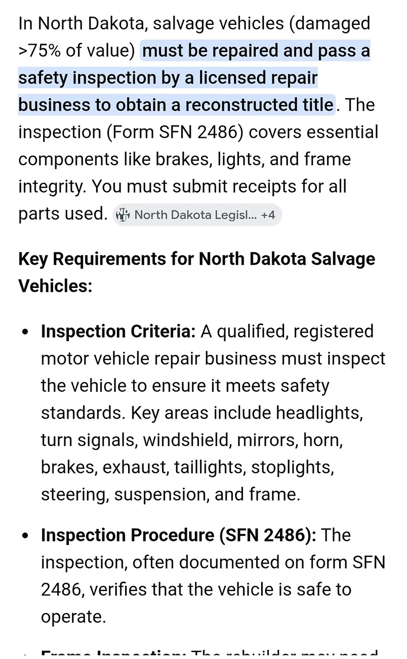

Personally, I would pull the unibody rails out as well as possible and cut off the trailer hitch. Fix the cosmetic damage to pass a rebuilt inspection. Drive it for 200K without towing anything ever again. Liability insurance only. Scrap it once wore out. This is the best possible way of getting your 14k back out of this truck.
You might be able to do that in Ohio, but in the OP's state, North Dakota, salvage titled vehicles (what the OP has) MUST be repaired at a licensed repair business, rather than his backyard, and must be certified by another, different licensed repair business, not his neighbor for a 6 pack of beer.
In entirely different circumstances, your idea might work, but in the OP's it won't.
He can't do the work himself and get it back on the road legally in his state.
But it only has to be repaired to road worthy, not showroom condition.
