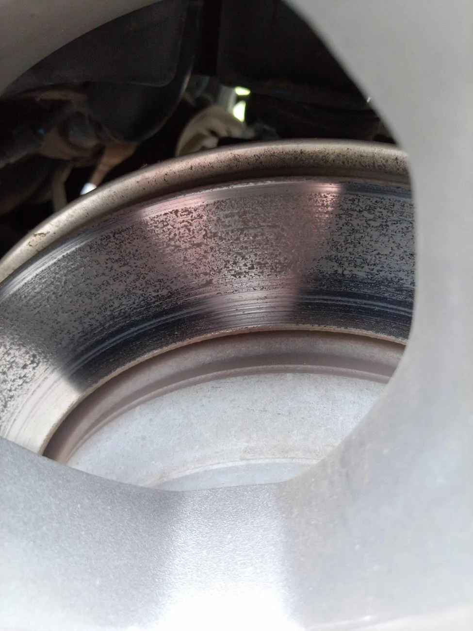

Since new, my rear rotors don't get shiny with use like the front do. Hmm
These are mine after a few days of stopping much harder than normal to try to scuff the rust off. Both sides are the same, and were far worse before. I just drive normally, don't try to hypermile, and the rears get used so little that were it not for the rust issue they would last forever. Going forward it's going to get a solid brake application at least a couple of times a day to try to keep them clean.

I drive like my avatar (shooting for 50 MPG) and my hybrid barely uses either front or rear enough to keep the rotor rust under control. You might consider the possibility that the electric parking brake system is not fully releasing. One easy way to quick check such things is to drive at constant speed a while and coast to a stop, then use an infrared thermometer to see if any of your brakes are warm.

There are known problems with the Bronco Sport and Maverick rear brakes - Ford is being dodgy about it. There is a TSP from Ford on the Bronco Sport but they are, as of writing, refusing to acknowledge the Maverick, which uses the same brakes as the Bronco Sport.
It is possible that in your case the electronic parking brake isn't fully releasing and is dragging the pads on your truck.
