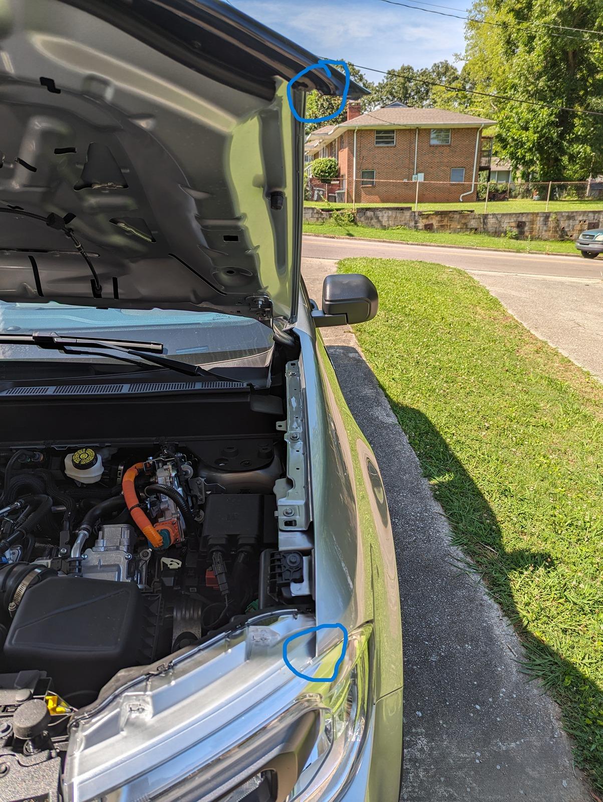

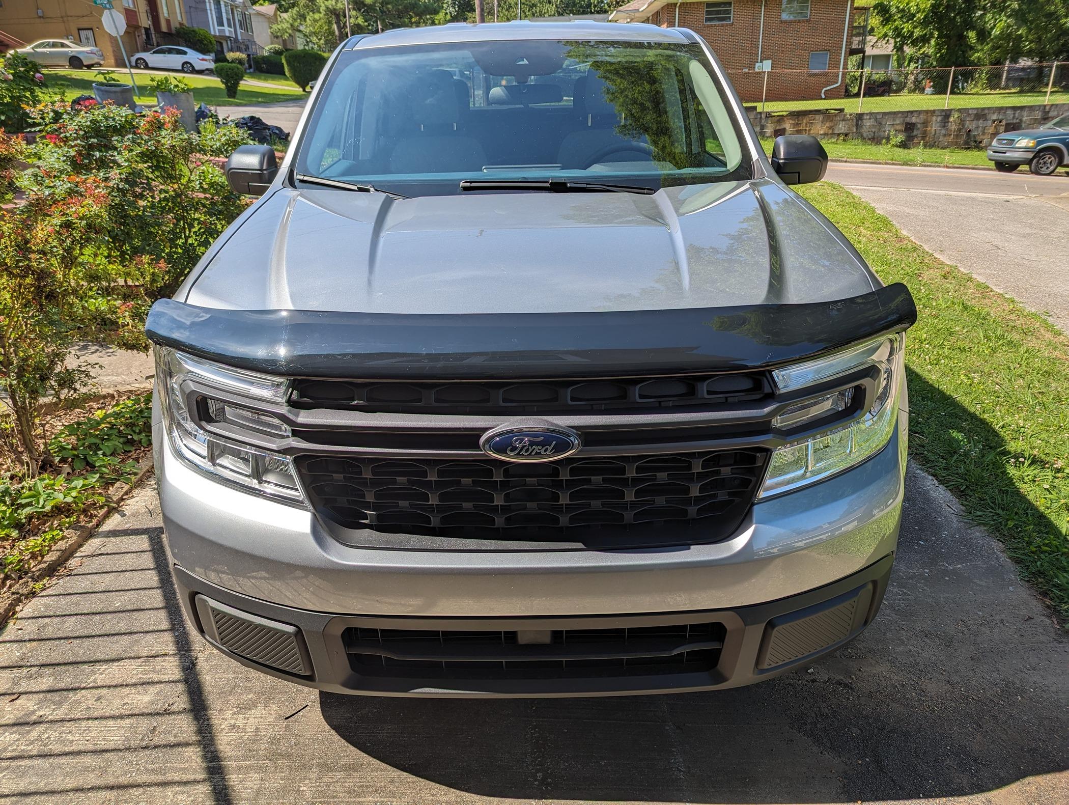

Just installed one on my Maverick and ran into the same issues as mentioned in the thread above. I also took a dremel to the section that was catching then sanded it smooth.

The @Realtruck AVS® Bugflector® II Bug Shield seems to be fairly controversial, but I decided to give it a shot anyway. Here's my experience.
The quality and appearance of the deflector itself is pretty good and it's pretty affordable ($79.99 before $15 rebate). My hardware holes matched up perfectly with the holes in my hood. The main complaint I've seen from early adopters was that the holes didn't match. The provided hardware seemed to work fine. I'd seen complaints about the quality of the hardware, too.
My problems started when I shut and opened my hood after installation. I hadn't seen this mentioned anywhere previously, but my deflector scraped the leading corners of both of my fender panels when I closed my hood. To get the hood open, I had to scrape both corners, again.
I had adjusted the hood bumpers, as the instructions say, but I don't think this could have been prevented, even if I had raised them a lot. The only way I could see to get the clearance I needed was to remove some material from the deflector with a Dremel. This was easy and it works fine, now, but it really shouldn't have been necessary. I would have been much happier if this had been part of the instructions and I could have saved my paint.

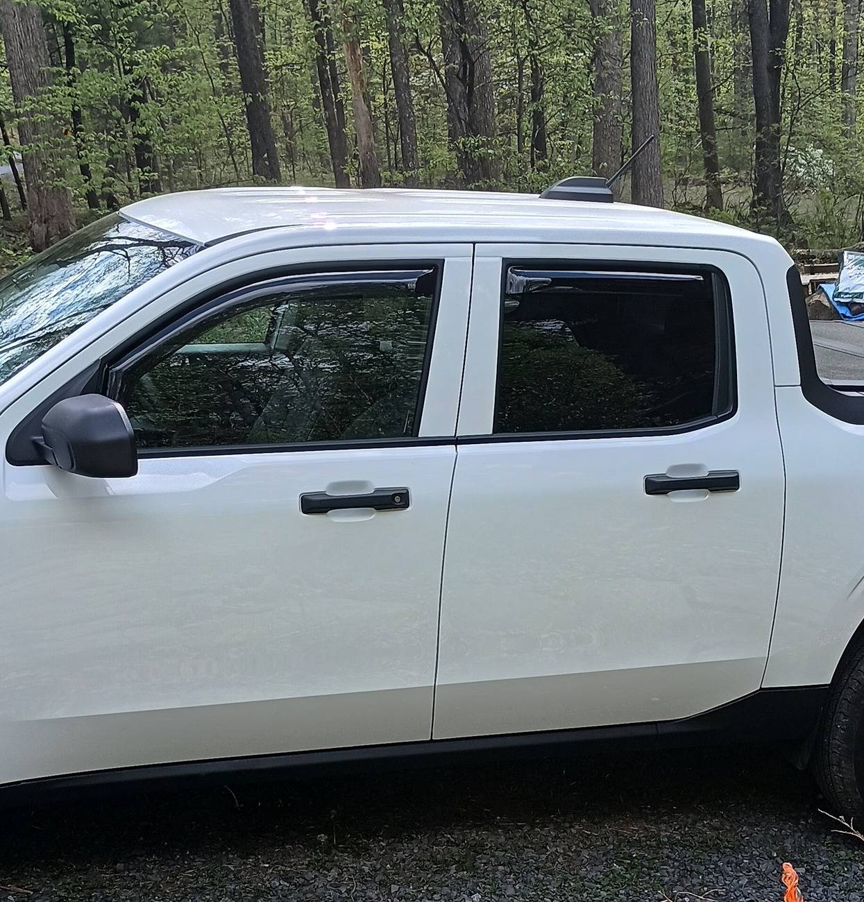

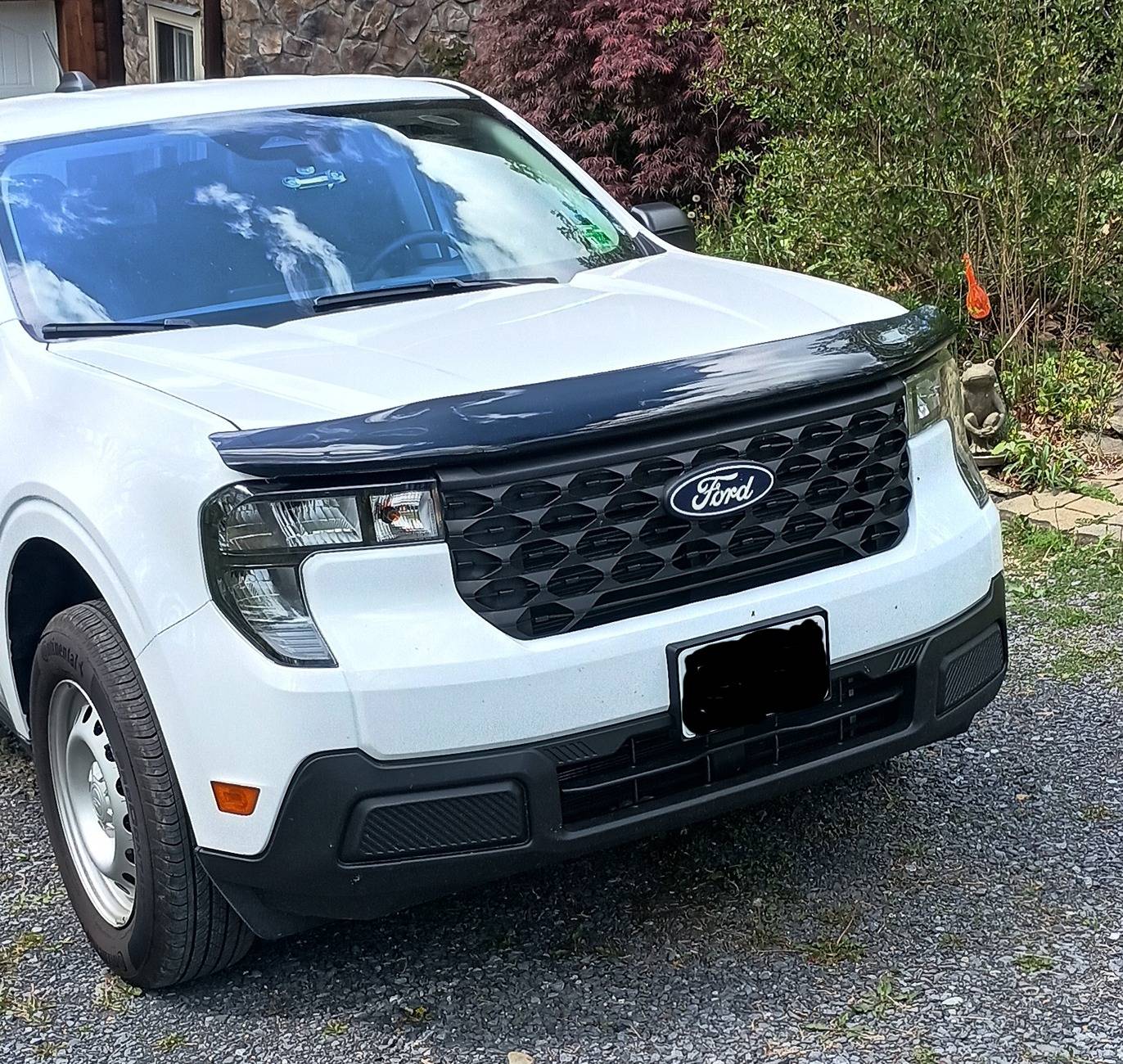

So I'm posting because I wanted to put a deflector on the hood and guards on the windows. The truck doesn't do so great with the windows cracked when going at any real speed. I went with the EGR 573591 in-Channel Window Visors Front and Rear, Dark Smoke Finish off Amazon and the Auto Ventshade (AVS) Smoke Bug Deflector 25980. Installed both without any issues. No edges on the fender/headlight as reported for early models.
Also had the back sprayed with Linex bed liner after purchase and bought a fiberglass 3-piece folding hard tonneau (XTWEEX) off Amazon. The tonneau is solid enough to stand on. Happy with all add-ons. Visor and hood guard photos attached. I put the window guards on late today. Will test them tomorrow. Expecting them to help with wind wub-wub when the windows are cracked open. In most vehicles I've owned opening the right front and left rear windows or left front and right rear stops the wub-wub of the air. Not so much with my Maverick so looking forward to the test tomorrow. Sorry for the lenghty post. Loving the truck. Averaging 38+ / gal.
