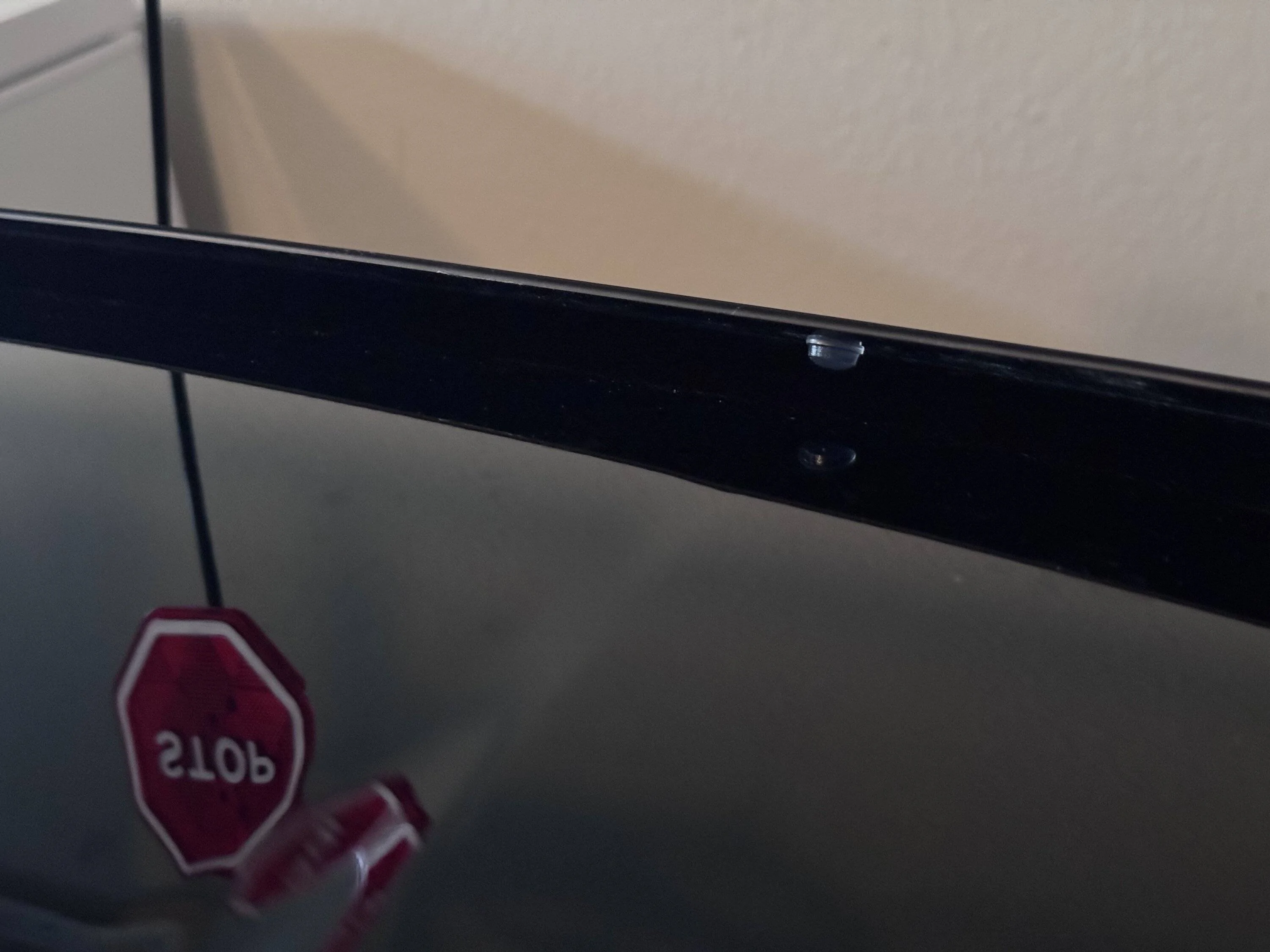

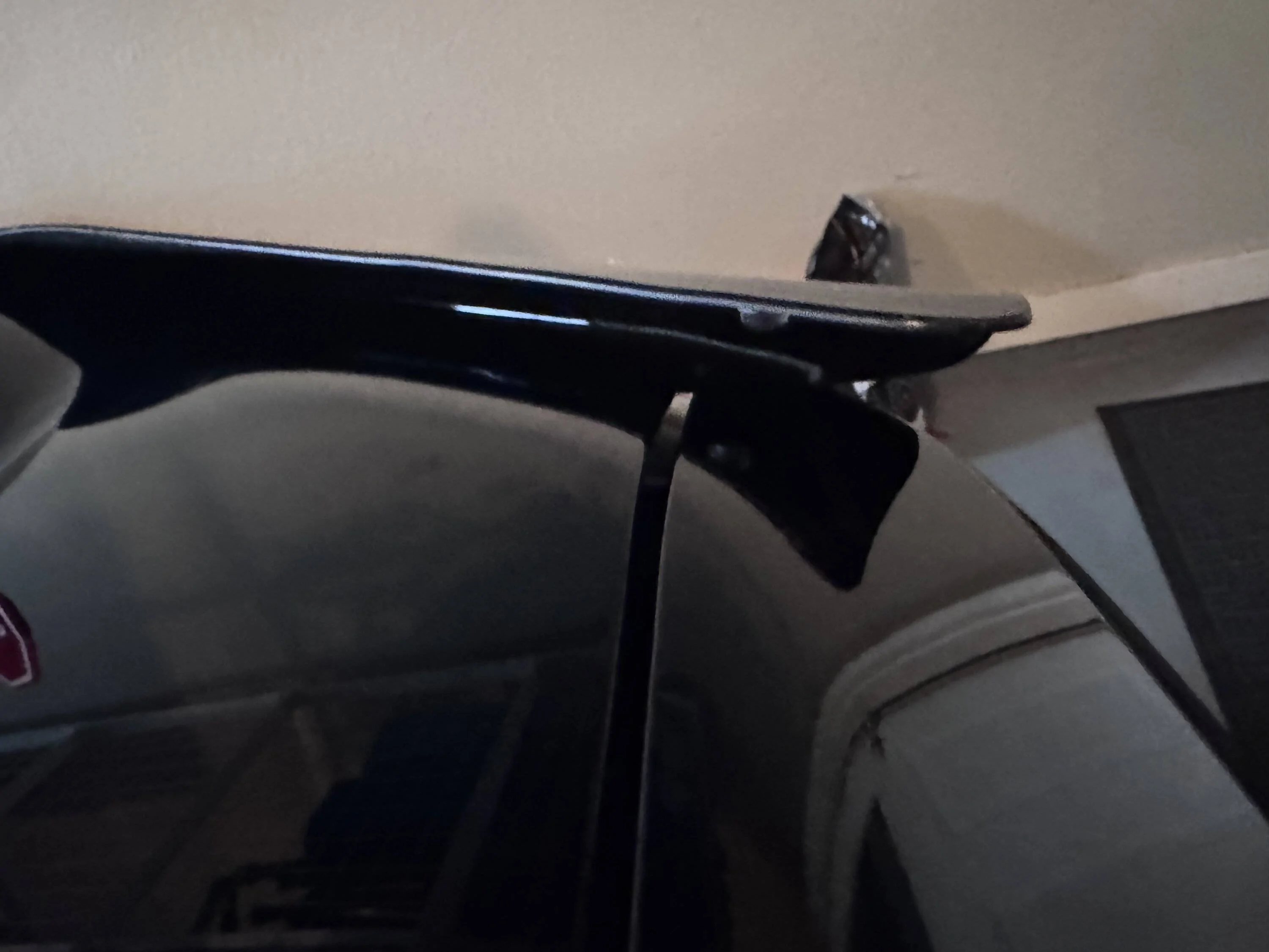

Hello all!
Wanted to give an honest review of the AVS Bugflector II I just installed on my Mav. I’ve seen some reviews both here and on YT and figured I’d chime in also. First, the install was a breeze, maybe 5 minutes. That said, there were no instructions installed and the QR code was useless. But I’m not totally inept and somewhat mechanically inclined. I would recommend holding the bug flector in place before removing any of the seal clips. I had a slight panic attack when I just dove in thinking I removed one incorrectly. Turns out I didn’t but after a mock up, the other 3 were easily identified. You can expect to destroy the OE clips when removing them. I assume replacements are available should I remove the shield layer down the road. Now I have noticed there seems to be a first generation and appears a second of the shields. I say that because some videos show the end cuts being slotted. All 4 of mine were circular. They all lined up perfectly to the hood. All 3 went in relatively easily with a Phillips head. The fourth took some coaxing but it went in once it caught traction. I’ve seen some that took double sided tape to secure the seal once they installed. I’m going to hold off on that for now as I don’t believe it is needed because the stripping doesn’t dangle down. I installed the bump stops on the shield because I don’t care to put tape onto my paint. Use your best judgement but mine were on the ends and then lined up to the hood lines. No issues with rubbing anywhere. Hood opened and closed as normal. No Dremel necessary. Hopefully it will keep some of the bugs off the glass as they have in my past vehicles.

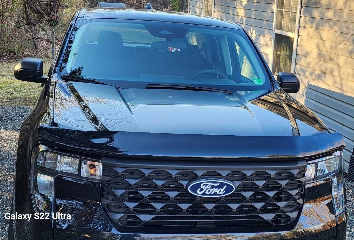

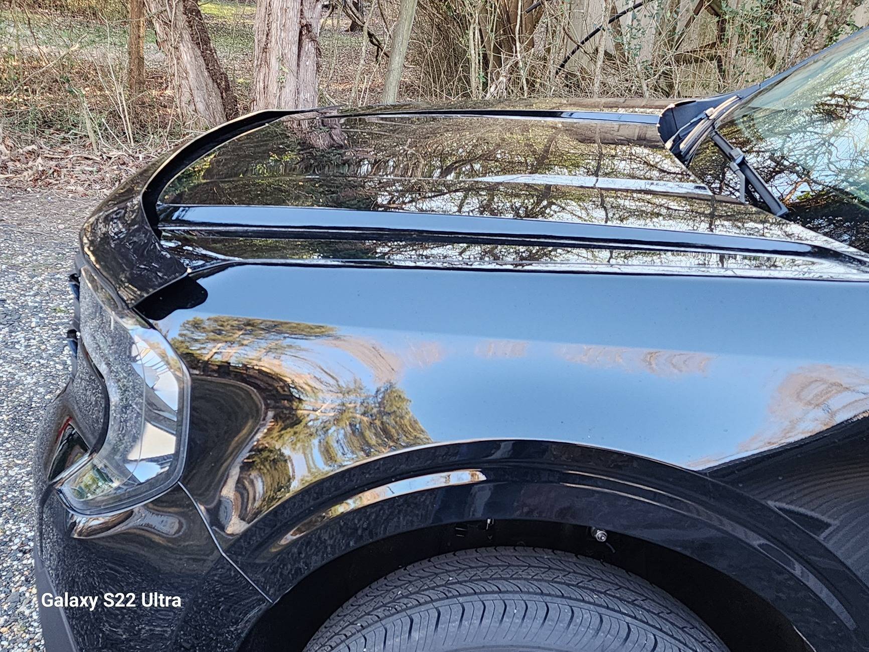

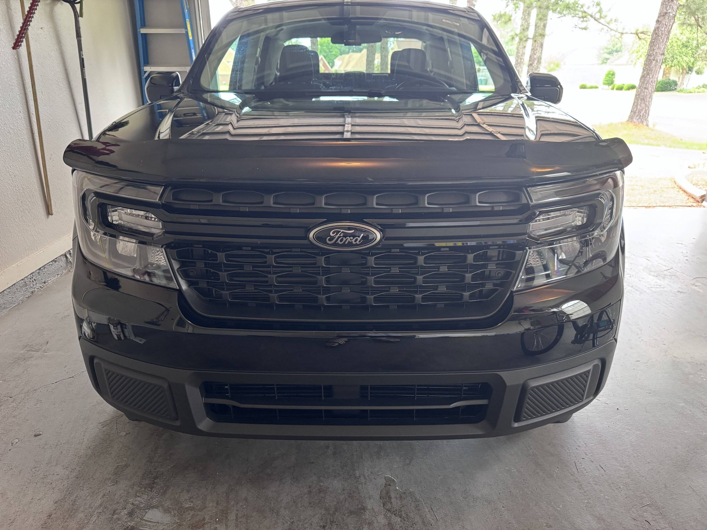

I have the AVS II as well and it's better than those 3m tape/glued on a hood deflectors.

Curious what makes you say it's better than the 3m attached ones?

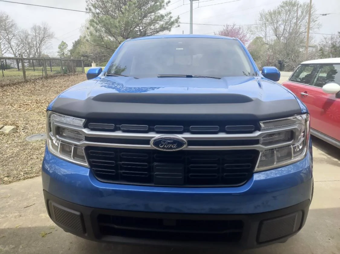

I've had mine on 3 years with no issues. It actually deflects wind, therefore debris over the windshield.
I had one similar to yours on my Sport Trac for around 10 years. The paint was rough under there when I sold it. Not sure if it was due to vibrating against the hood at high speeds or water/debris sitting between it and the hood.

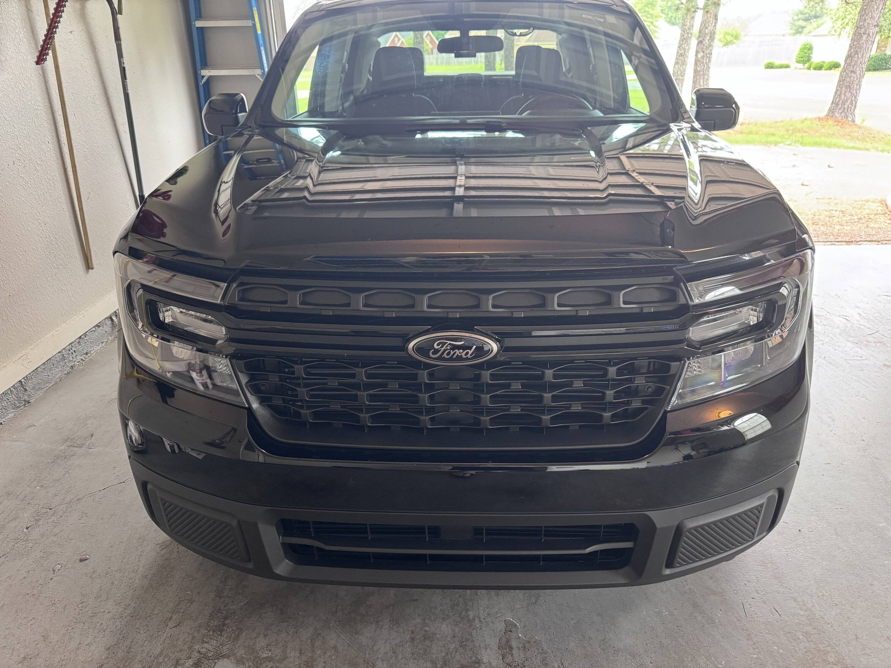

Have bugflector for 3.5 years and no problems . glad to see newer ones line up well . I had minor modifications with 2 center holes .

Because I can take it off if I wanted to without the issues of it being taped down on the hood in the heat. Just as you were stating about the screw on one in your sport trac, if you have ever tried to get a 3m/glued one off after awhile it can mess up the portions where the sticky is. 3 friends in our race group went through it and I learned my lesson, again, from them. 1 was a modified 2023 maverick with that on it. I had a red sport trac as well and ya gotta admit the paint on those years was awful after about 5 to 7 years. Mine had screw on as well back then and no issues with the paint under where it was so the sport trac had this great paint line of about an inch or so then it slowly faded and cracked up further on the hood. To each their own and own experiences I guess.

Ah, I don't plan on taking mine off.

Yeah, most people leave them on for however long they have the vehicle. The guys in our racing club do modifications every day it seems like, lol.
