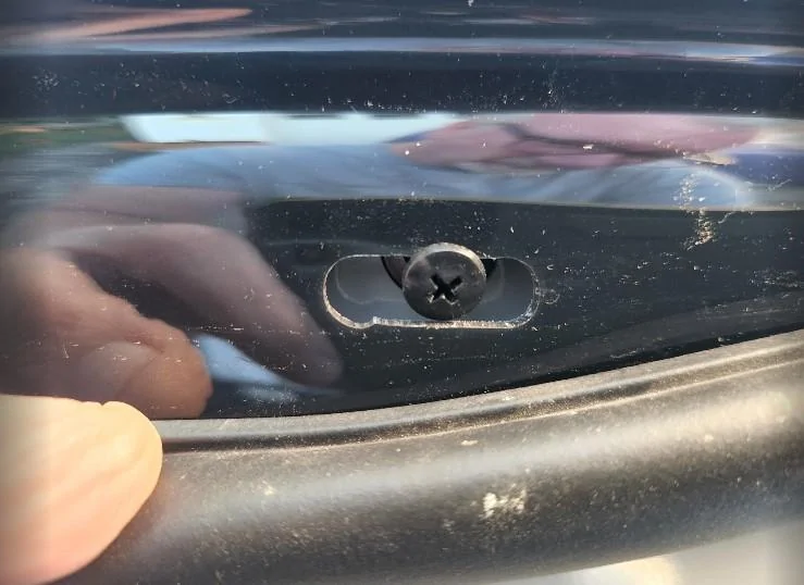

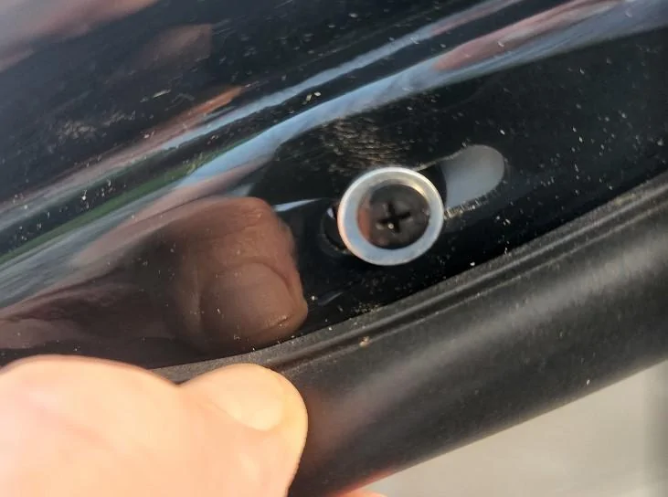

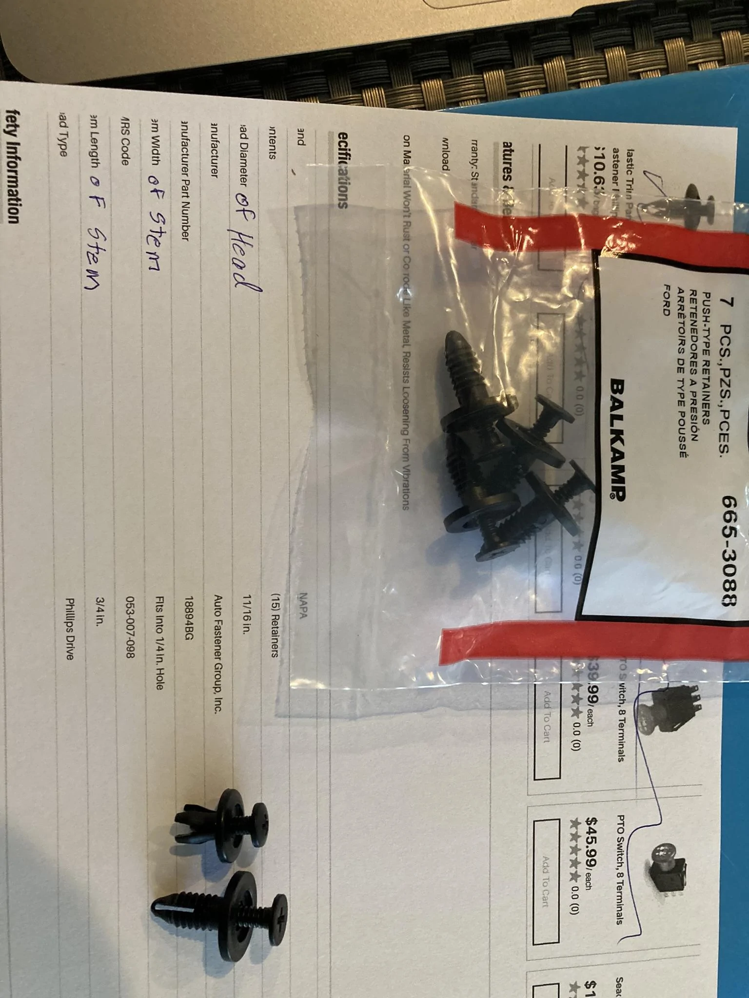

Late addition to this thread. I had same problems mentioned previously, Deflector holes not lining up, crappy anchors and Deflector rubbing on hood and/or fender. I could not find the B196 anchor locally but instead used a Plastic Trim Panel Clip / Fastener Phillips Drive per photo. I managed to muscle the larger clip in just before resorting to drilling another hole. For the rubbing, I also ground a bit of the shield edge but I also placed one of the clear silicone adhesive pads on it to hold it away from the hood. In retrospect, I may have avoided grinding and gotten away with just the spacer. I am definite DIY and hopefully this will help someone!

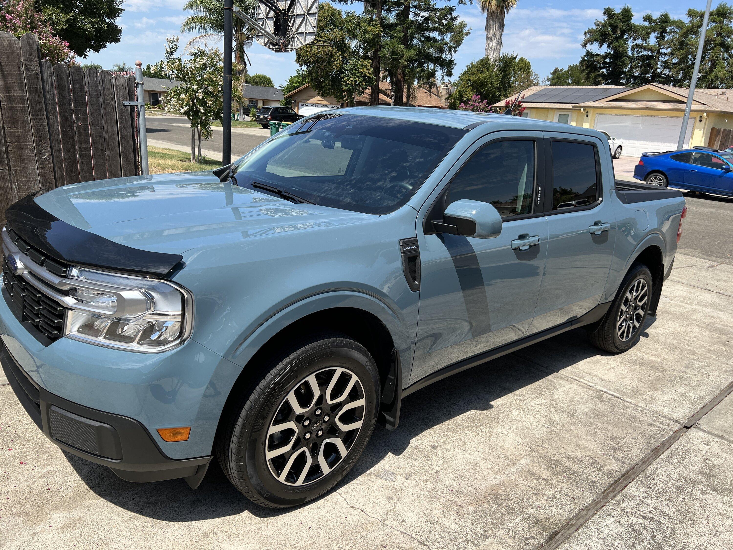

every time I try to follow this bug deflector thread, I seem to get popped out. Someone had said that the Ford one by LUND “the Aeroskin Smoked Hood Protector” was gone. That’s what I have. It was 1-28-22, that I got mine. I am very happy with it.
might have been part #VNZ6Z-16C900-A
It’s smooth and shinny. This is the best picture I’ve got, it lays flat on the hood. No bumpers or screws.
