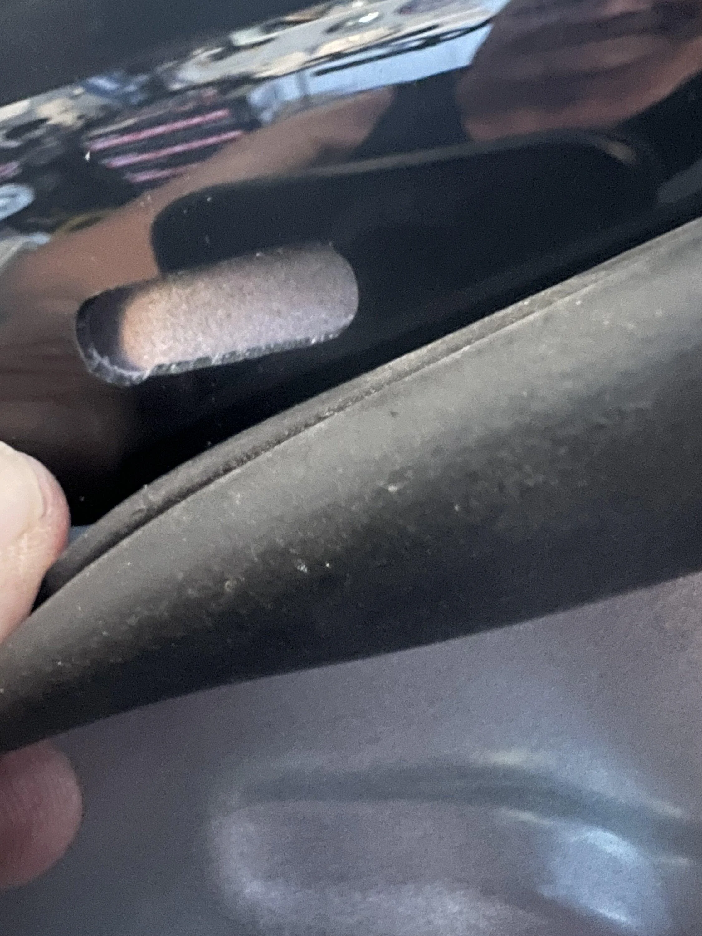

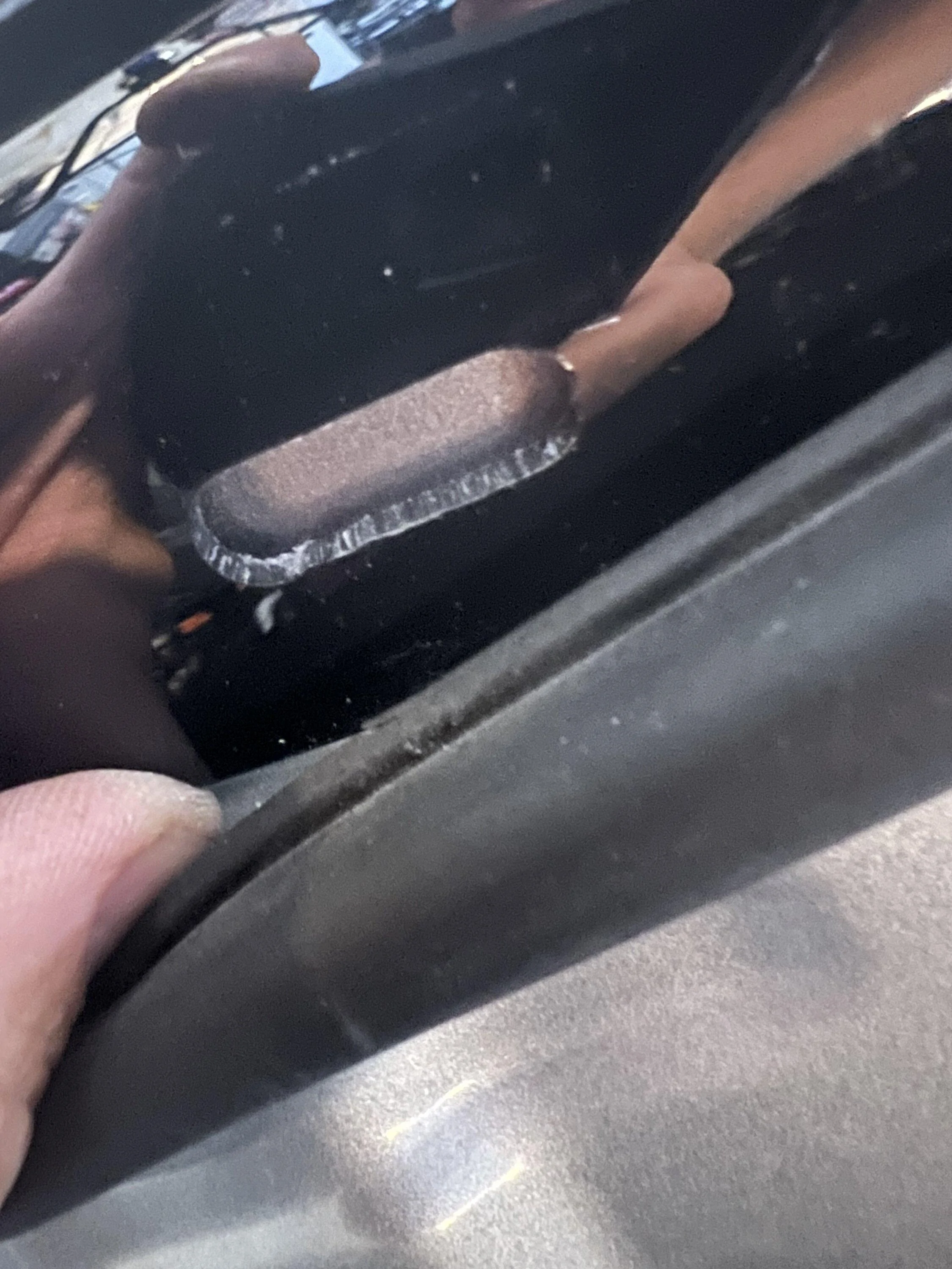

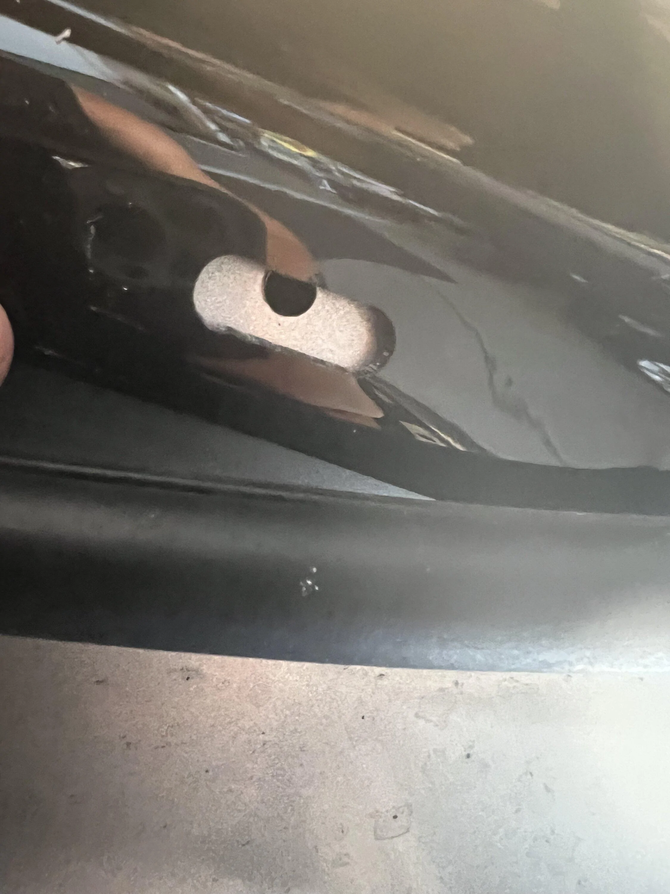

Having the same issue the holes are not drilled in the correct area to use the factory rubber mounting holes - at least 6mm off In the center area You cannot even see the holes to line up. The only way to get it to work would be to frill it out, I’m beyond impressed with this item.
I drilled all four holes and nailed down the fasteners. I emailed the company, waited for a week and called to follow up. A replacement was delivered within a week after the call.

They told me to field destroy it and I’ll get a refund in a couple of days.
