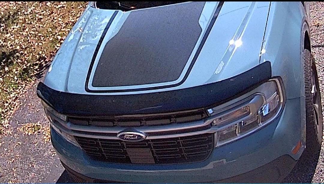

Mine didn't align on one of the holes, it was one of the two middle positions so I just didn't connect it. Seems solid anyway, but kind of sucks it wasn't a perfect fit.
Pic attached.
It does seem to overhang about an inch on each side but that seems normal.

Yea . I had to drill out both center flanges to make mine fit . used a portable drill with small bit first then enlarged and reamed with larger bit . others have had to do some modifications as well . some seem to fit without mods . it seems it is the only bugflector that doesn't use tape .

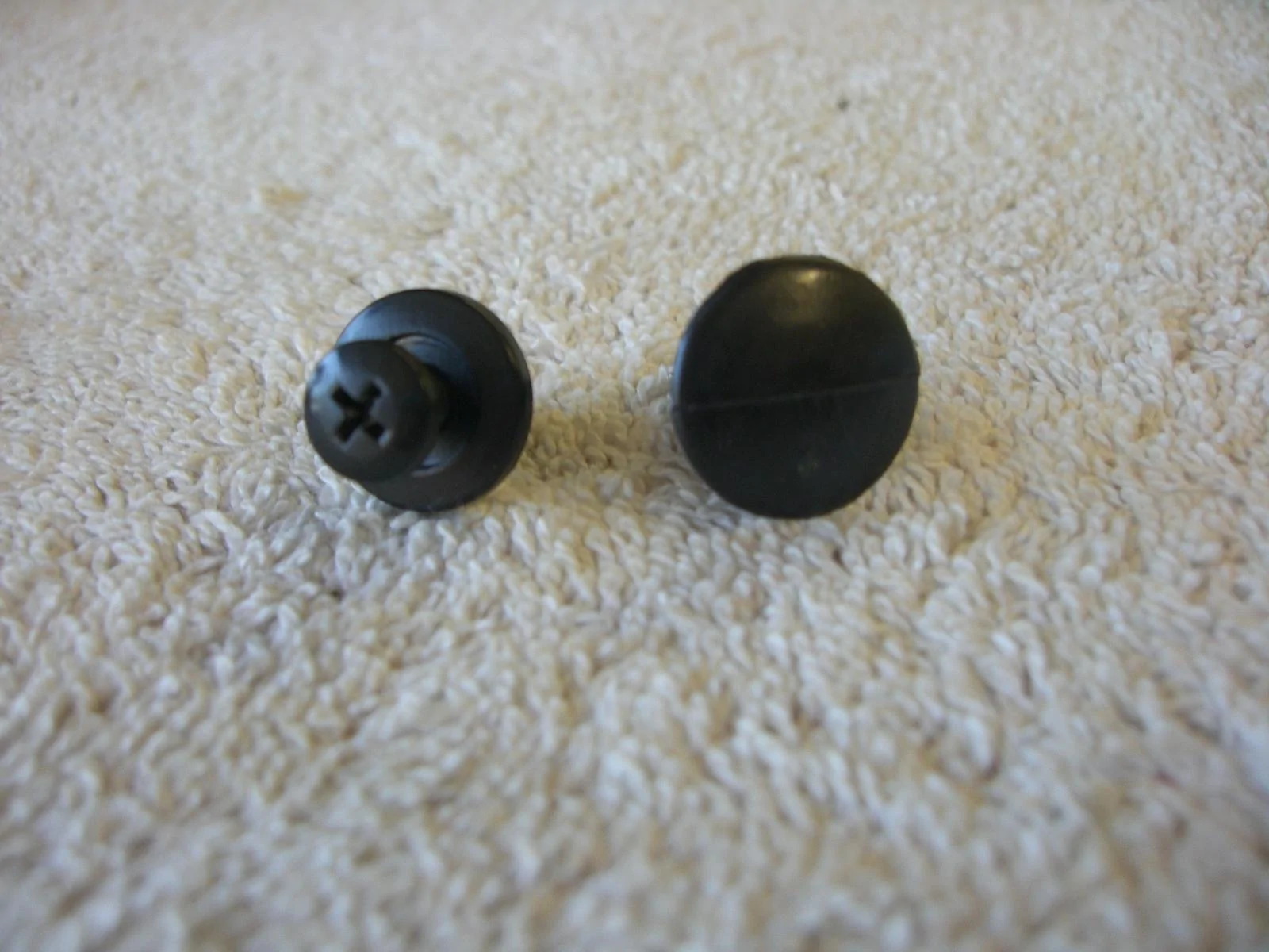

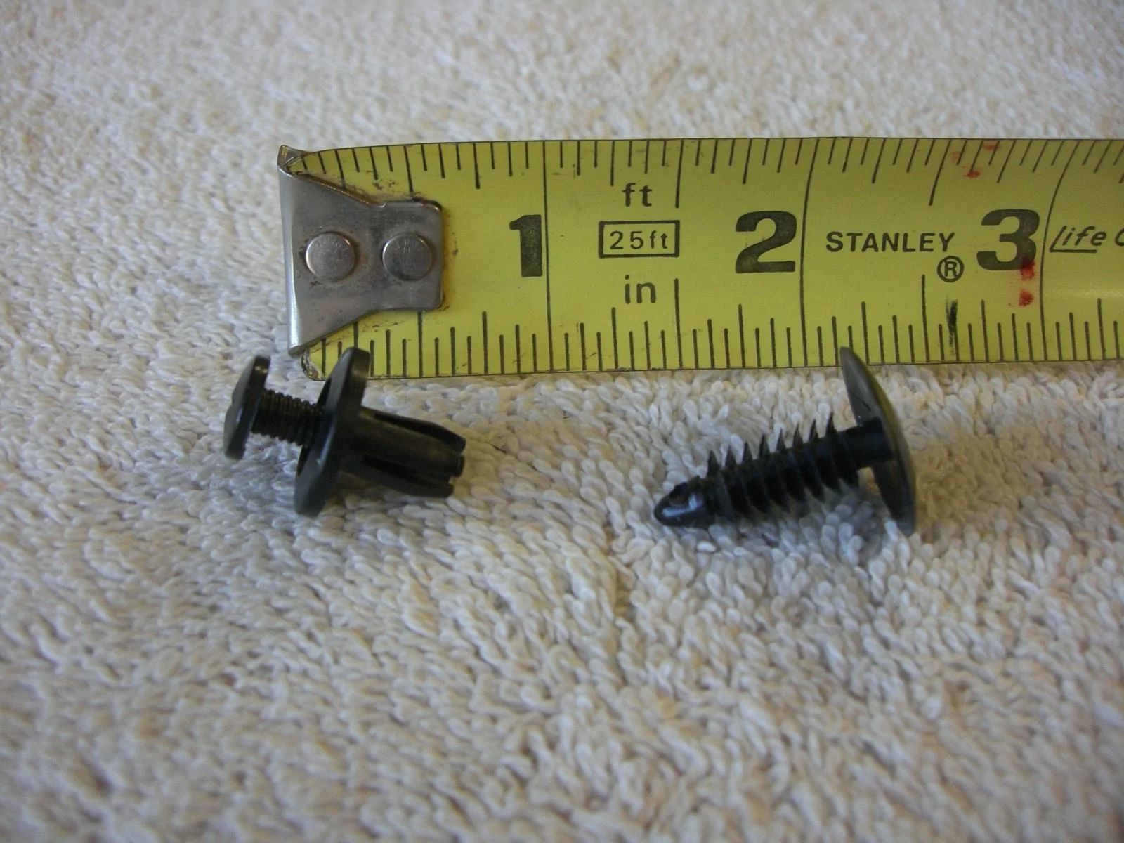

Had a similar problem with my AVS Bug Shield I installed today. The attaching pins were too short and the diameter was too small. They wouldnt go through the Shield and into the Hood. Trashed them and used 4 Push Pins I had left from another project, button head about 1/2" head diameter and longer and thicker than the junk that came with the kit. They worked perfectly.

Image on the Left is what came in the Kit, image on the Right is the Push Pin I used.
Ford Maverick AVS Bugflector II Installation Problem. Am I missing something here? CIMG8135
Ford Maverick AVS Bugflector II Installation Problem. Am I missing something here? CIMG8137

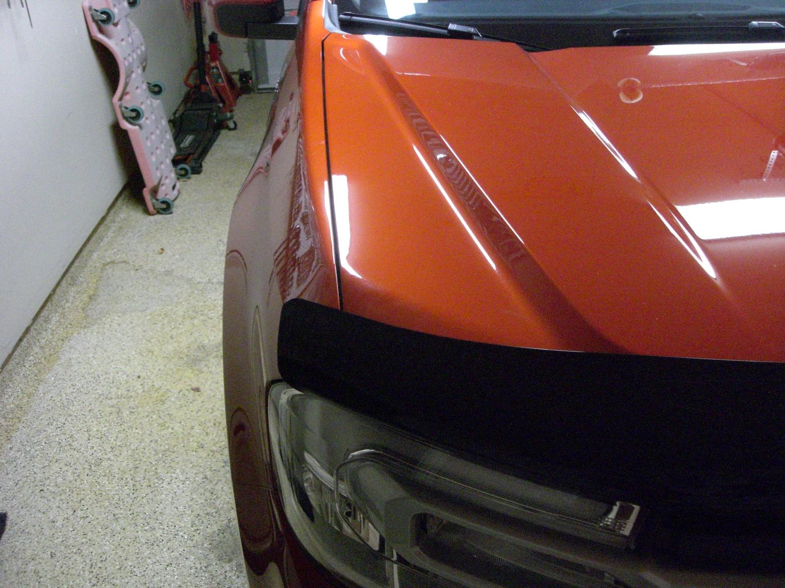

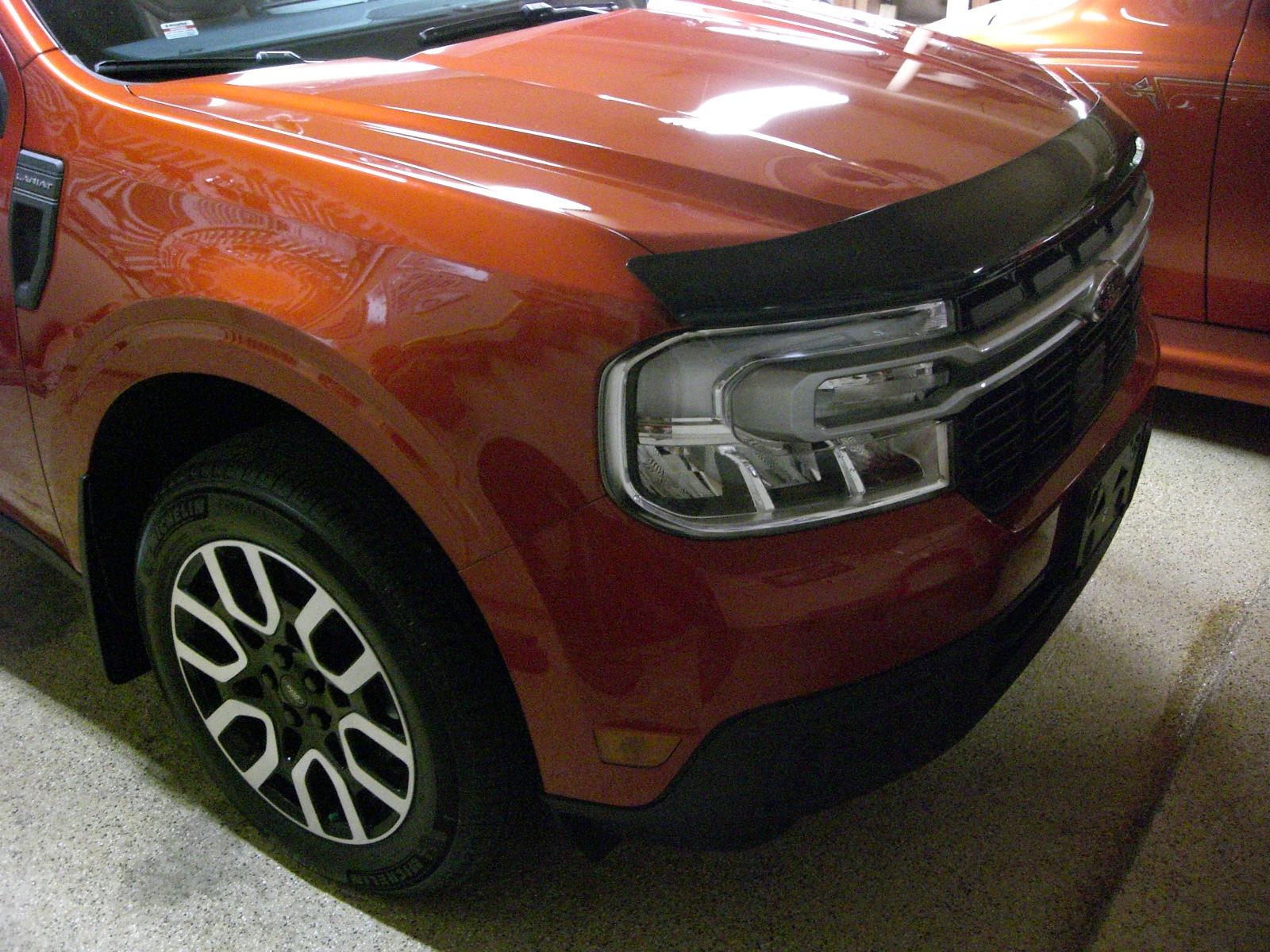

Can you show us a picture of it installed from the side of the truck, and another showing a mounting point with the hood opened?

Here you go TAKK.
I like that it overlaps over the tops of the Fenders a little on each side.

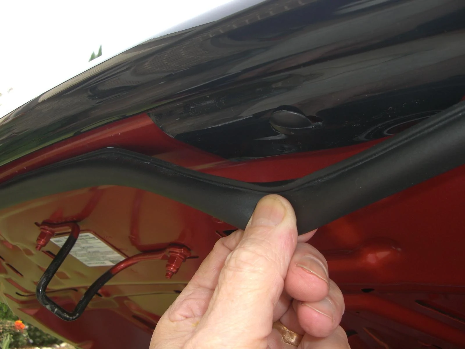

The Bug Shield attaches to the underside of the Hood with 4 new Pins that are installed in pre-drilled slots in the underside of the Hood that are used to secure the center portions of the under hood weatherstrip. Just remove the Weatherstrip Pins (easy) and install the Bug Shield with 4 new Pins then push the weatherstrip back over the tabs of the Bug Shield.
In my first pic, I'm showing you 1 of the 4 locations for the new Pins that attach the Bug Shield to the underside of the Hood.
Ford Maverick AVS Bugflector II Installation Problem. Am I missing something here? CIMG8140
Ford Maverick AVS Bugflector II Installation Problem. Am I missing something here? CIMG8138.JPG

Here you go TAKK.

OCasey, put it on first, you might be surprised and maybe you won't have to drill any holes. The Pins you take out of the Weatherstrip aren't actually pushed into holes, they are pushed into Slots. AND the Bug Shield did not easily line up with the Slots.
I had to physically do some pushing in on the Bug Shield to get it to where it would come close to lining up with the Slots on the Hood and I could push my Push Pins through the Bug Shield and into the slot.. Once I had all 4 Push Pins installed I had about 1/2" of adjustment that I could slide the Bug Shield either Left or Right to make it line up perfectly on the Hood and over the Fenders.
One other thing too, the Installation Kit comes with 4 Clear Rubber Bump Stops that are used to prevent any flexing of the Bug Shield actually onto the Hood to prevent paint damage to the hood.
The Instructions say to stick the Bump Stops onto the Hood. I chose to stick them onto the underside of the Bug Shield as I wanted to be sure that if I ever had to remove them, I wouldn't have to pry them off the painted Hood..

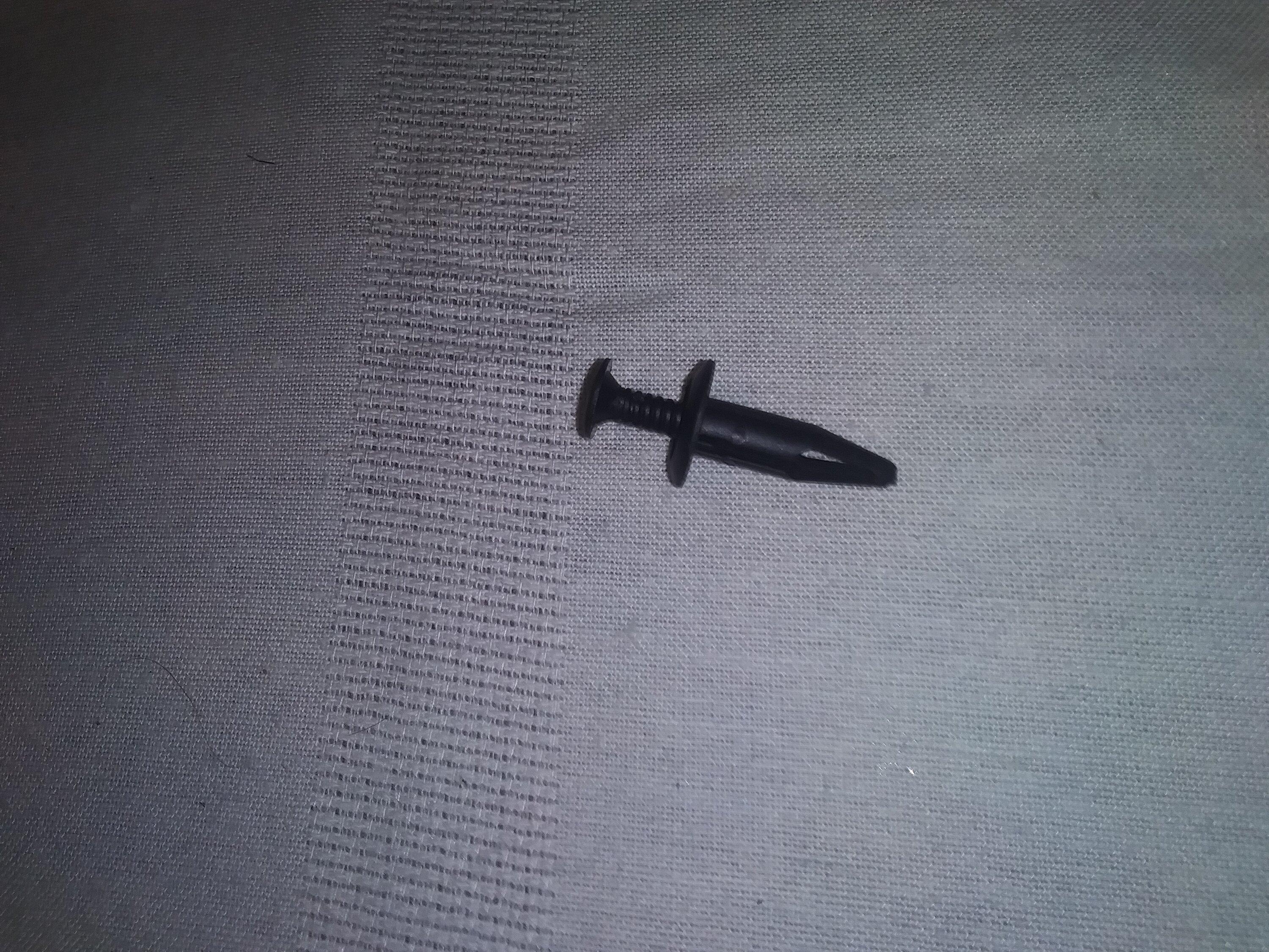

After fighting with the included fasteners for like 20 min I threw them in the trash. They only have like one thread on them. I had one that worked perfect in my extra bin so I took it to autozone and found some that were similar and used those. Worked great.
I did have to drill a new hole in mine though too. Three slots lined up perfect. Last one wasn’t even close.
