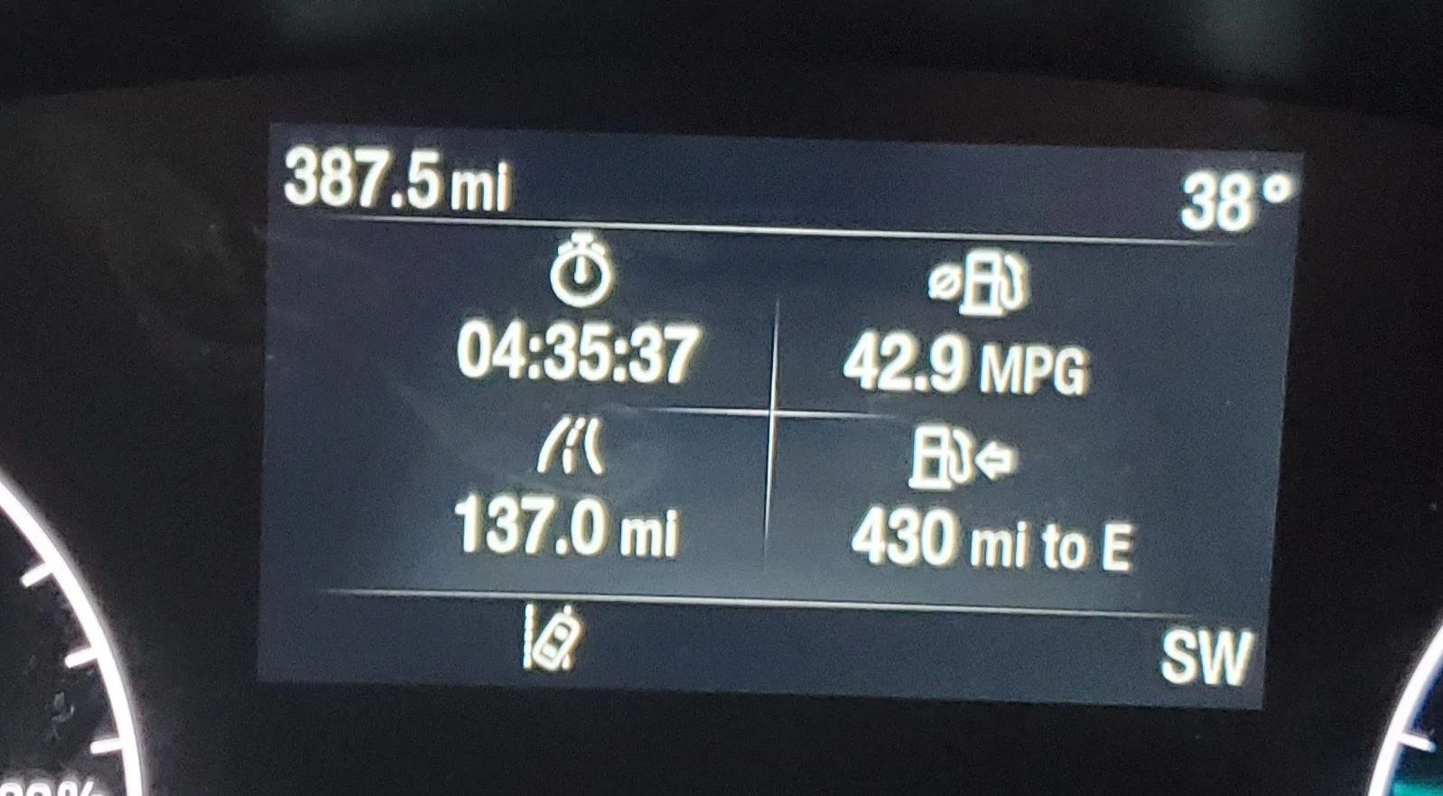

I have taken to driving my hybrid in Sport mode most of the time as it is much more responsive and combines the torque of the ICE and electric motor over 35 MPHour. I am still averaging nearly 40 MPG in Sport and am fine with that. Also, Sport mode eliminates the weird idiosyncrasies of hybrid shutter and grabbing brakes.
peekaypee
Paul
Jul 1, 2021
50
San Diego, CA
Toyota Pickup, Maverick Lariat Hybrid & Tremor
Wow! How do you still get 40mpg in all Sport mode? You must live in an all flat area, while hyper-mile'ng with a strong wind behind pushing you. Ha
