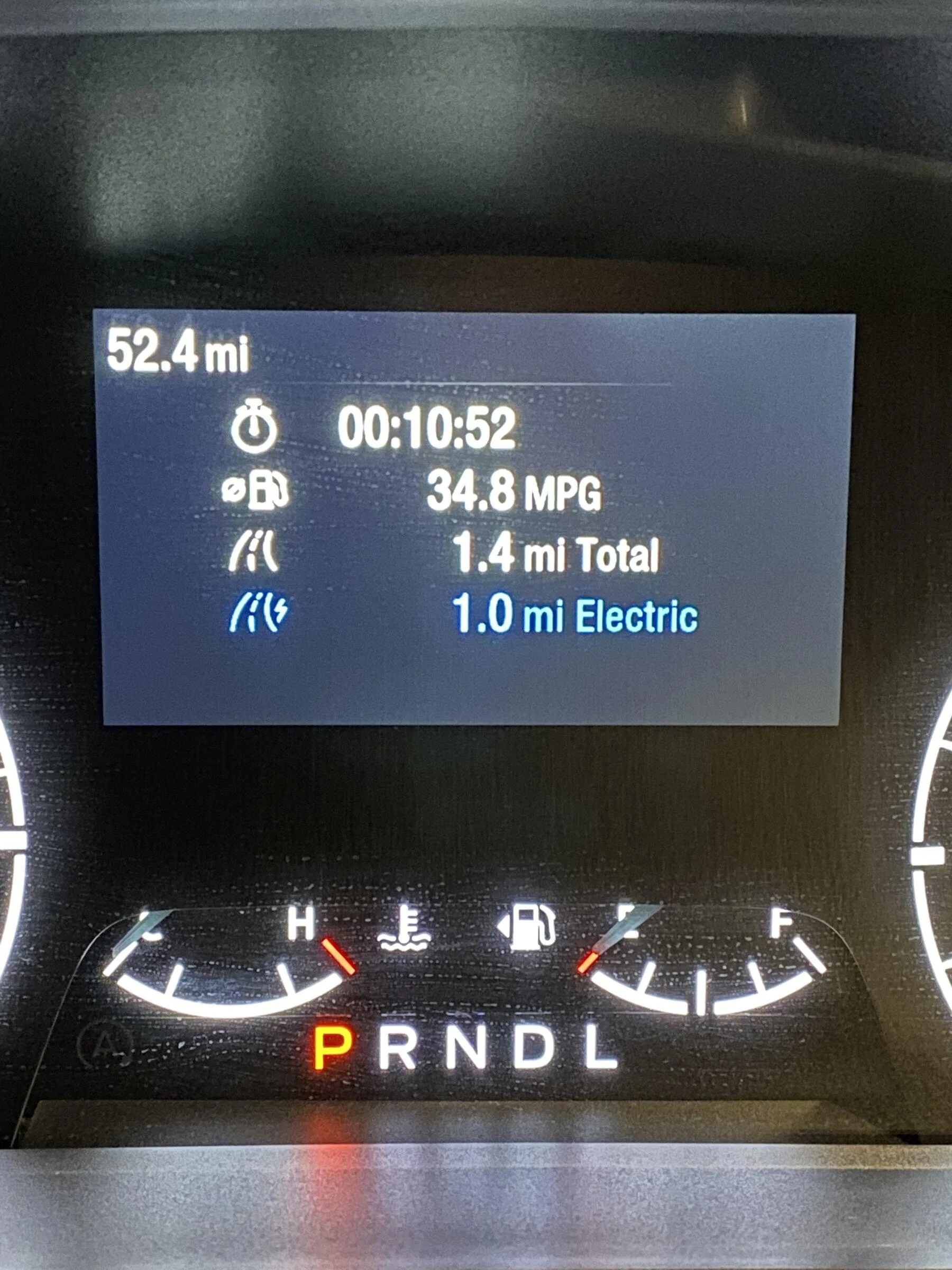

Audit of Ford Maverick instrument mileage display...
This vehicle is 2022 Maverick Lariat hybrid with lux package delivered in March. I have recorded all the fuel added to the vehicle. Each time I fill the tank I record the mileage displayed on the instrument panel and then zero it before driving on the next tank. Results: 6229.2 miles; actual MPG: 39.73; average of all the mileage displayed on the instrument: 41.66.
