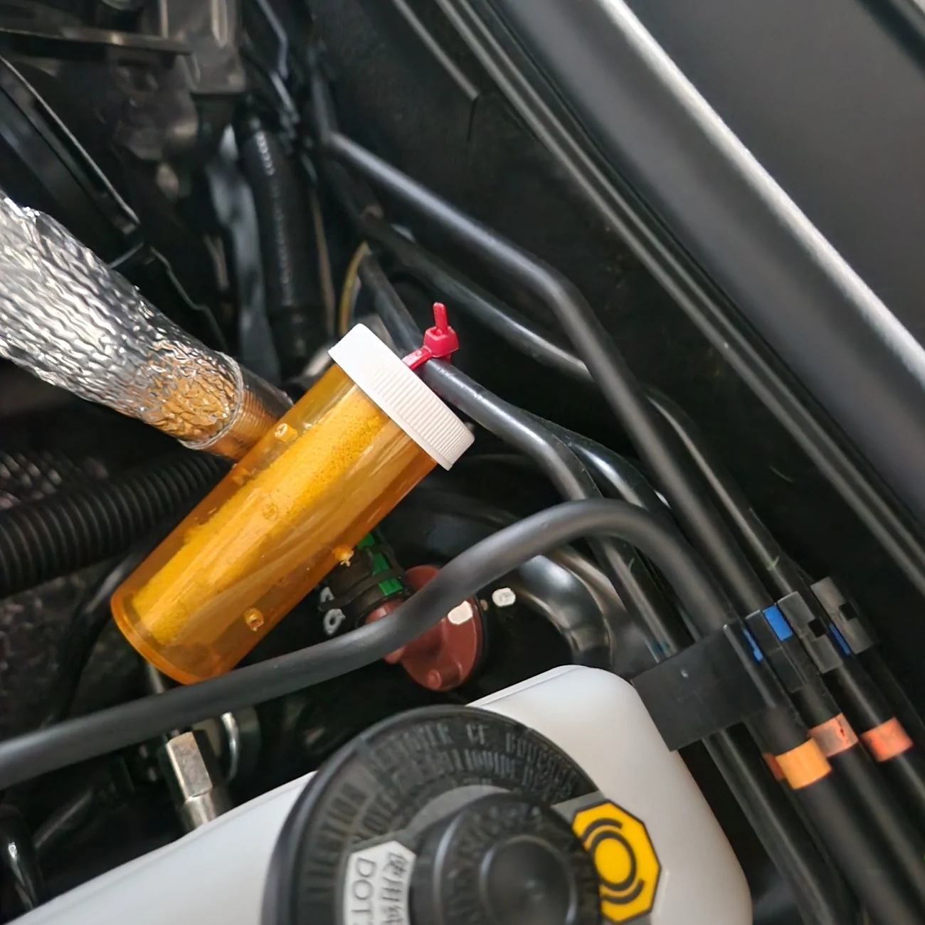

An old prescription bottle, a 1/16" drill bit, a piece of sponge, peppermint extract, and a zip tie are you friend....
Ford Maverick Rat attack! 20251001_173723
I've found this to be the most effective defense against the furry little bastards..
I refresh the peppermint extract every 3 months or so.
I've been doing this on every vehicle we own for years - of course I did learn to do this the hard way after a rodent ate through the engine harness on a company provided F250 that was parked nightly in my driveway, that incident required an ALMOST funny phone call to my supervisor and a tow truck ride to the dealership... Just glad I didn't have to pay that bill, and yes I kept working for that company until my retirement 🙂
