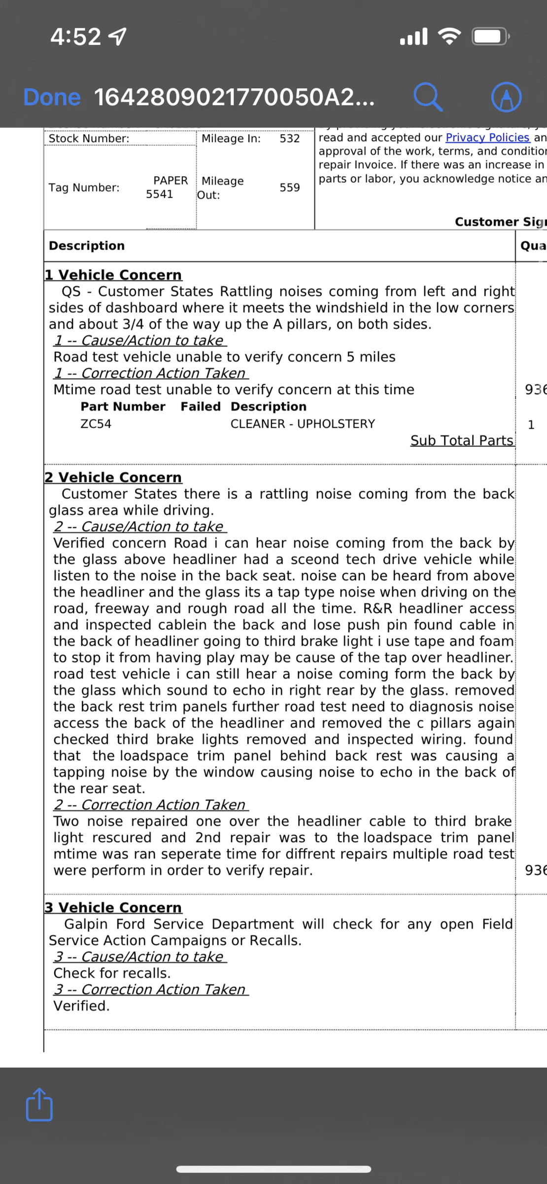

Originally, it only occured on the front right corner of the dash where the window, pillar, and dash meet together but has now spread to the left side and middle also!
And there is a NEW rattle in the backseat just under the rear windshield right in the middle. I've tried adjusting the headrests and checking for loose stuff but couldn't find anything unfortunately. This one isn't as noticeable so you will need to turn the volume up a bit.
