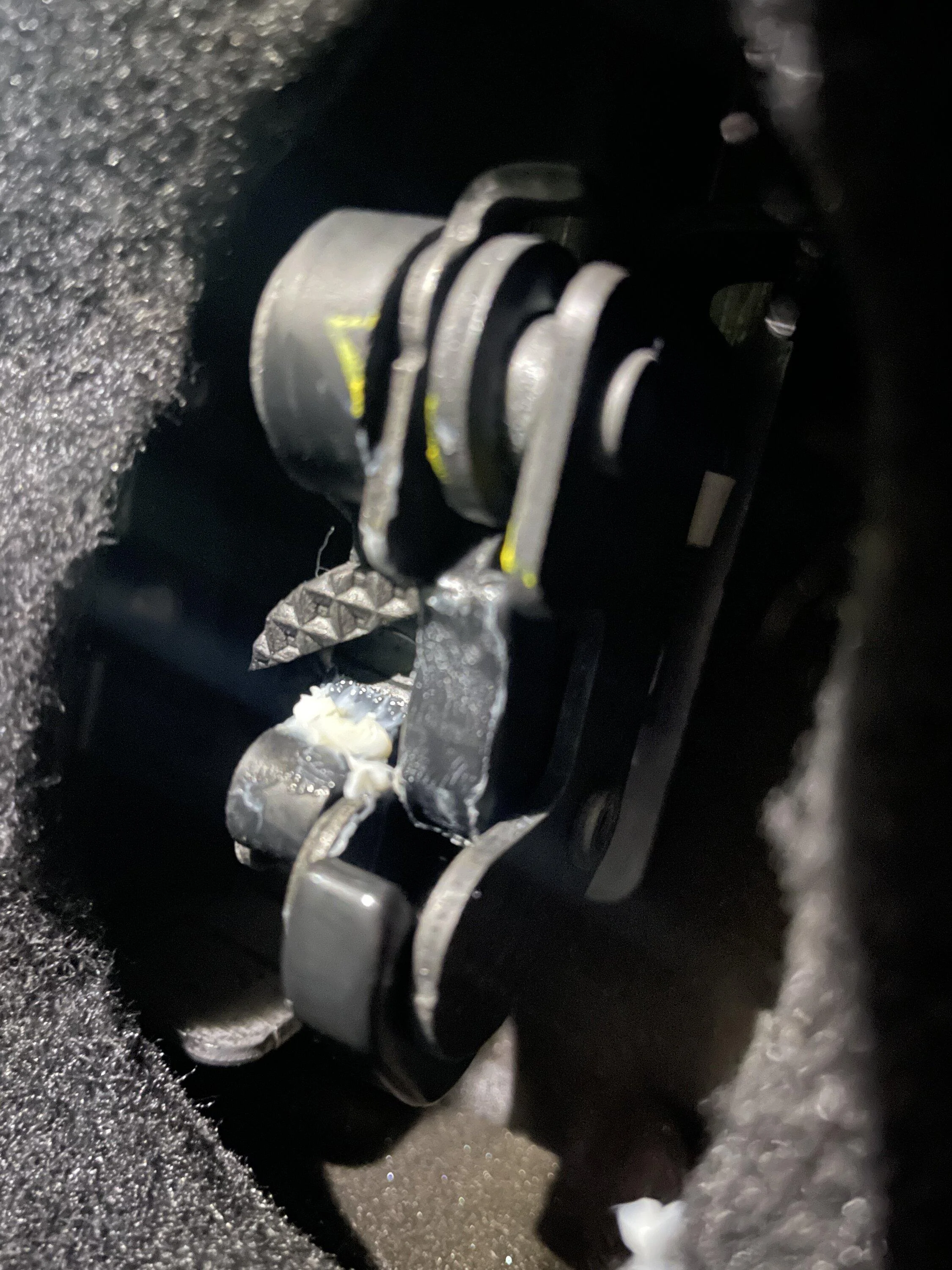

I can the next time I go out to my truck. It’s literally just a piece of black foam with 3M tape on the metal seat latch where they contact each other. You may have different rattling locations.
Can you send me a Pic of it. Just curious

Mine wasn't loose at all - it just didn't latch so was not aligned. The pic above is a good one of the latch mechanism on the back of the rear seat. Mine looks just like it - with grease and in working order.

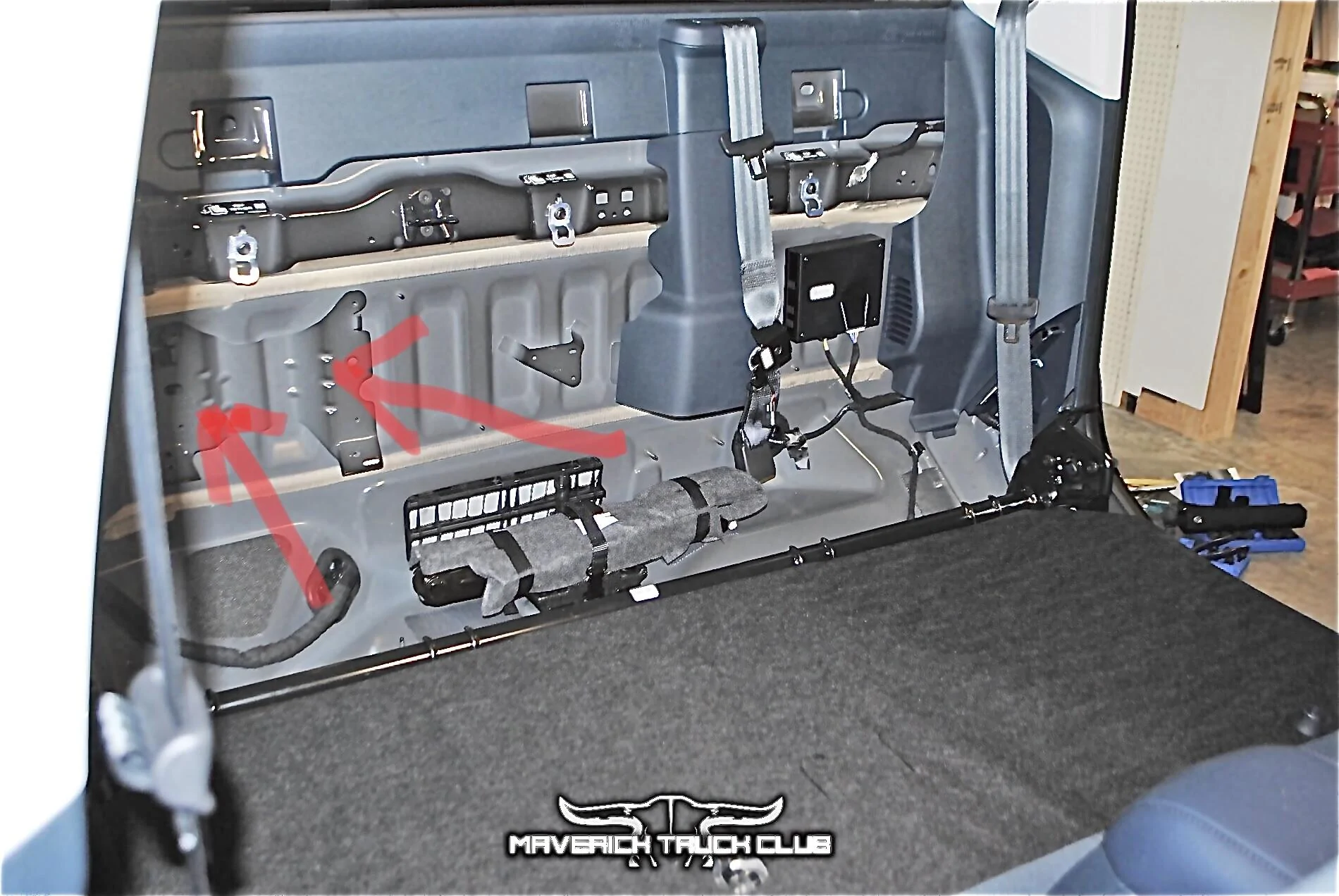

I heard the same thing in my truck and I finally figured it out. See the butterfly shaped bracket in the picture. If you “flip” it with your finger it vibrates like one of those springy door stops little kids like to play with. I squeezed the top o the wings to put a little tension on them and then wrapped electrical tape around them. Did the same thing to the bottom of the wings. Vibration eliminated.

Thanks, NWA, I'll check it out. Something like that would seem to create the type of sound I'm hearing, although I would swear it's coming from the rear passenger area more toward that door, but who knows. I'll post my results here after I check it out.
