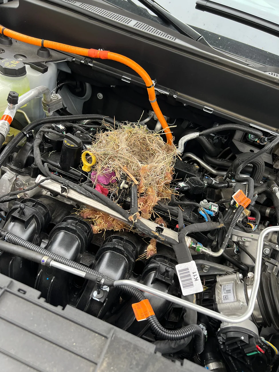

1700 miles on new lariat hybrid. It’s the season for getting ready for winter. Driving last Thursday and running very rough. Get out, lift hood, rats nest. Chewed thru wires on one injector harness. Dealership says 2 connectors and short harness. $695 plus tax! They had to order connector.
After having a mouse problem in my 2024 Lariat, I started leaving the hood up overnight. This seems to prevent the nesting that I was seeing beforehand. I'm not sure if this is a great solution. But it works for me presently.

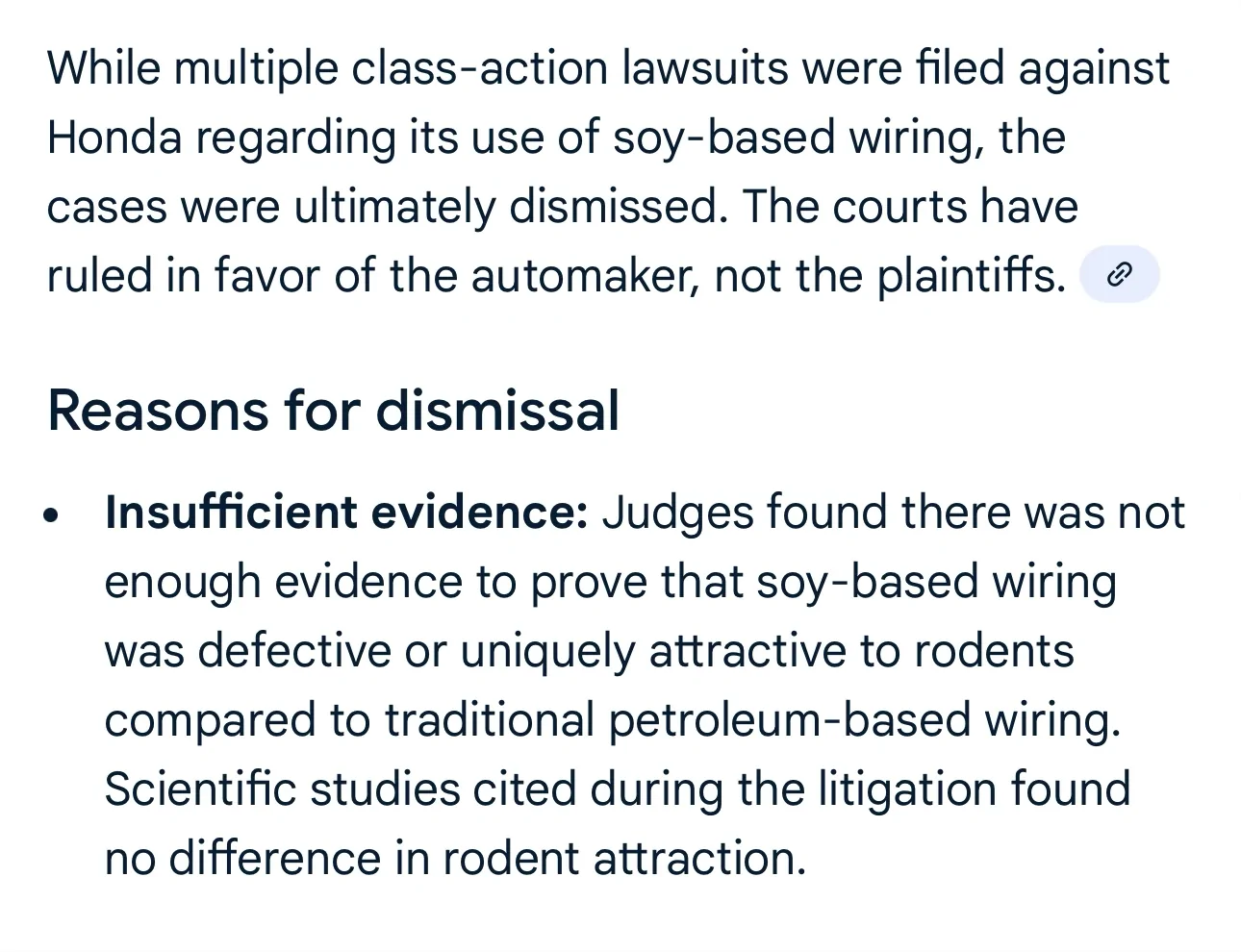

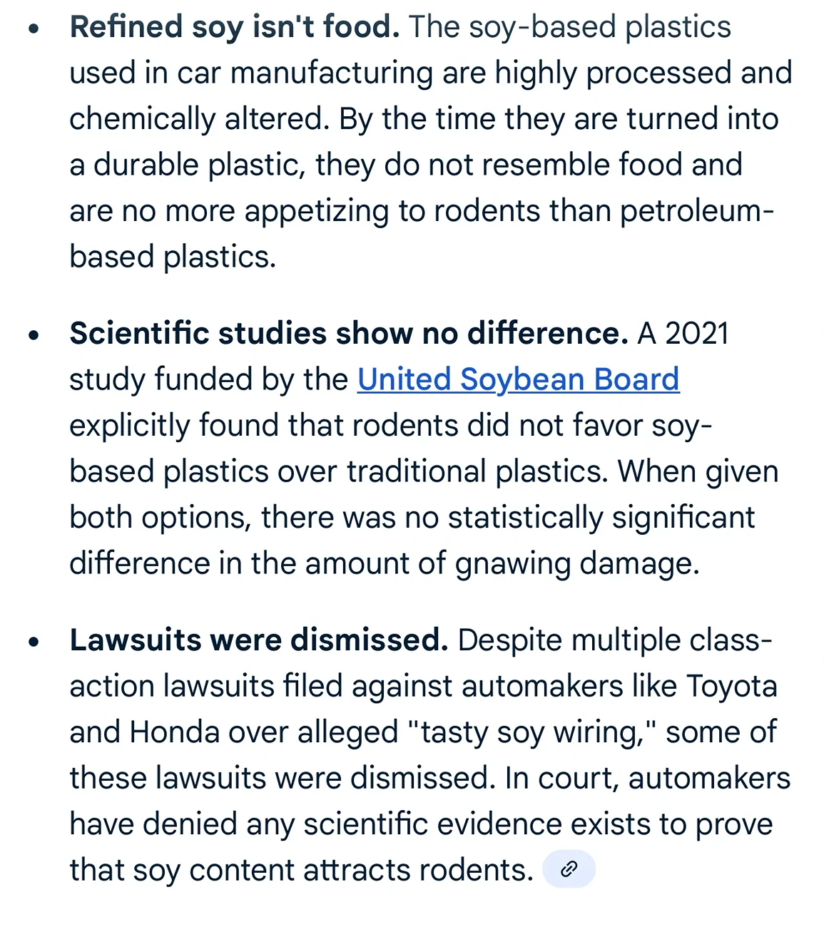

Evidently, the insulation on electrical wires is often made from Soy.
Yes, as in Soybeans. Rodents love it, which really sucks.
Sorry to hear about your perils, man. I’ve had vehicles chewed on as well and it’s often difficult to find all the damaged wires. I have no helpful suggesting to prevent it.
Rodents don’t love soy plastic. They have no preference between plastic made from vegetable oil vs petroleum oil. When you cross link all of the carbons to make plastics, it makes the plastic indigestible and flavorless. Just like when you put a plastic fork or spoon in your mouth. Does it taste like crude oil, gasoline or diesel? Nope, flavorless. Rodents chew on things to keep their teeth ground down. Has nothing to do with flavor. Research has shown this wive’s tale to be false. Class action lawsuits have been thrown out because there is ZERO data that prove the “rats love soy plastic” claim.

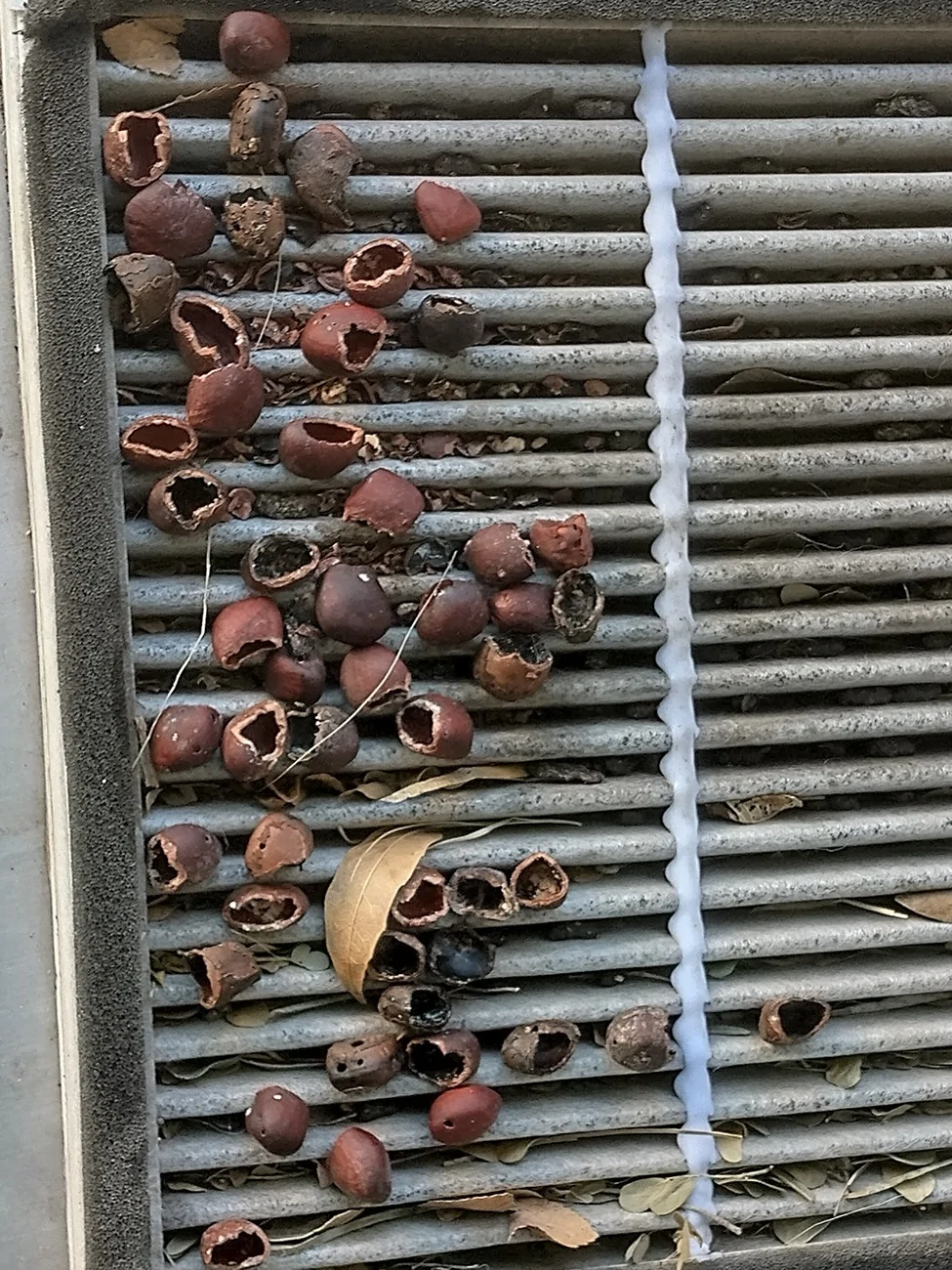

Cabin air filter from my Dodge Grand caravan. I now spray peppermint spray twice a week and haven't had any more trouble. Spraying once a week wasn't enough. One squirt in each wheel well one under under the engine is what I do.
