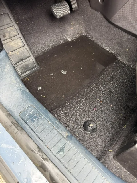

Night before last we had a nearly 2" rain; the next morning there was at least 2 inches of standing water on the floorboard. I drove straight to the dealership and they checked all the drains, said there was "some" tree debris and that may have been what caused the overflow into the cab. Has anyone else experienced this? The rest of the cab is completely dry, including the ceiling.

thats a lot of water. be sure to remove your floor liners and verify the none of the carpet, driver & passenger side got soaked. Prime place for mold to grow and stink :eek: you may want to search the forum for the term water leak and see the various resolutions

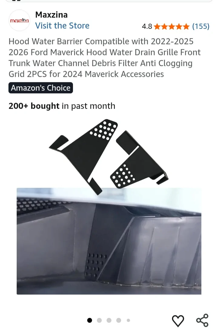

Thanks everyone for all the input and help - I took it back to dealership today so they can pull carpeting/mats and to put in front of industrial fans overnight. I mentioned the above things to look for as well - so much appreciated. I am also purchasing the Maxzina Hood Water barrier mentioned here. I will update after the next big rain!

I bought some knockoff water barriers from Amazon for $15.99 and installed them months ago. So I didn't have a problem in the first place and will never really know if they prevented it, but I sure don't have an accumulation of leaves and other debris that was happening before I put them in. They are pretty light/flimsy feeling, but have done the job and survived snowy, icy winter. I warmed them and did some slight plastic bending by hand th ensure best fit.

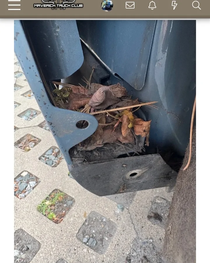

Those debris barriers also help leaves from building up at the bottom of the fenders where the water is supposed to drain. At least according to this picture published by the 3D printed basket thread.
