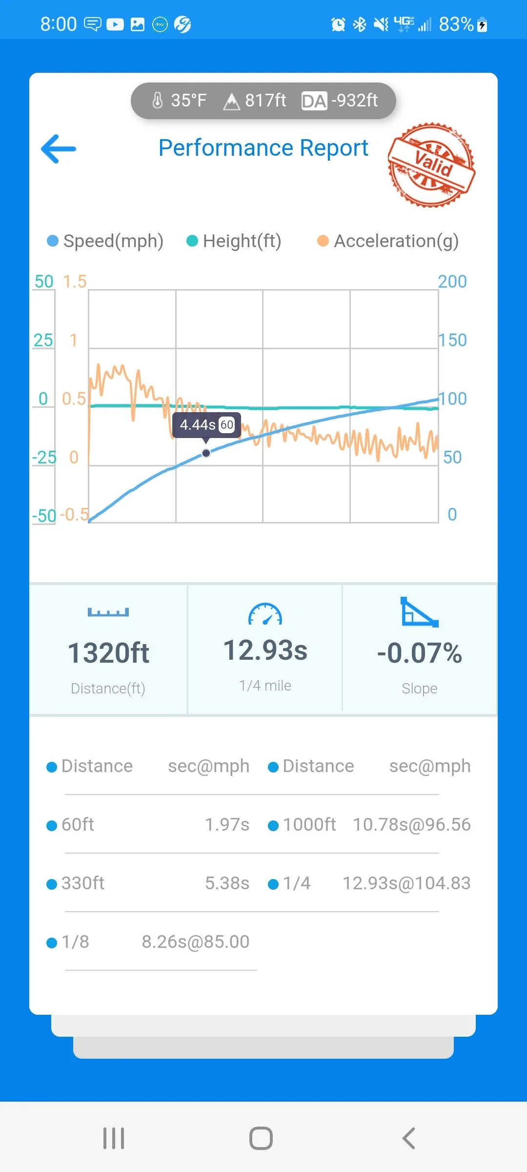

It's been a minute, but I have an update. I have made it to the 12 second club! I ran a 12.99@105, followed up by a 12.96@105. Still 93 octane, with incedible DA, and some good weight loss!
I will be getting my E30 tune soon, so these numbers will only get better! After the E30 tune gets some revisions, I'll order the lines for the Corsair turbo and get that ball rolling as well! That is as close to a bolt on upgraded turbo as we have, and that size turbo has shown to push between 310-330whp on 93 octane, so not bad at all!

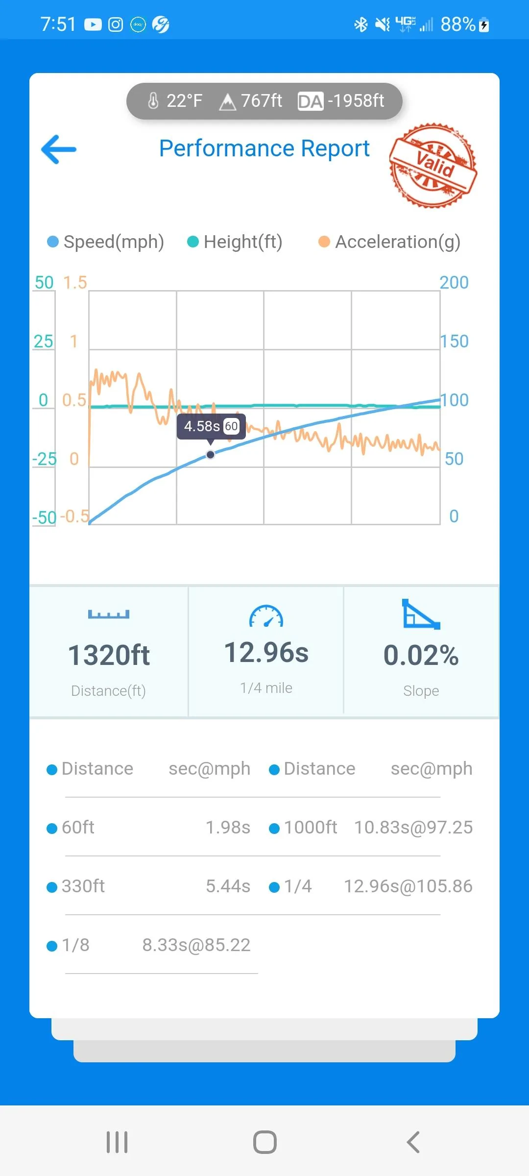

Small December 1st update! I had a chance to do some weight reduction with the E30 tune, and it's progressing pretty nicely! This is the base E30 tune, to go along with my other mods, and QuickRik put down some decent passes!
Newest fastest pass now 12.75@108mph!

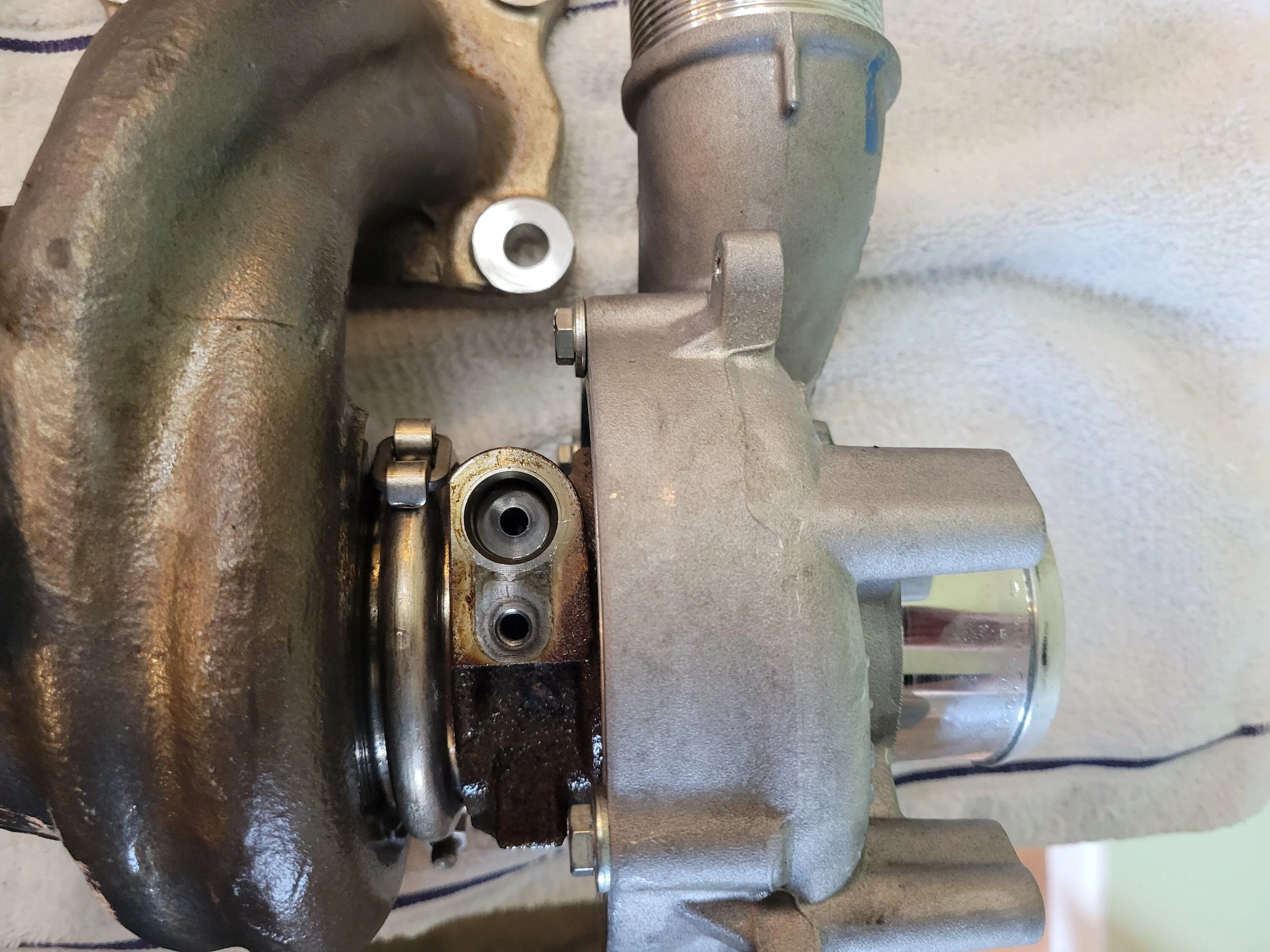

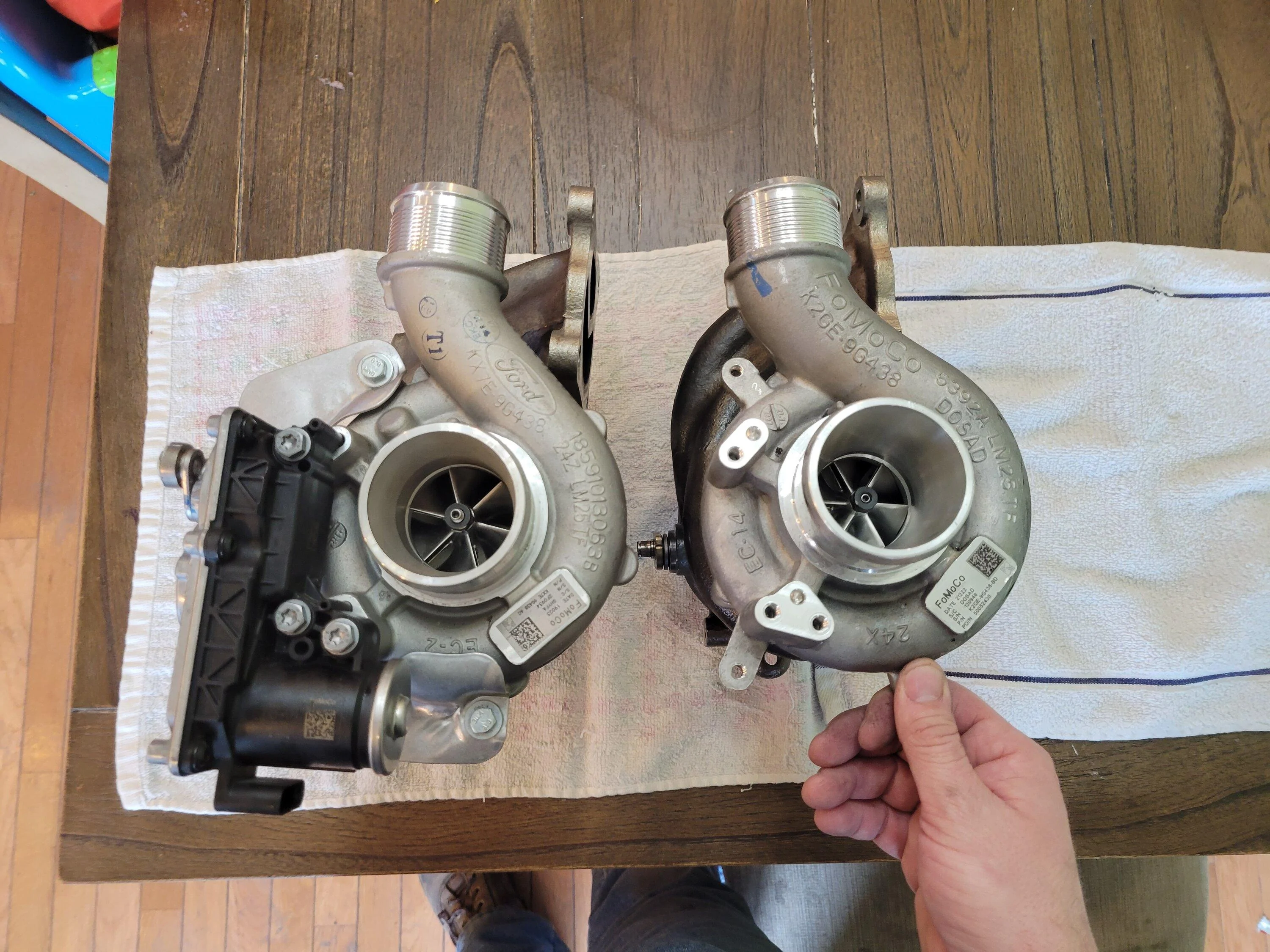

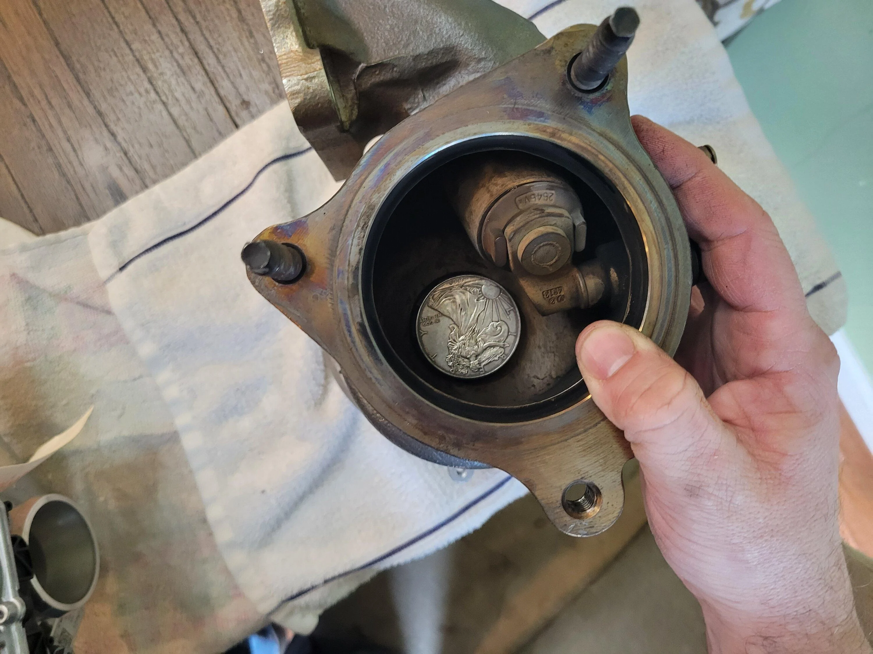

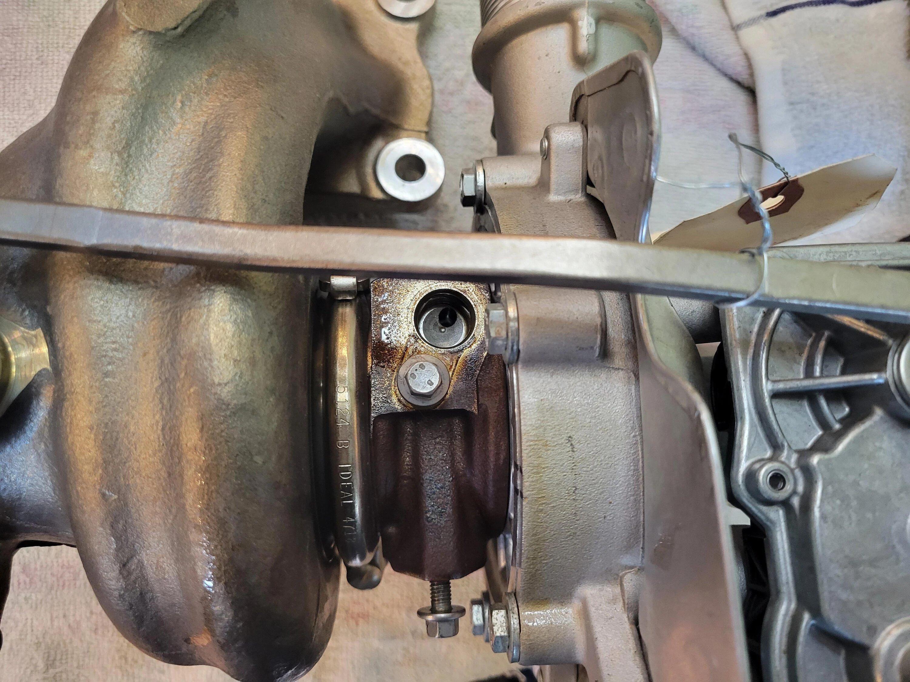

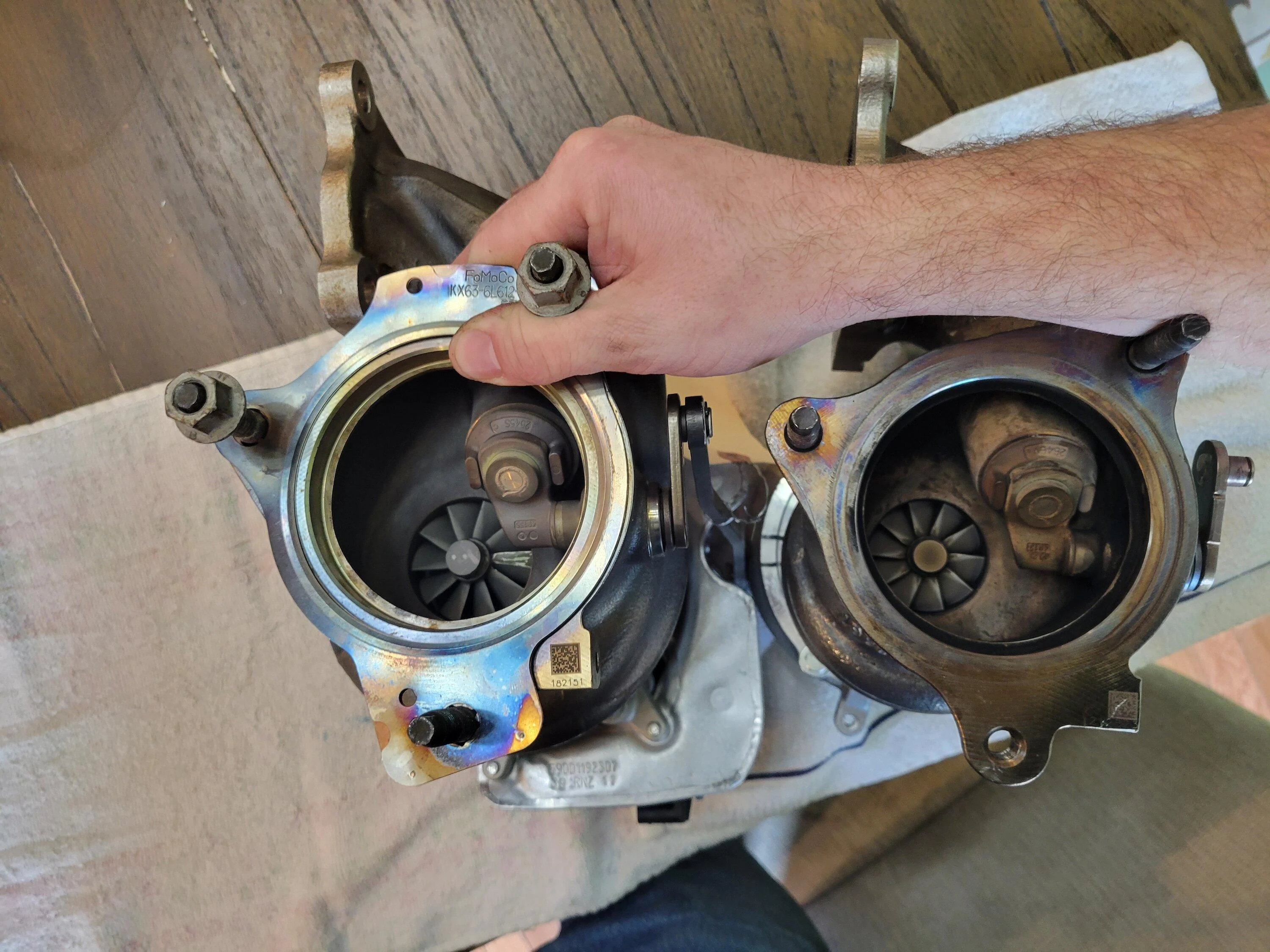

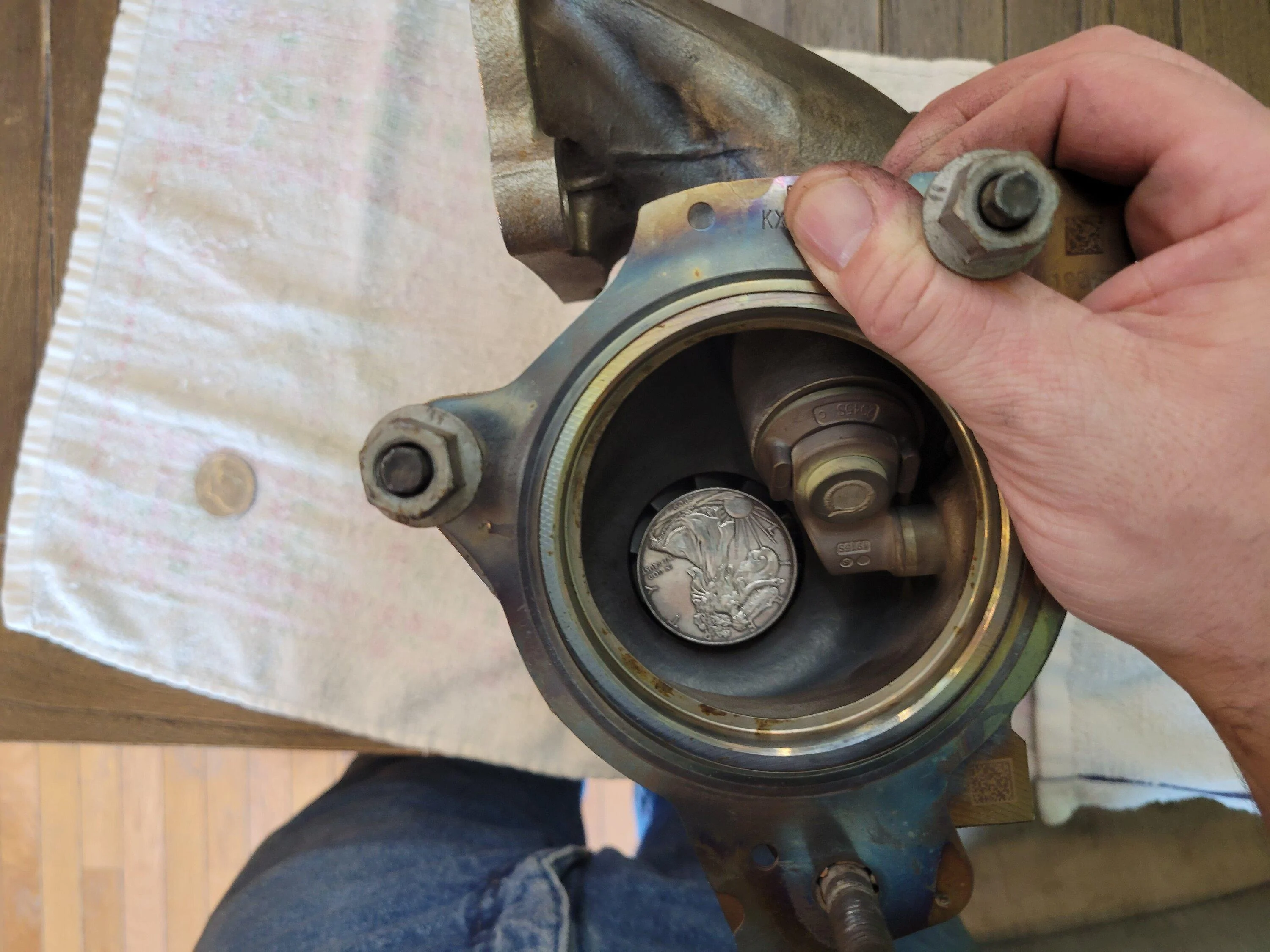

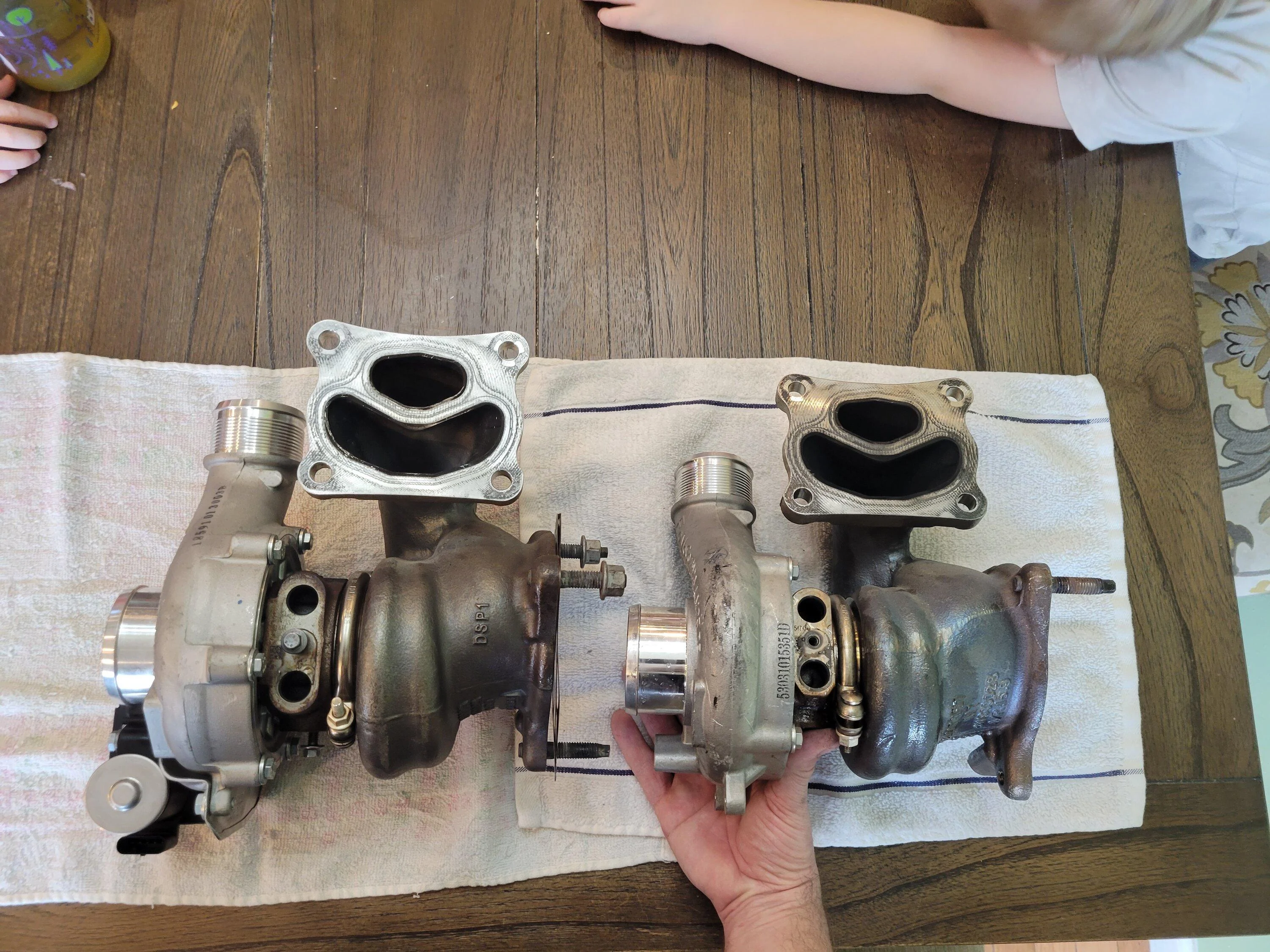

Hello again! Update on project QuikRik:
I have done a revision on the E30 Tune, as all looked great from 5Star. The tune was even adding timing, so that's a plus! Fuel was good, so all was well!
I did do a couple more runs in its fastest trim, IE: weight reduction, open DP(because I run the factory exhaust), and E30. The times were basically the same, at 12.73@108mph, and 2x at 12.72@108mph.
I think I've done all I can with this turbo. I "could" gain a little more going to E50 on the factory turbo, but in reality, if I'm planning to go to the Corsair turbo, it's moot.
So, starting in the near future, I will be throwing on the Corsair turbo, and seeing what we can get for power with much better top end power! That's it, no real cool news or anything, just getting back on track with what will most likely be my final upgrade for power!
Thanks for looking!

Side note, stock turbo is out. I will post some side by side pics with the Corsair turbo, and you will be hard pressed to tell the difference!

A few pics of progress. Comparison pics between stock turbo and Corsair 2.3T turbo.
