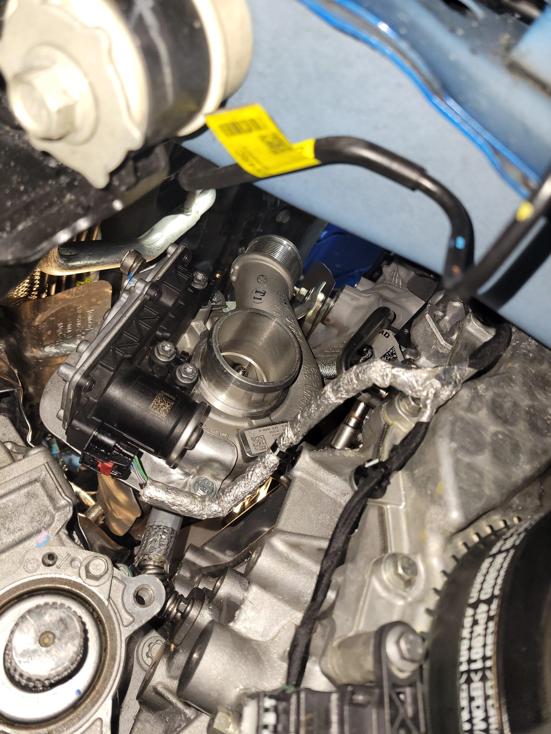

UPDATE: The turbo is on! Took it for a drive last night after buttoning everything up and checking for leaks, feels likecthe stock turbo in light load areas, which is great! It wants to spool just like the factory turbo, too! I'm waiting to hear from 5 Star so I can get the proper updated tunes. Even my 87 octane tune should be fantastic!
Noone can tell it's not the factory turbo. Sits in there perfect! I can't wait for the upgraded tunes!

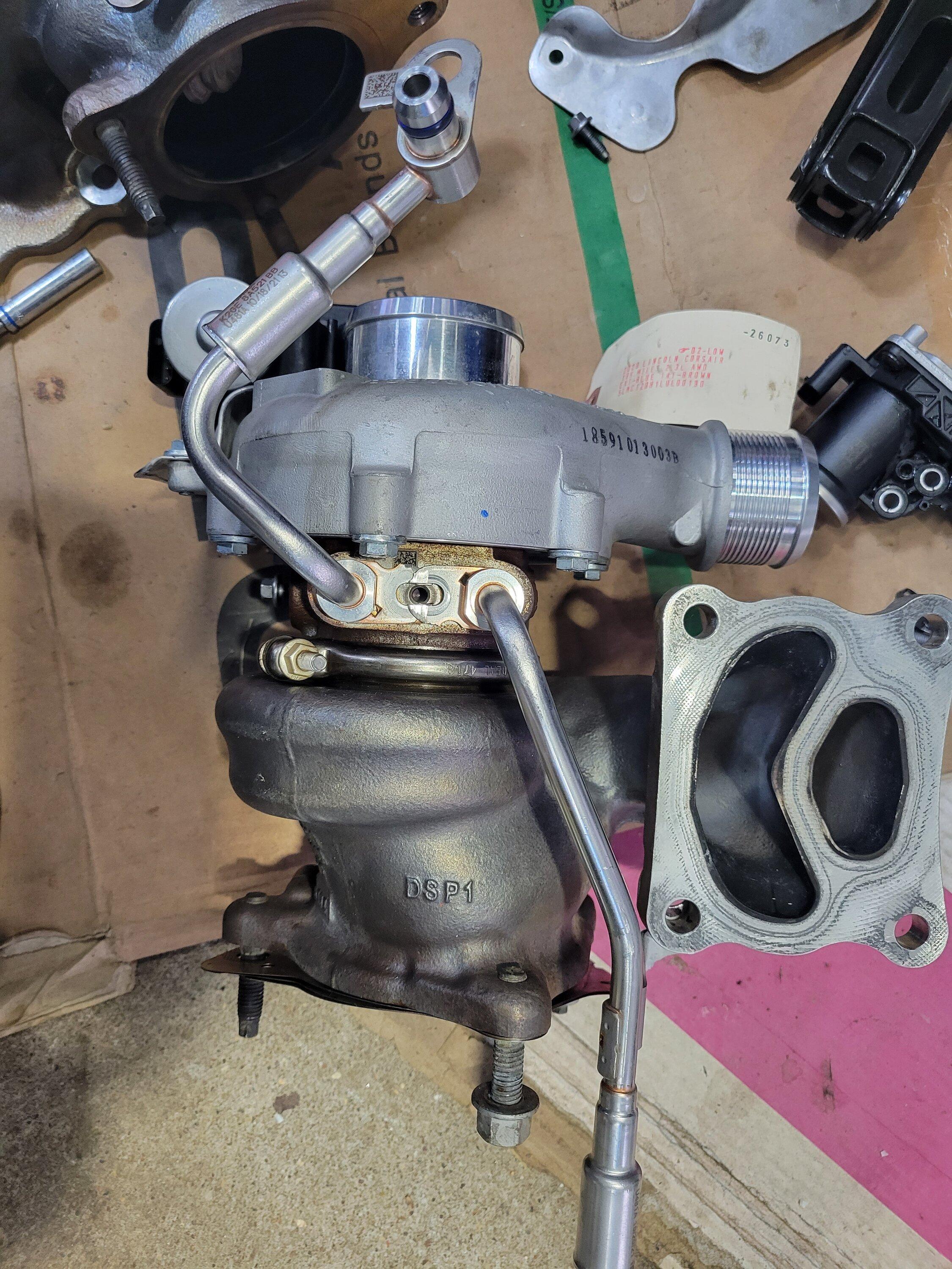

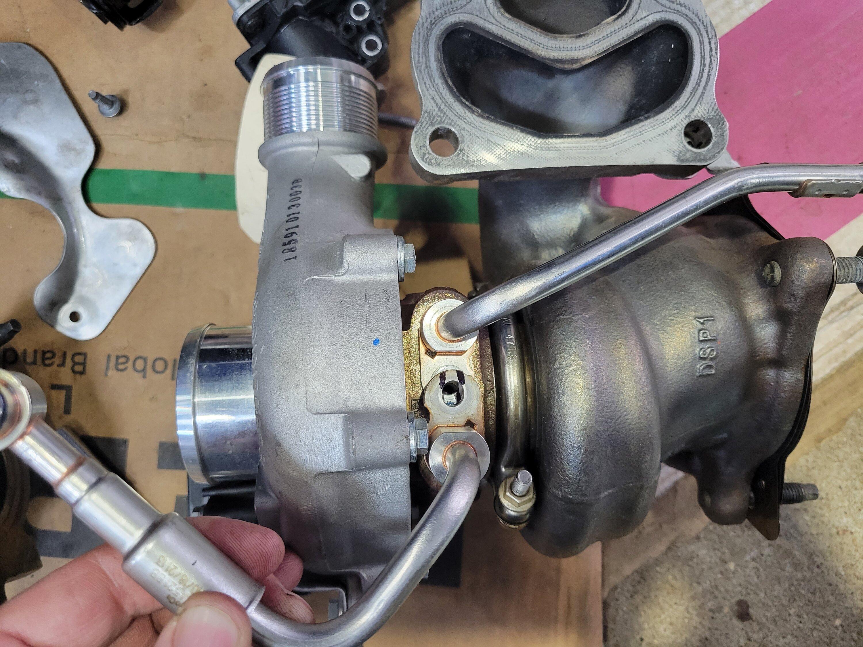

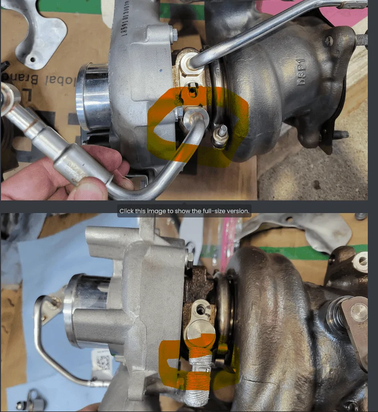

Amazing, cheering you on. It looks like one of the lines in the center section is attached to the side instead of top, 90 degrees different. LOL I'm not even sure if that's oil or coolant, but my question is the same - any issues due to that difference?

The coolant lines are attached on the "front" of the turbo. The oil feed is mounted on the "back" of the turbo, and the drain is mounted on the bottom. The locations from one turbo to the other are the same, the mounting flanges are just slightly different.
alright. whatever the case, those hard lines I circled are different and the end that doesn't attach to the turbo are pretty far apart. I'm sure you know and you have a plan, but I can't see that bolting right up without more parts from a Corsair, or extending / fabricating a connection.

Oh ok, I see what you are saying. The attachment points on the block are the same for the 2.0 and 2.3 engines. So the only difference is at the turbo itself.
The top picture you have is the two coolant lines. These both have slip fit lines with rubber o-ring style fittings. Both of these lines are 2 piece, giving a little more wiggle room for adjustment.
The bottom pic is the oil feed line, and besides the bolt hole location on the turbo itself, this line bolted right up with a little persuasion.
Like I said, getting the factory lines from the Corsair 2.3 Turbo would be the best thing to do, as they would have fit the block and the turbo perfectly.

lol thanks for humoring me. so the turbo is rotated 180 degrees in those 2 pics. coolant in the top, oil in the bottom. you did say that a reply or two ago.
Yep, those pics are opposite sides of the center section. It gets very confusing just looking at random pics on here, lol.
