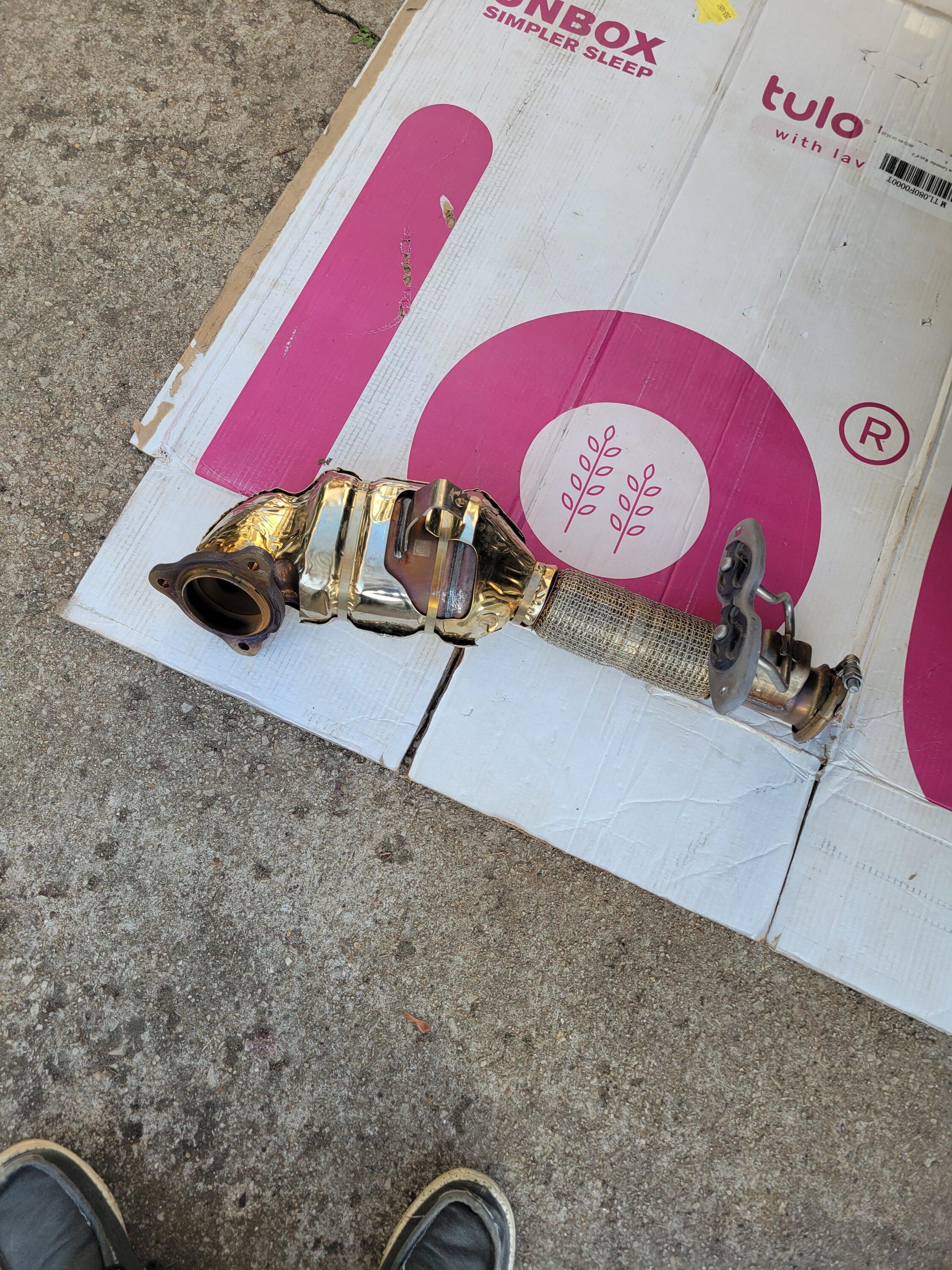

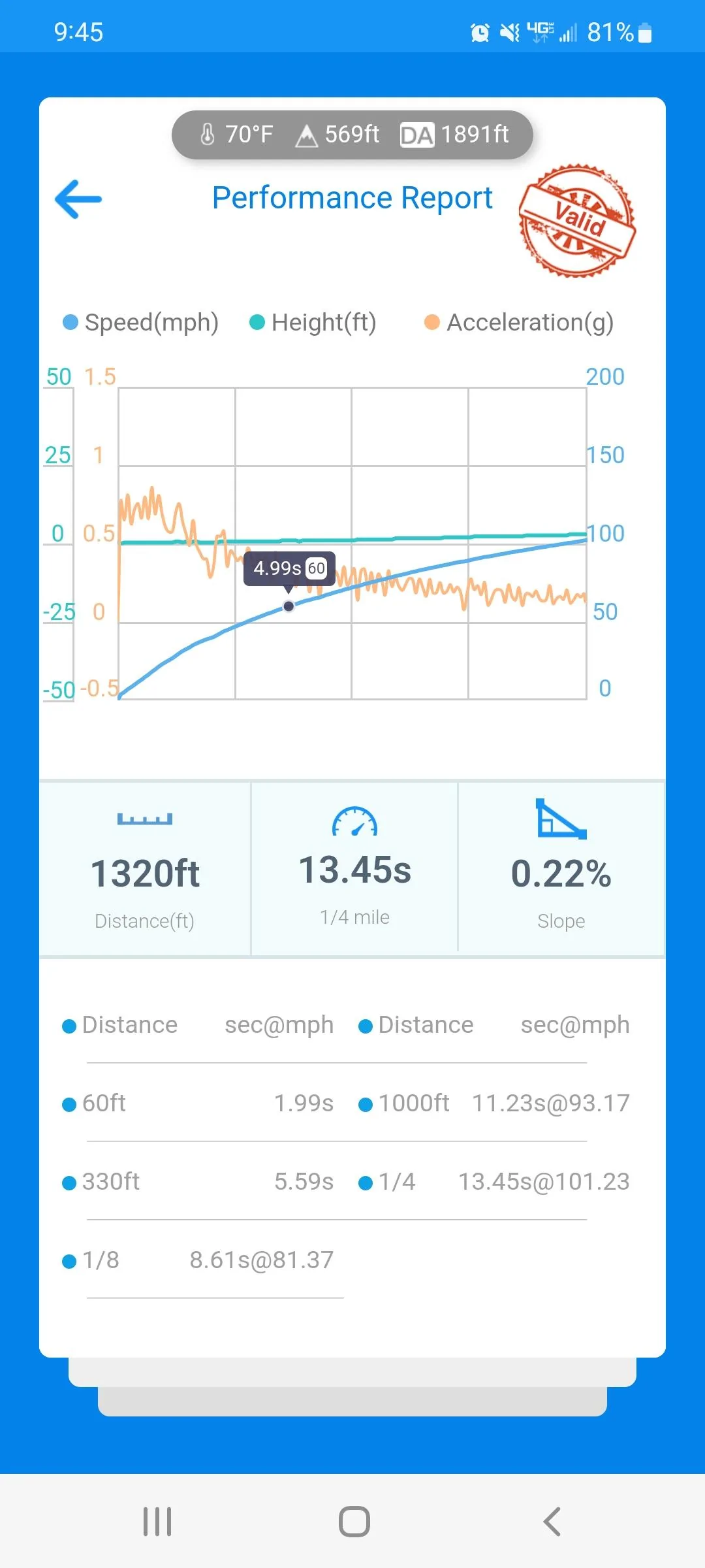

Well, first time at the track was a somewhat failure. I didn't run too bad, but the downpipe didn't seemcto make the difference I thought it would. I really gotta get some datalogs so I can get some revisions!
DA started over 2200', and tapered down to about 1700' I think. A far cry from the last couple weekends where it was negative DA.
Fastest pas was [email protected]. I ran 8 passes, a also ran my Dragy for each run as well. 60' were pretty decent, with a best of 1.944.
Number 1310 on the timeslips.
Only additional mod was a 3" downpipe.

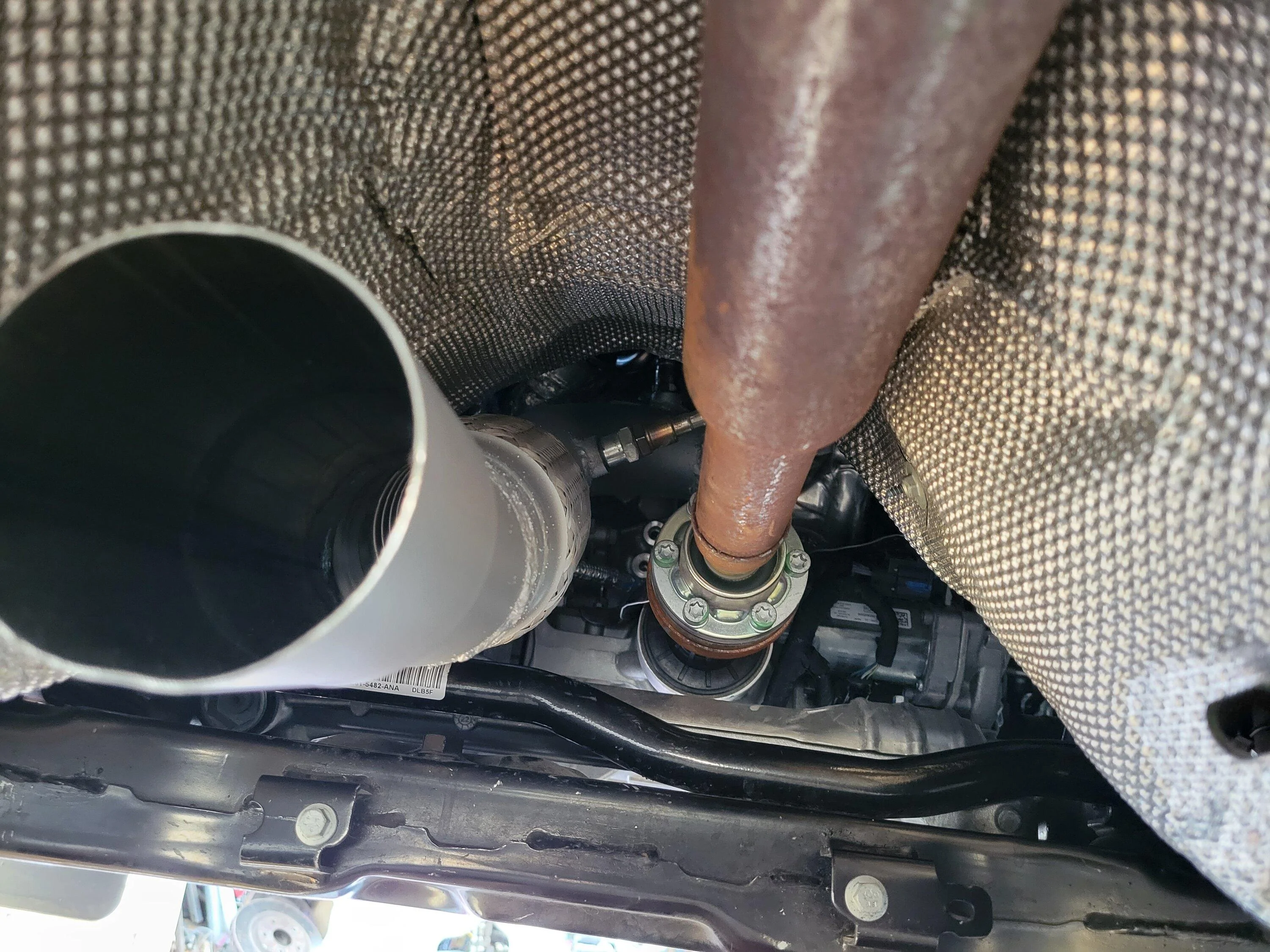

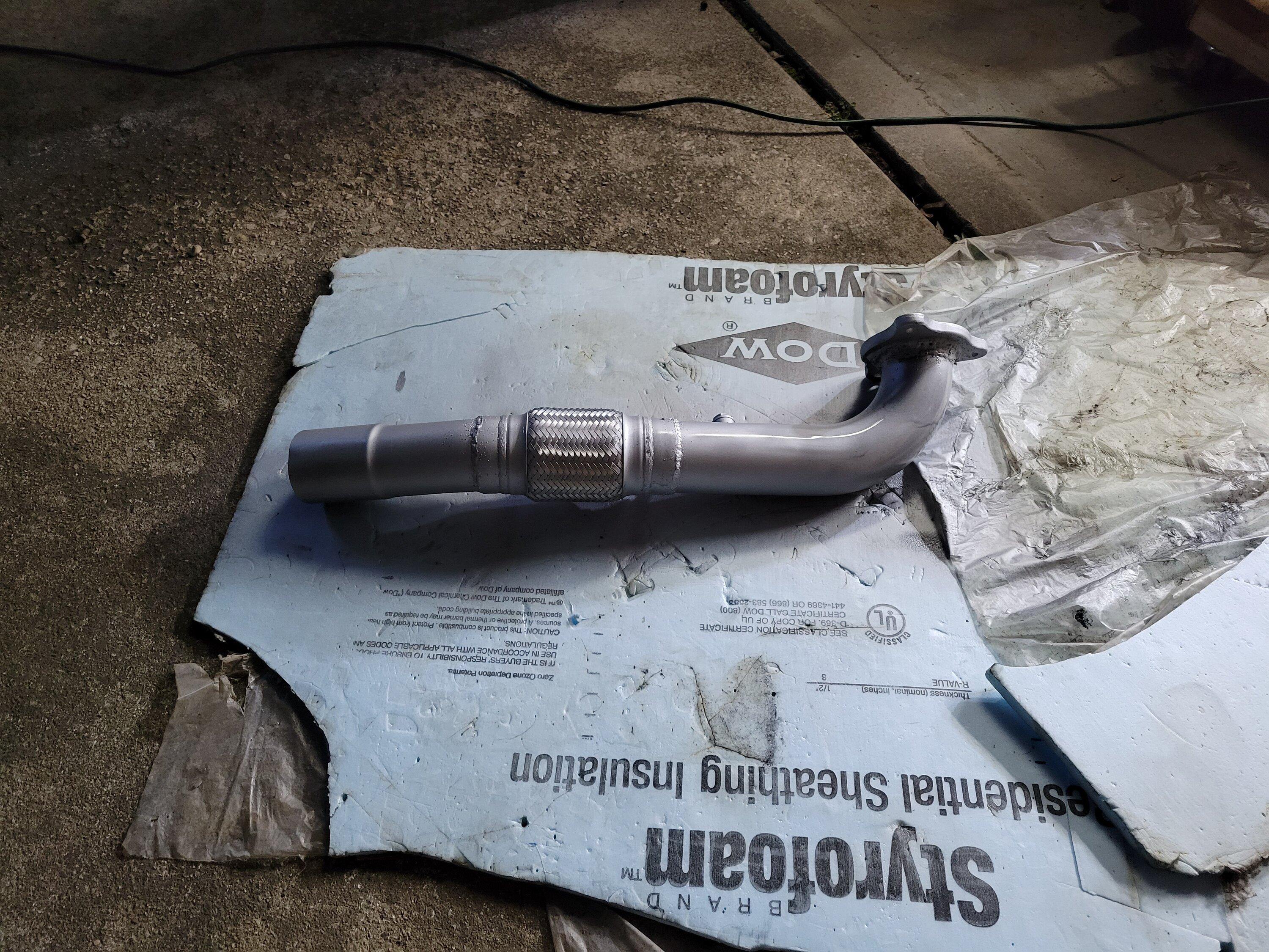

Ok, so update! I should have made this post before the last one, but didn't have time. I decided to make an offroad pipe for the track. 3", with a 3" flex pipe. The welds are absolutely terrible, but it is what it is, lol.
Making this downpipe either needs better programming, or the turbo is just completely maxed. I don't think it's totally maxed, because I've hit higher mph with the factory downpipe. I'll work on getting some datalogs and revisions and see where it goes.
