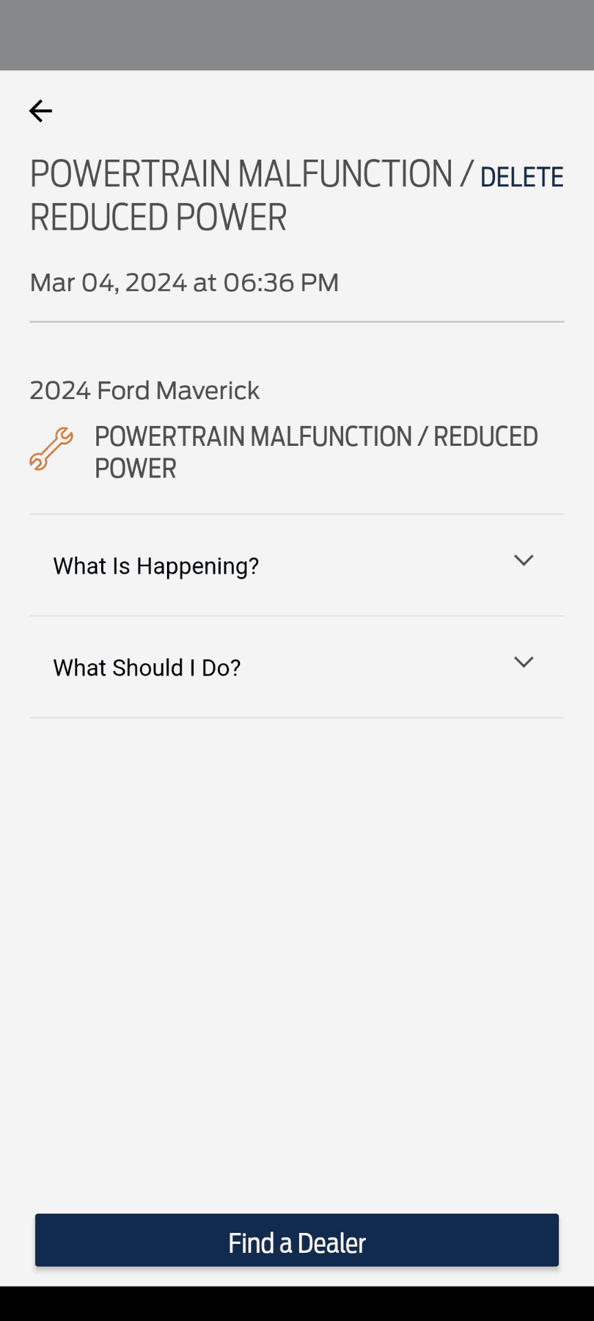

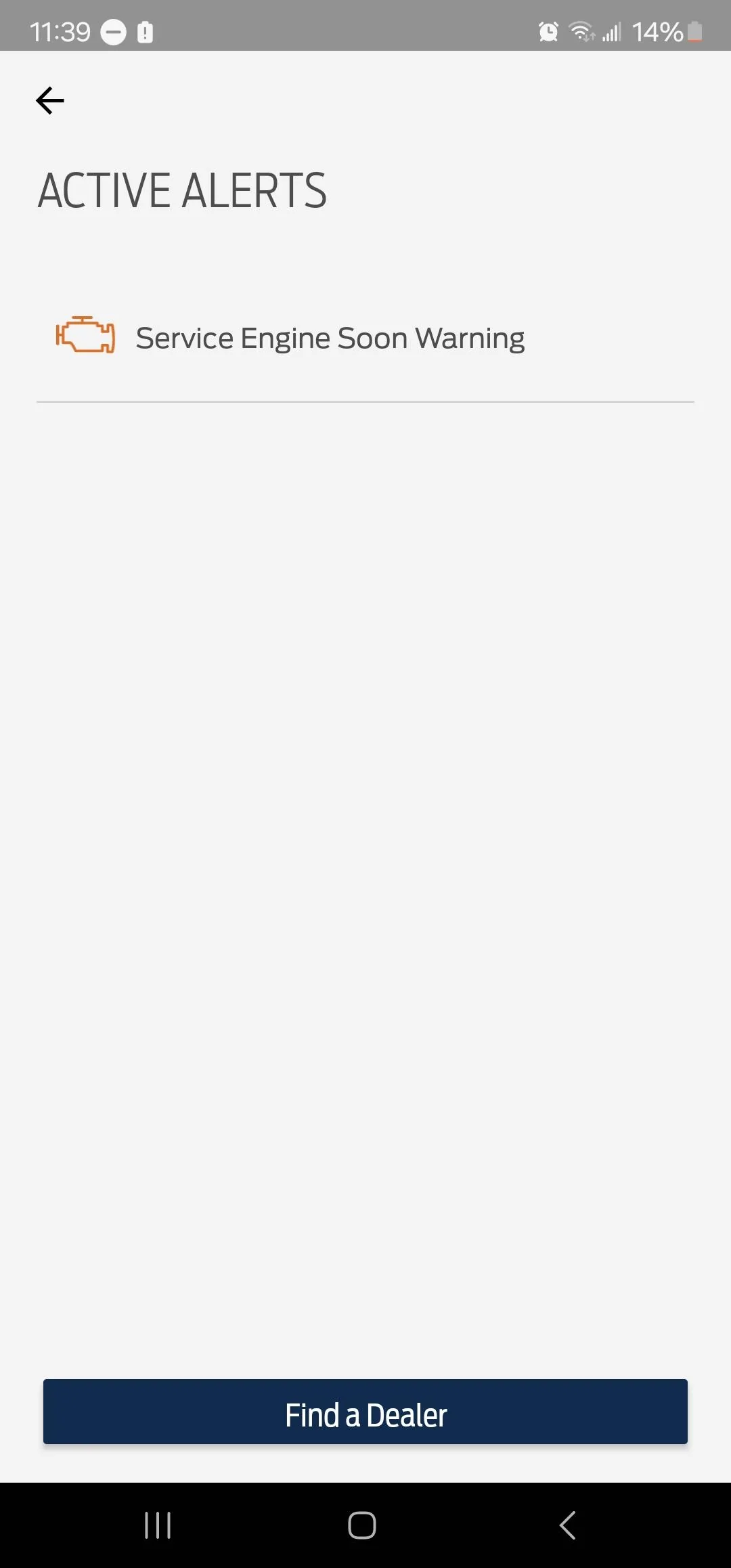

While driving on the Fwy today, i experienced the engine malfunction on my dash and lost power. Going from 70mpg to 20 in a matter of seconds. I took this video of how it sounded when i was exiting rhe fwy. Sounds like a Rod is gonna break free! Had it towed to my dealership and hopefully they can fix it... I really want it fixed and would not want it to be bought back from me. Love my Maverick Hybrid. 2022 with 26K miles.
Ford Maverick Powertrain Malfunction/ Reduced Power Screenshot_20240309_233916_FordPass

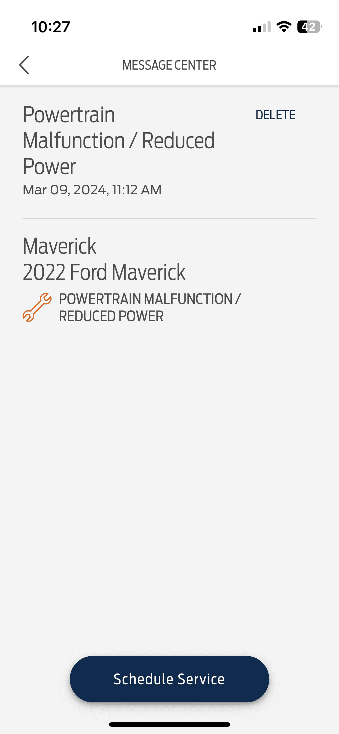

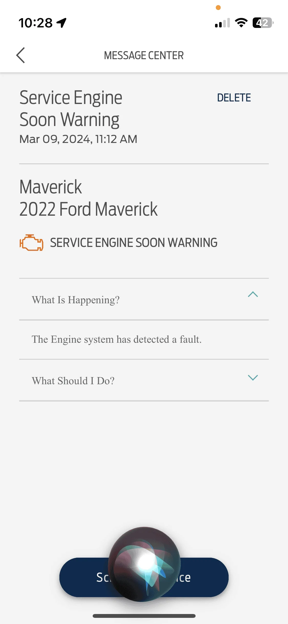

These were my messages.
Ford Maverick Powertrain Malfunction/ Reduced Power IMG_3635
Ford Maverick Powertrain Malfunction/ Reduced Power IMG_3636

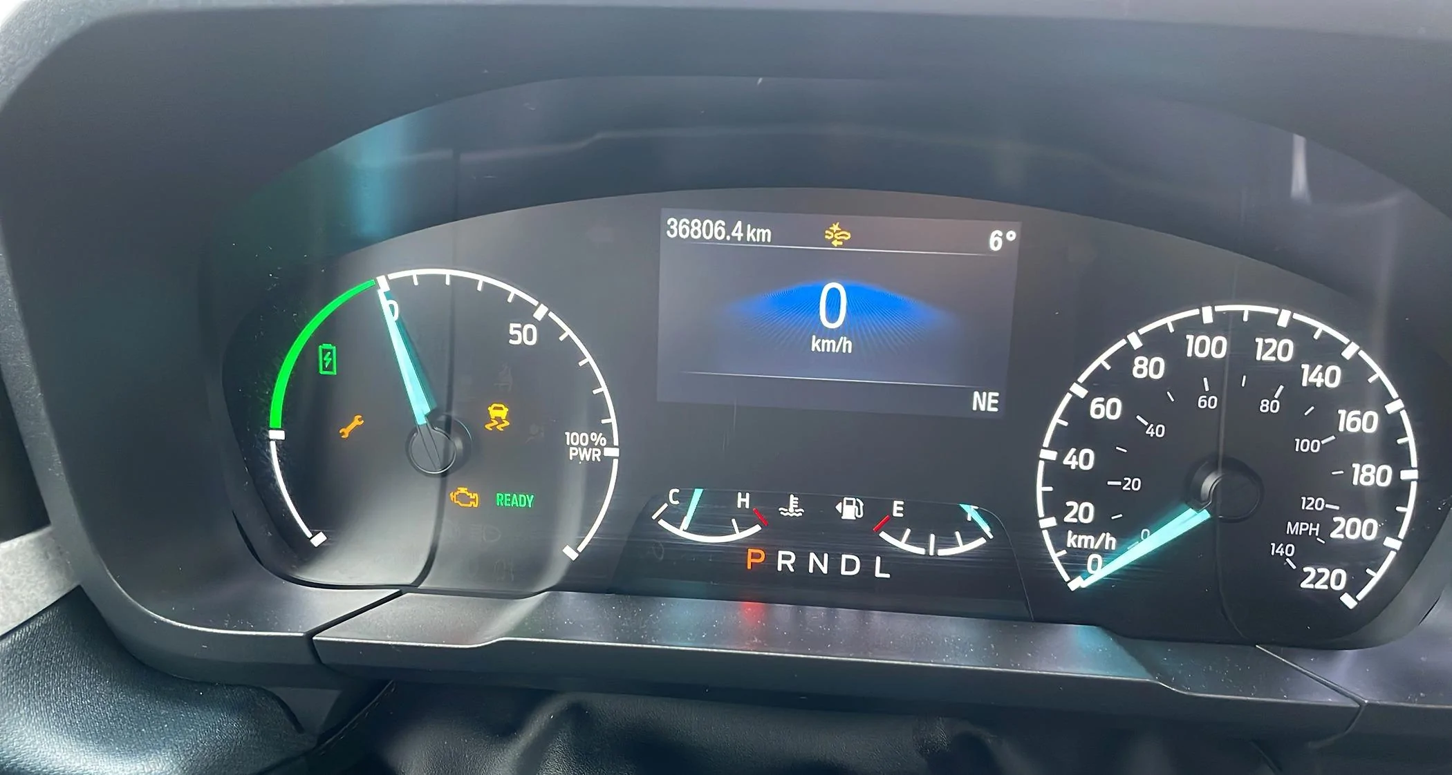

2023 hybrid, 19k miles (30500 km). I took it in for the tail lamp and PCM recalls. The following week I had both CV axles replaced. A week later I was driving about 40mph, and as I was braking the transmission started clunking, the engine and maintenance lights came on, the shifter dial started flashing, and a message popped up saying service vehicle soon. The truck would only go about 10 mph. I could drive it to the dealer (1 block away). The service mgr said several codes popped up but had no idea what the issue was. They said it went into neutral at 10 mph (when I was braking). They suggested it might be the 12v battery or the shifter module, but were not certain. They did a test drive and it drove fine. They kept the service ticket open and said for me to drive it and bring it back in case it happened again.
Update: It happened again y/day. 22k miles (36000 km). It happened crossing the Ambassador Bridge. I went over a bump, then it lost power. This time the tranny didn't clunk, it just lost power and went into limp mode. It's at a different dealer this time. The dealer couldn't find anything wrong with it.
