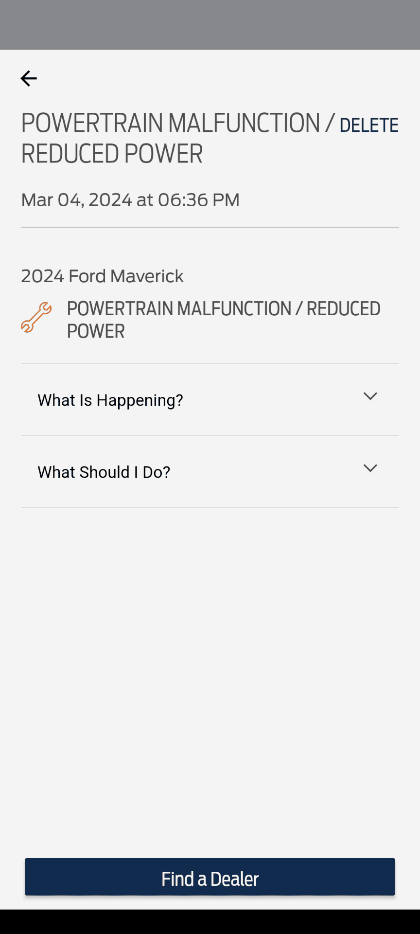

My 2024 XLT hybrid has had no updates that I know of but had the Reduced power malfunction stop me from starting the truck in my driveway. 3hours later, started fine, drove to dealership, all good.
Maybe a new thread for hybrid 2024s to help track other occurrences would be good.
