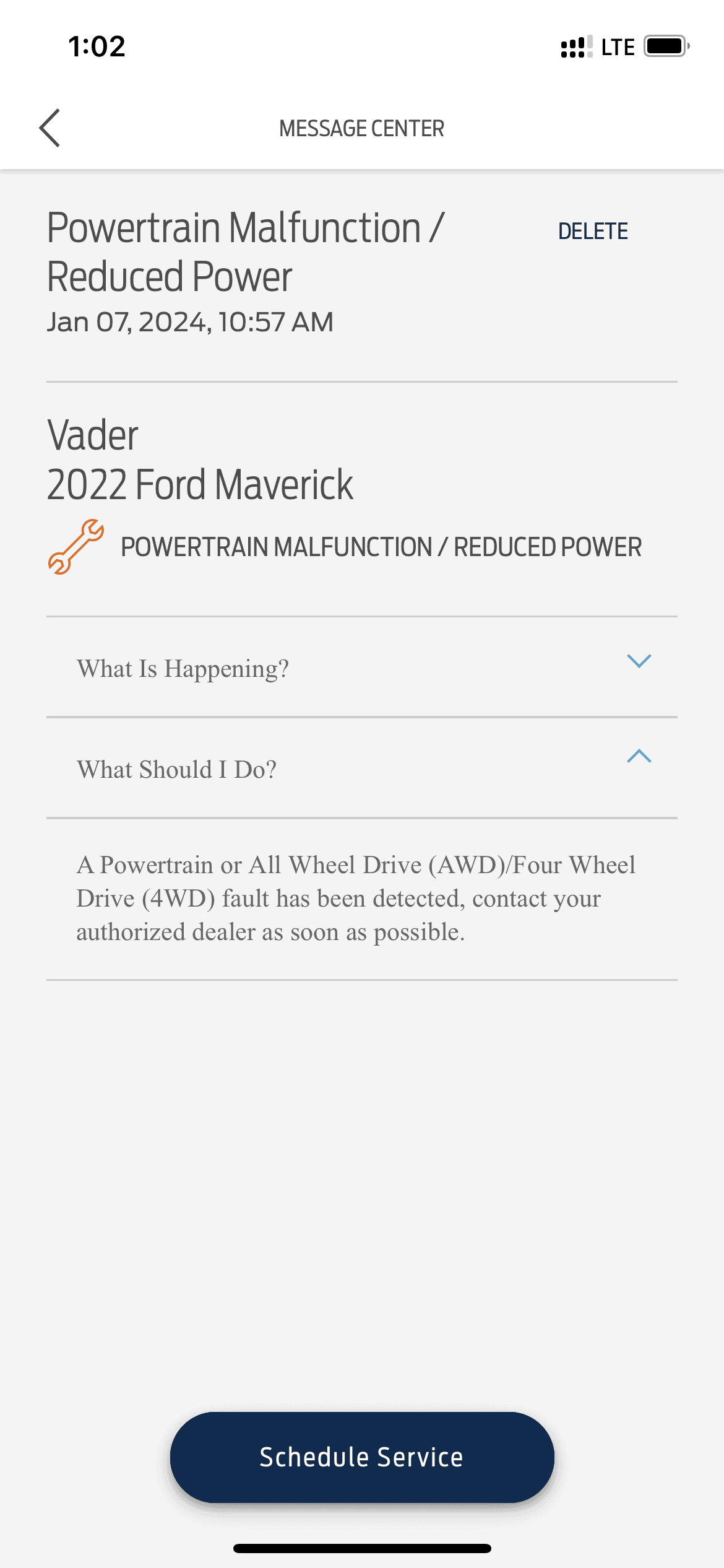

I was driving home to NC from PA today and just after crossing into WV i got the wrench icon after a hard shift and loss of power on the interstate, in a heavy snow flurry. Luckily after a stop to get some gas, check the oil and antifreeze level the wrench went away. I saw that i had a new message in my Ford pass application and then this is what i saw. Needless to say i was anxious for the rest of the trip home. Doesn’t fill me with a lot of confidence in my maverick for long trips. I’ll take it to the dealer ASAP but it seems that this is a mystery problem and really doesn’t make me feel great about driving my truck on long trips.
Hi there, Mike. This powertrain concern doesn’t sound like something we want you to experience with your Maverick. Can you send us a DM with your VIN & dealer name/location? I’ll see how I can assist on my end if you are still in need of assistance. To send a private message, just click on our username and select "Start Conversation".

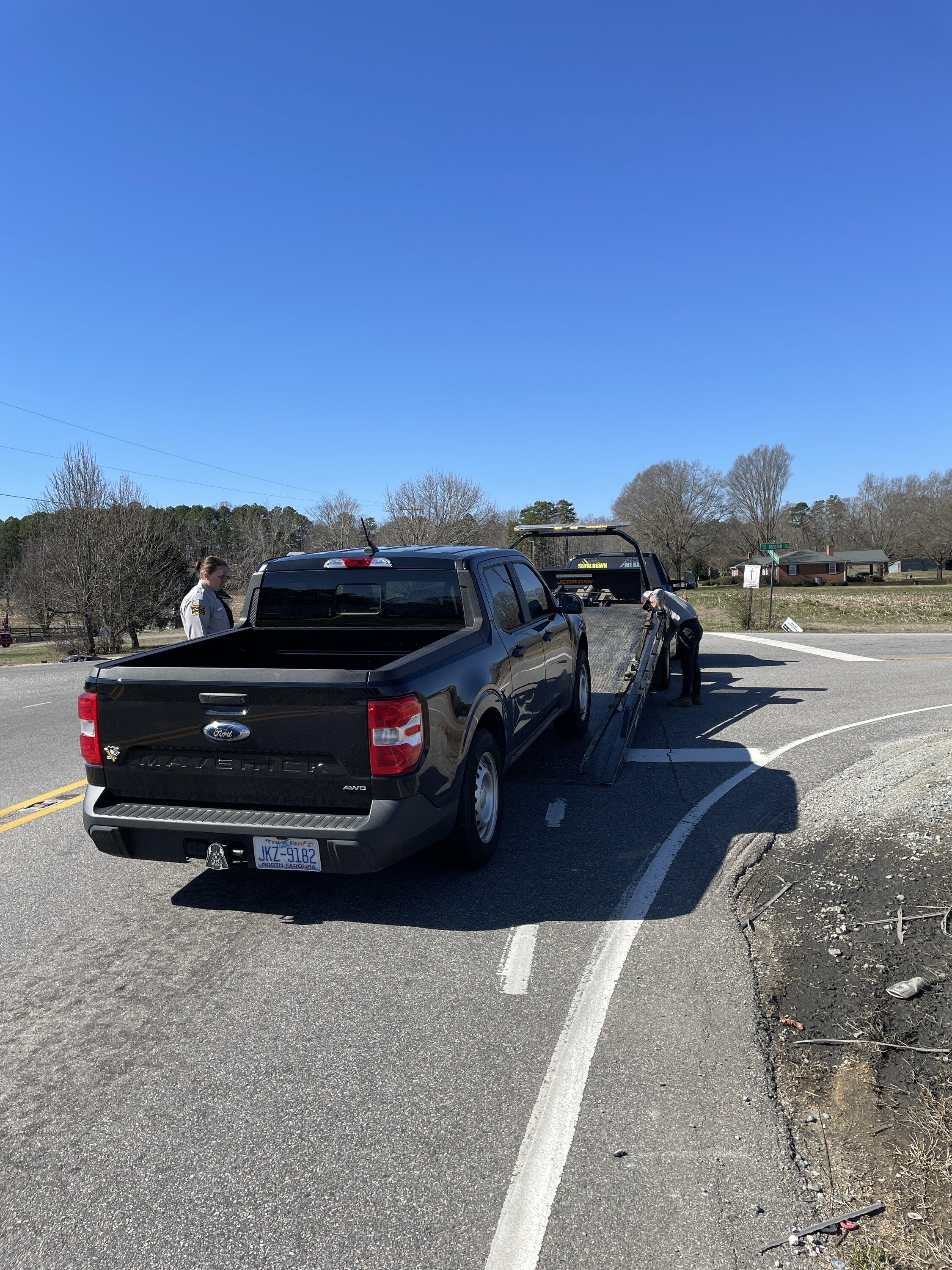

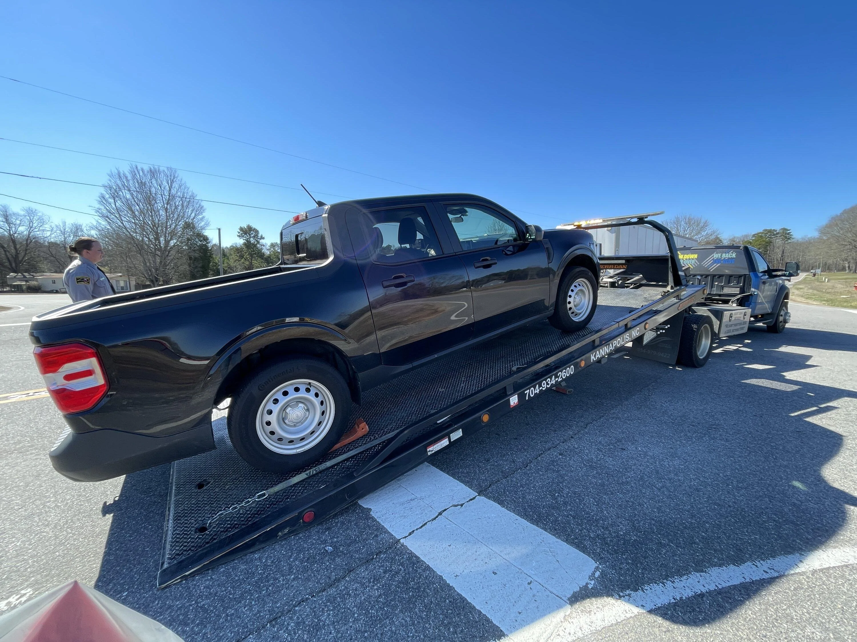

Here’s a new update… today i ran out to do a quick errand on my lunch and it seems the the power control module decided it was a great day to fail and with that… render my brand new-ish maverick. Dead and blocking an intersection. Also, did you know that there is an override to the shift wheel underneath the little tray? I didn’t… but this and the Powertrain malfunction faults from early January seem to be connected… I’ve documented this with Ford’s customer relation team and if the problem keeps happening, I’m hoping that they would make it right and either replace my Maverick or buy it back according to my state’s lemon laws. Time will tell i suppose.

No… mine gave me a service engine soon/Powertrain malfunction, reduced power code driving from PA to NC in early January. My dealer cleared the codes and gave it back to me. 3 weeks later my Maverick started to shift really weird and pulling up to a stop sign at a busy intersection… just died. Had to have it towed to my local dealer and then once they worked on it for 3 days, they replaced the power control module and gave it back to me after testing it throughly.
