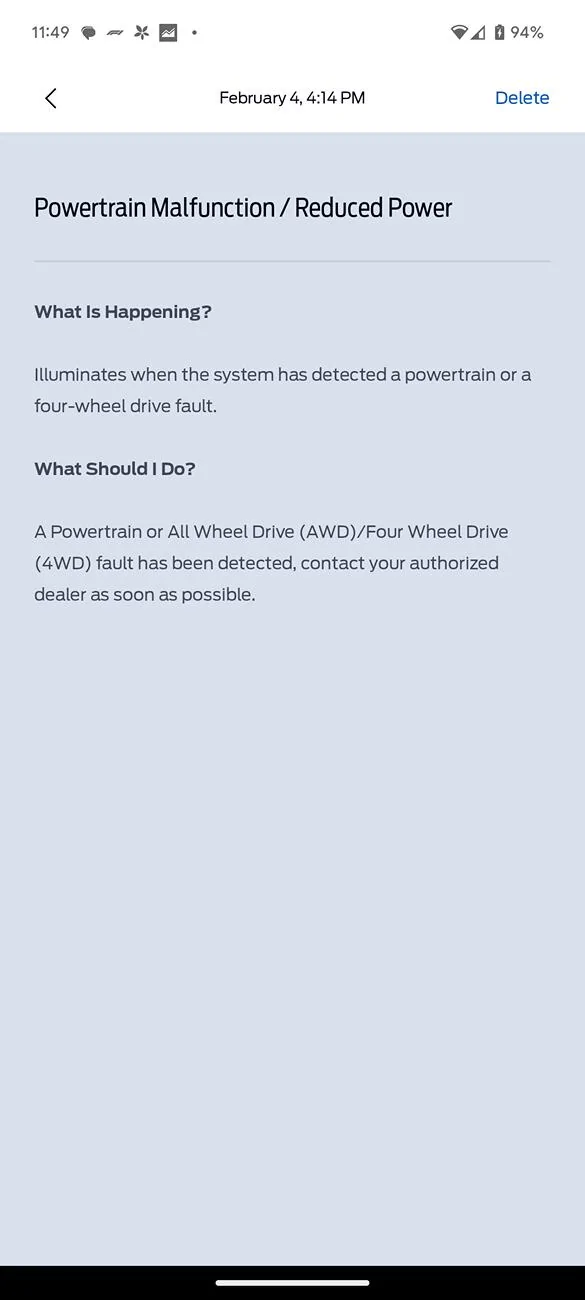

In ford pass all I can see is;
Ford Maverick Powertrain Malfunction / Reduced Power 1738954209400-zk

ugh, that's a terribly vague and unhelpful message. I thought I'd see before where people were getting the actual DTC codes. hopefully your dealership can diagnose, but no, I doubt it's related to the ecoboost flooded battery recall.

Ya wishful thinking it's just recall battery issue, but we will see, I'm not sure when I go to service area in app nothing shows, this is the only trace of it I can find on my ford pass app (in the messages section) If I turn on the vehicle, the light or warning message was no longer there, so hard to diagnose anything beyond bringing it in.
