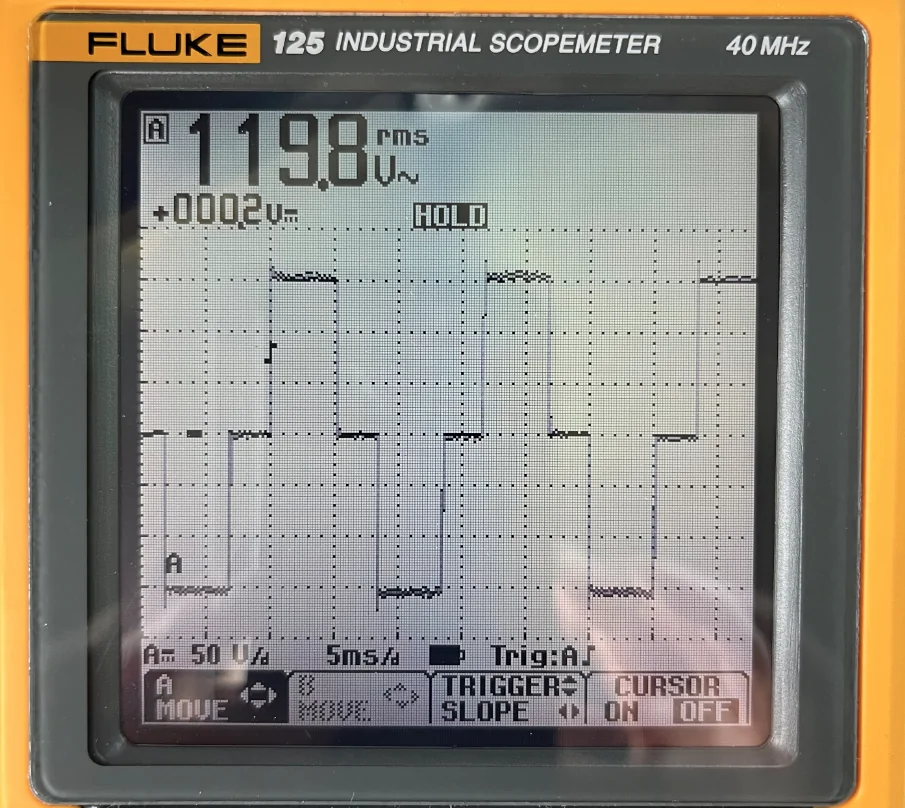

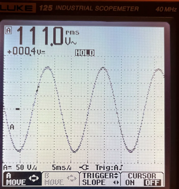

Was looking at the voltage out of my Maverick 400W inverter vs. the 300W inverter I carry in my Escape as I read some laptops power packs have problems with the Ford inverters.
Maverick:

300W Pure Sine Waver inverter:
Maverick:
It's not the voltage that's the problem it is the modified sine wave vs the pure sine wave. The voltage variation could also be a difference in the mavericks dcdc output being 15.2 or 14.6v. it's possible that the pure sign inverter adjusts the input voltage.
that's not a "modified sine wave"; it's practically a square wave (although it looks kind of like what you get when you try to build a square wave out of sine waves, but I'm 40 years from those classes. [yikes! 40? surely that's a mistake!]
