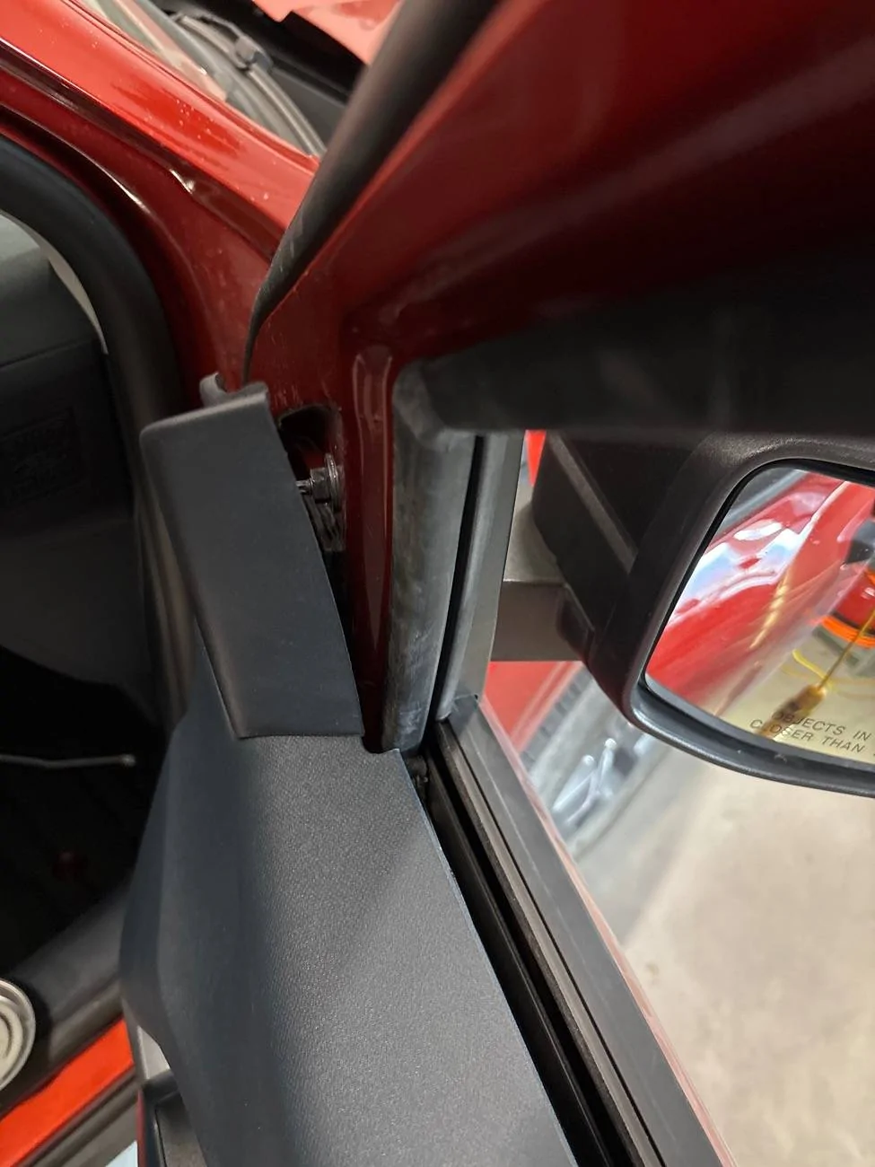

Just pulled a door panel off my 2024 Mav Hybrid XLT to replace speakers. The trim piece above the door panel that covers the wires for the mirror won’t re-engage into the clip in the door. Any one had this problem? See photo. TIA!

Mine did the same thing. It seems the pin/wedge part bends down and doesn't lock in. I think I've need to order a replacement but I haven't gotten around to it yet.

You need to take either a pair of needle-nose pliers or pliers and remove the metal clip that has the rubber surround piece on it from the door panel. Reinstall it on the plastic clip cover, then reinstall the plastic trim piece over the outer mirror.

This just happened to my drivers side one. Thought I broke it but I'll have to give this a try tomorrow and see if I can get that sucker out of there.
Edit* Just confirmed that's it's not actually broken and resetting this clip piece onto the trim piece fixed the issue.
