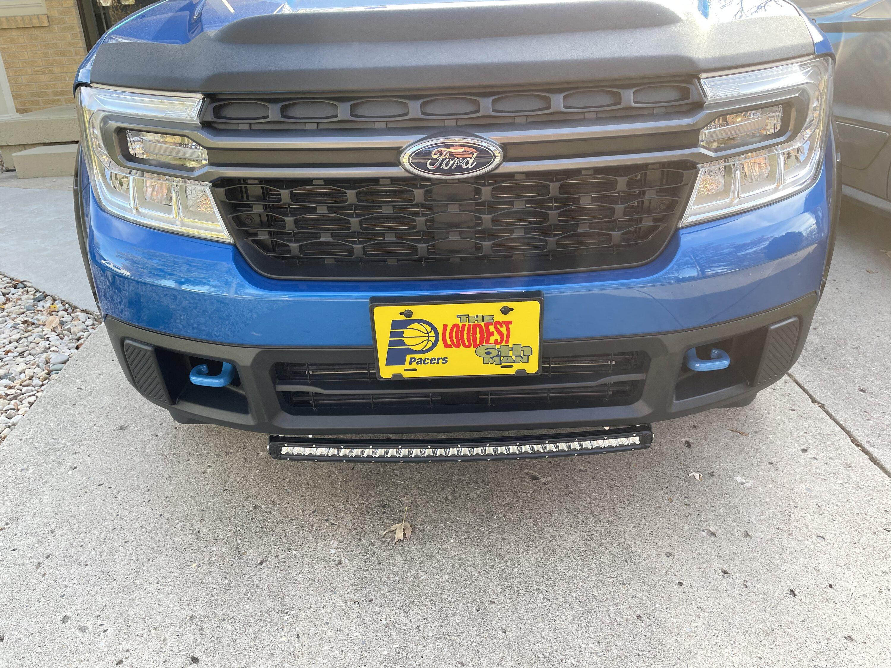

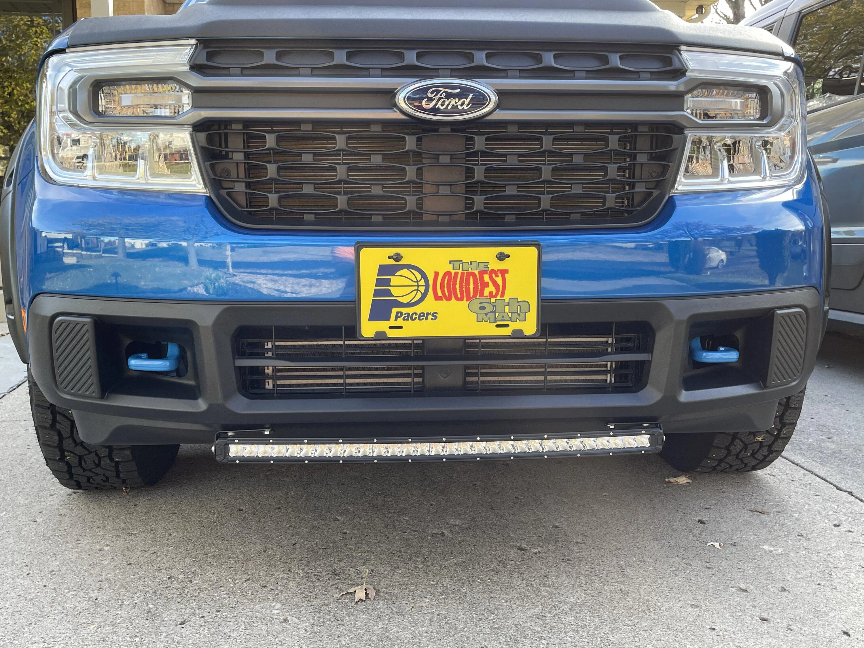

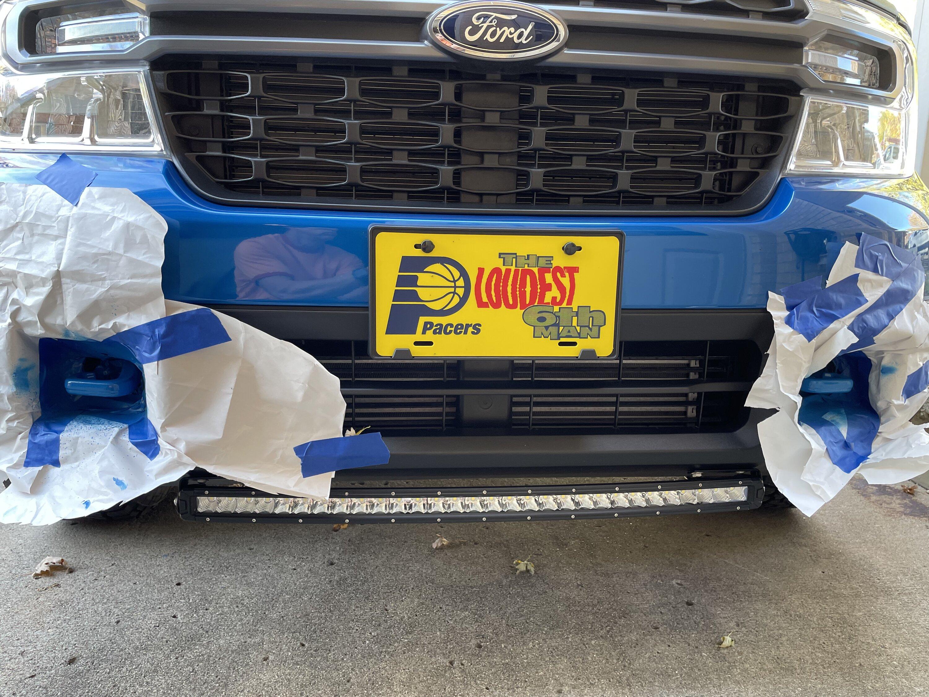

I painted my tow hooks this weekend.
Went from black to Ford Blue from duplicolor.
There is a clear coat on the black you have to scuff. I used 600 grit, used grease and wax remover, painted 3 coats of Ford Blue and 3 coats of Diamond satin clear from Eastwood.
I like them a lot better. Would be easier to see at night if need be.

I want mine red. Thanks for the post with the masking and how-to. I was dreading using a brush.
Deleted member 12286
Guest
Yeah there was no way I was going to take front bumper cover off and go through the wheel well just to remove the hooks.
Buy the stickiest painters tape there is.
I had a hard time getting mine to stick with all the coatings I put on bumper cover and black plastic. But I got it.

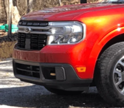

So..... since the tow hooks only take up park of the cubby space (like 2/3) and there are no fog lights, why is the "cubby" cut-out that size and shape?
While many people have stated it's not meant to be a punch-out.... it sure looks like it is.
I want after market fog lights but I don't know what shape or size. I "assume" fog lights will "eventually" be an option next to the two hooks?
I'm looking for the same foglight setup - preserving the tow hooks. Bonus would be switchable from white to yellow.

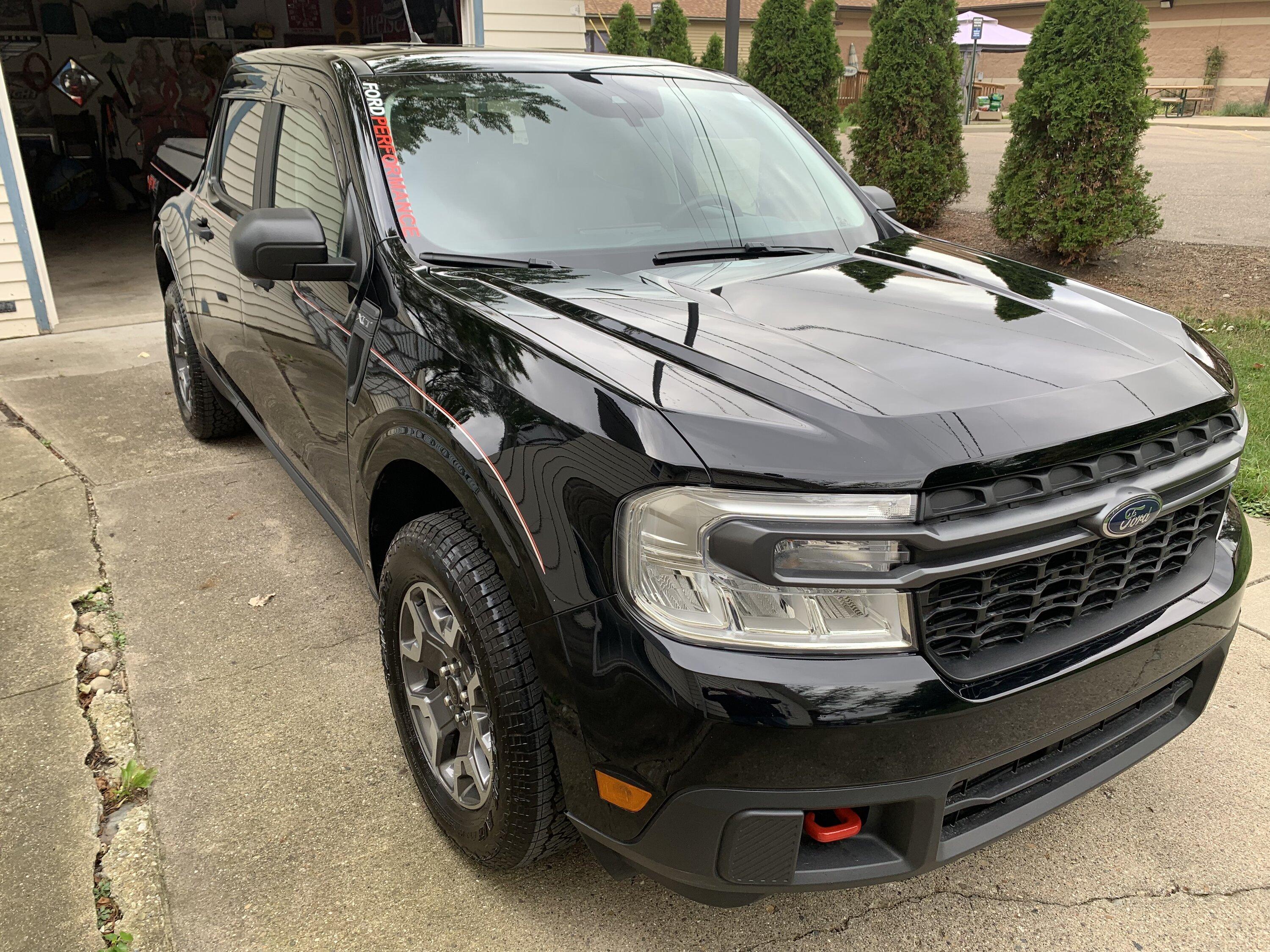

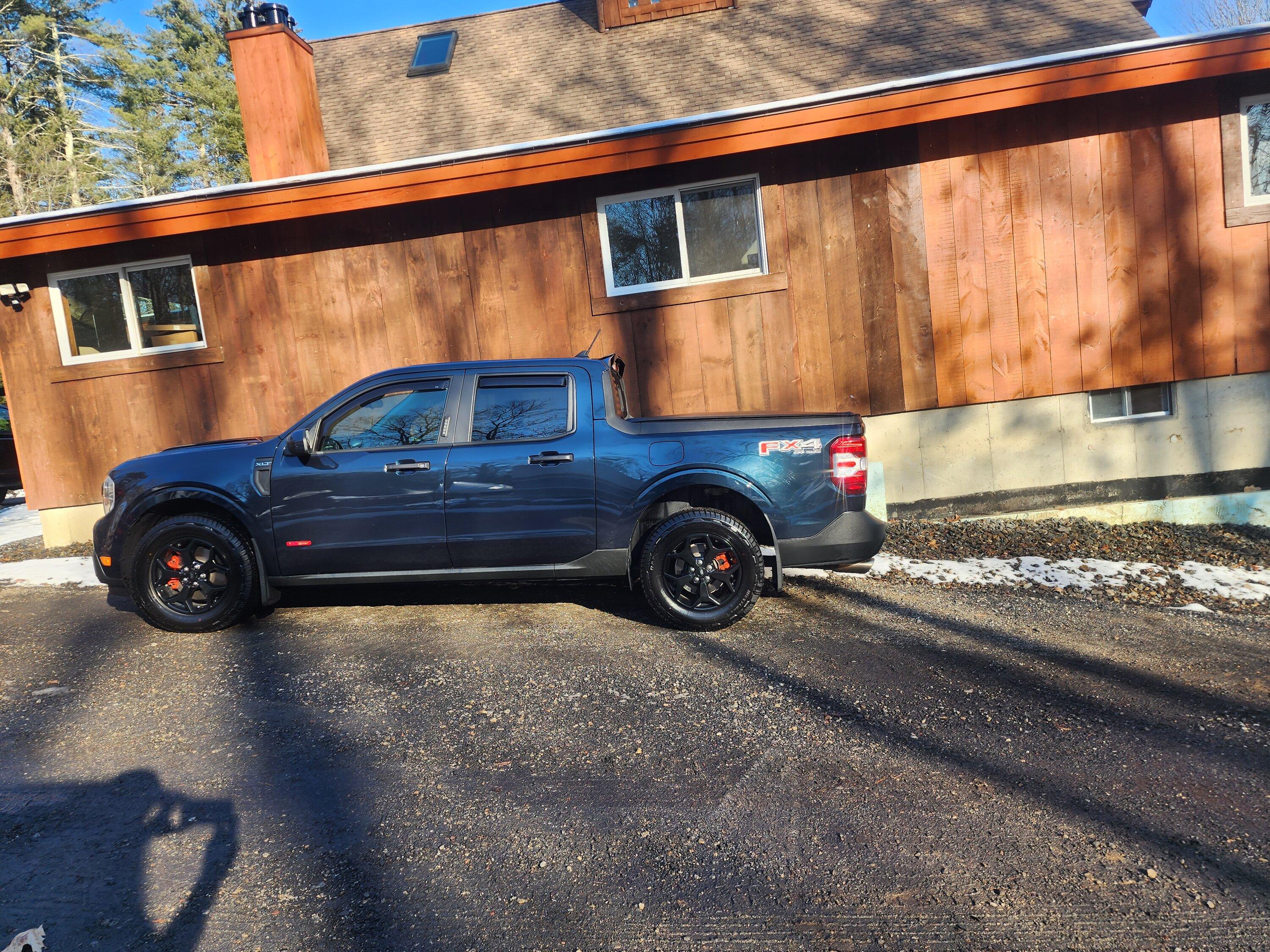

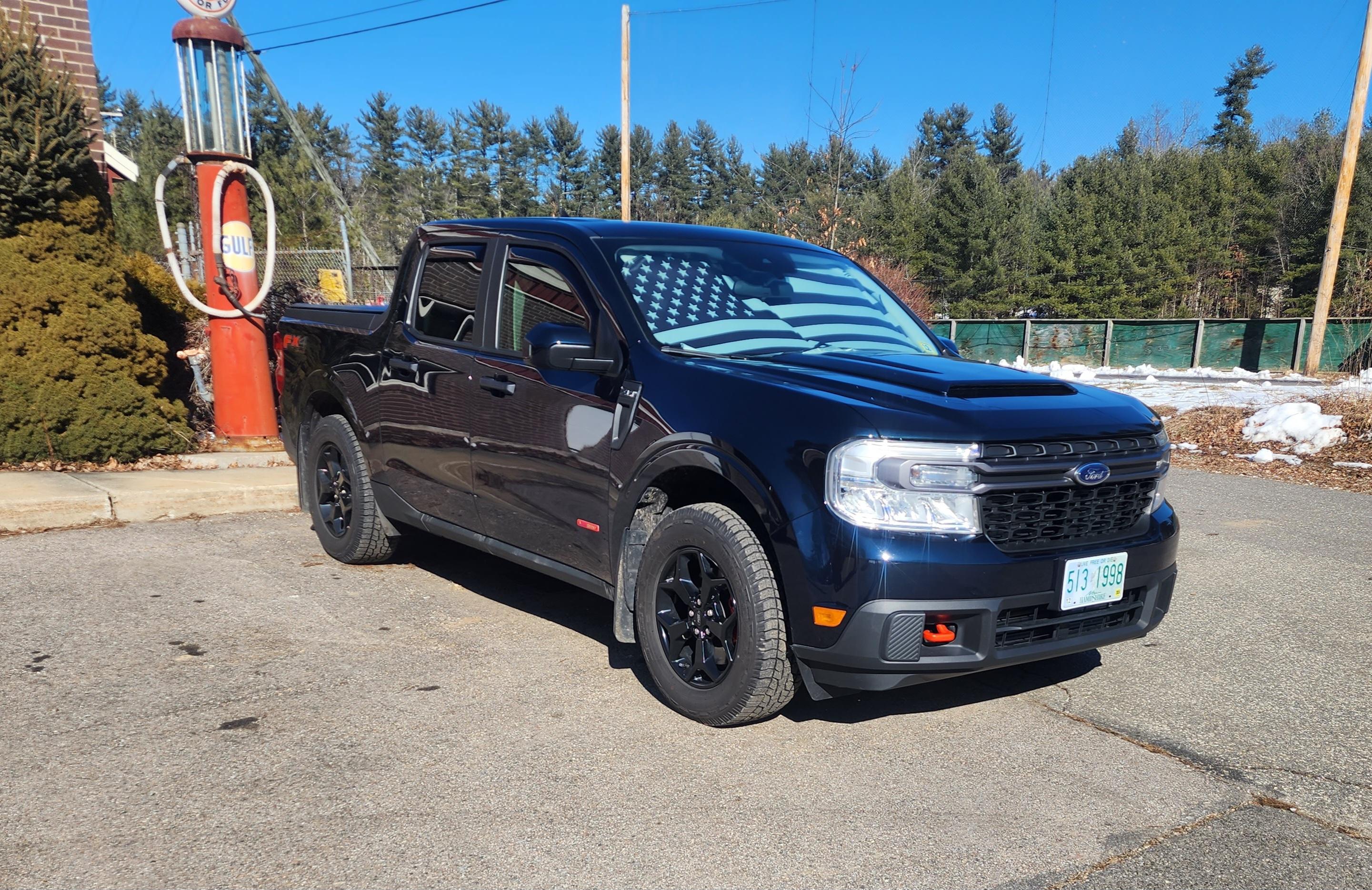

I did mine also to continue the factory theme. Did my brake calipers ,right tow hook and orange focus RS eco badging. I actually did this in June 22 copying the mach 1 appearance package with the fighter jet Grey. I was going for the ST look.
Ford Maverick Painted Tow Hooks 20240208_130515
Ford Maverick Painted Tow Hooks 20240210_145723
Those painted calipers look great.
