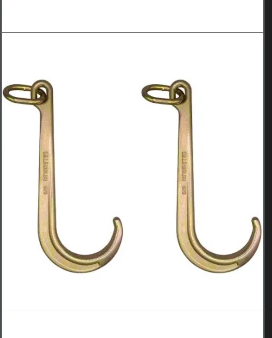

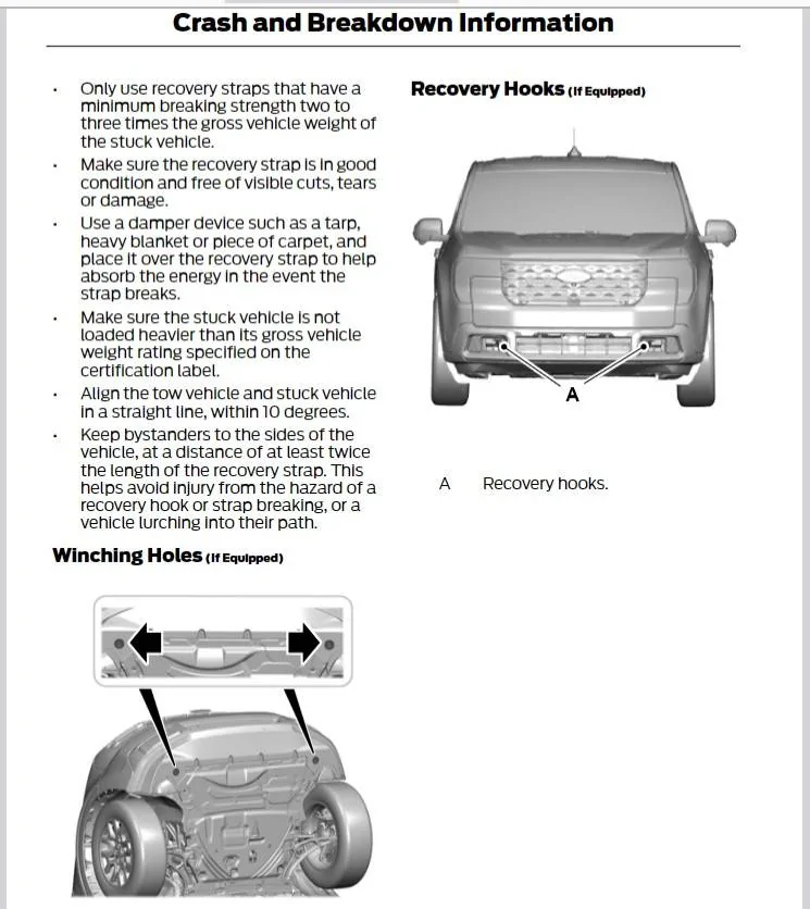

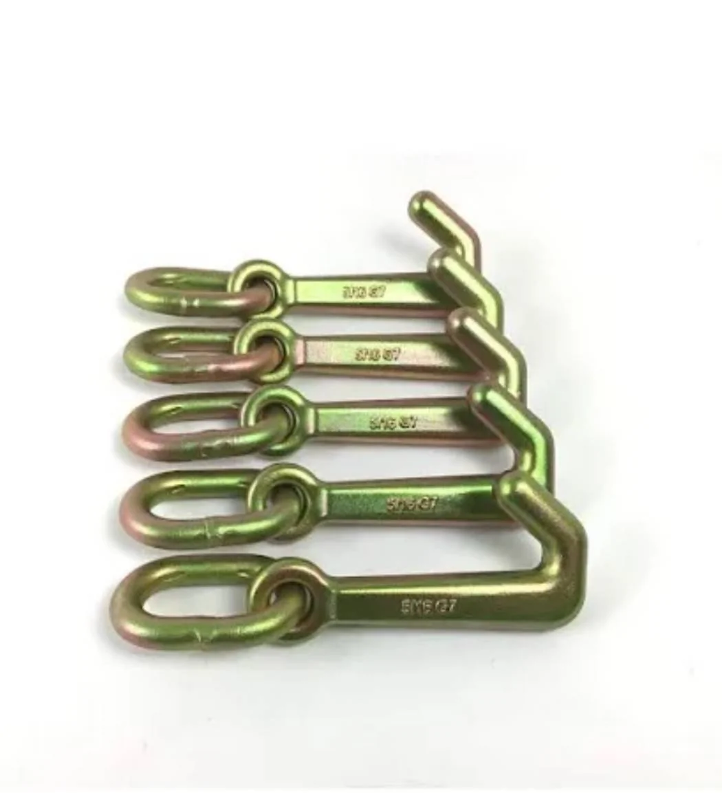

If you get your Mav stuck, the chances are really good that you will not be able to get to the transport tiedown holes way down under the vehicle to put the small j-hooks in without digging the vehicle out first. If you have to dig it out anyways, what's the point of the j-hooks?
You have no imagination.
