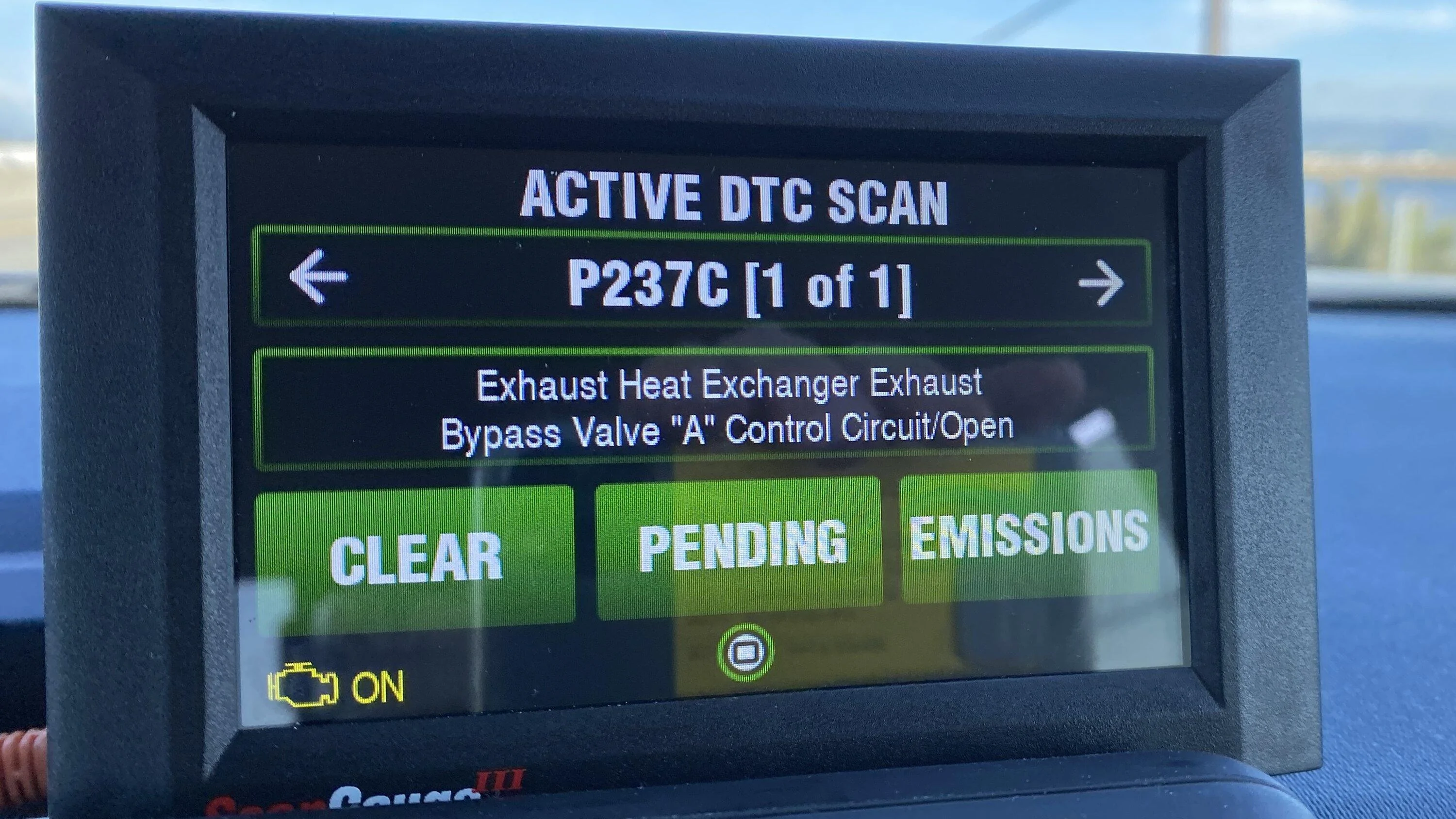

Check engine light came on, read the codes and came back with P2C22. Light subsequently turned off before I was able to get into the dealer.
Finally dropped it off and they confirmed the stored code and replaced the heat exchanger. There is a service bulletin on it. https://ford.oemdtc.com/12704/2-5l-...37d-stored-in-the-pcm-2022-2023-ford-maverick
Took less than 24hrs to order and replace. The warranty cost for parts and labor was just over $1k.

I got the other variant a few days ago.
Went away on it's own after a couple of days.
If it's still stored, you should bring it in ASAP. Don't want to be stuck with it out of warranty.
