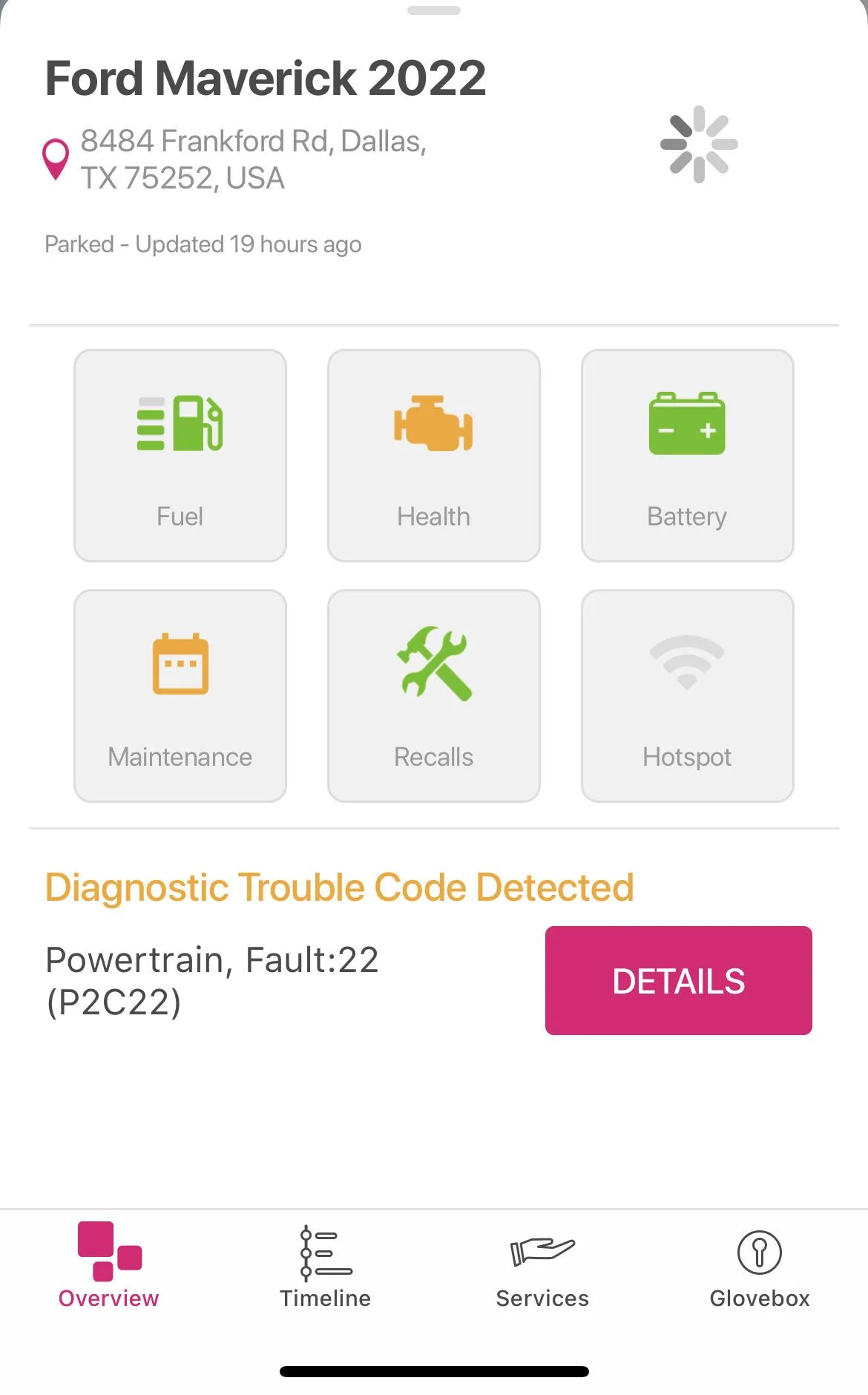

XLT Maverick Hybrid has been parked at Ford dealer waiting for a part since March 24. Originally serviced for same issue in Dec 22 - was a failed harness now told this heat exchanger near exhaust has issue with stuck valve.
I called Ford customer service last week and opened ticket - no update so far. Hopefully someone can clear this up soon. Bonus, hailstorm hit the dealer parking lot - so I'm going over tomorrow to check on it overall.
Starting to look at other trucks now for a replacement.
