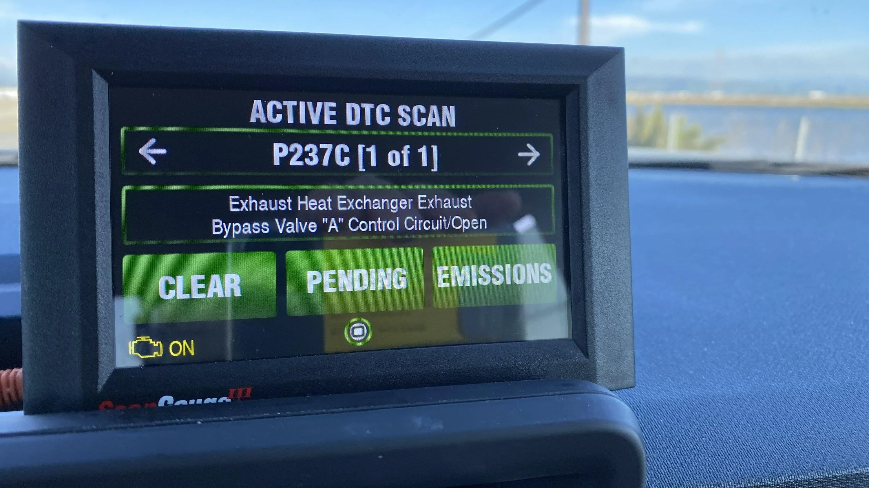

I got this three days ago:
Ford Maverick Ford Maverick P2C22 (Heat Exchanger?) Engine Light - Safe To Drive? IMG_9885
Note: The heat exchanger takes heat from the tailpipe to help warm of the engine coolant faster. It is not for cooling the battery as theorized in the first few posts.
Safe to drive? YES
Three days later the code and yellow check engine light went away by itself.
