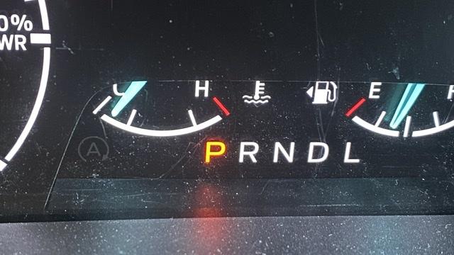

Just coming off the C = 120°F
First Tic Mark = 155°F
A little less than vertical = 185°F
30 minutes of slow speed city (all under 40 MPH) with lots of EV, this photo: on a +40 degree day.
The other reason the engine temperature is low is because it is not even running half the time. If you were going 80mph on the highway for an hour, the temp will be higher because then the gas engine will run all the time.
