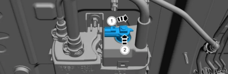

2.0L Additional EVAP Valves:
Evaporative Emission (EVAP) Vapor Blocking Valve
The EVAP vapor blocking valve (VBV) is a normally open valve, electrically closed by the PCM, to isolate the fuel tank from the rest of the EVAP system.
The EVAP vapor blocking valve (VBV) will automatically open to relieve excess pressure or vacuum, in the fuel tank, if the pressure or vacuum reaches a maximum calibrated value.
• Evaporative Emission (EVAP) Canister Vent Valve
The EVAP canister vent valve (located in the EVAP canister dust box) is part of the enhanced EVAP system controlled by the PCM.
During the EVAP leak check monitor, the EVAP canister vent valve seals the EVAP canister from the atmospheric pressure.
This allows the EVAP purge valve to achieve the target vacuum in the fuel tank during the EVAP leak check monitor.
• The EVAP canister vent valve seals the EVAP system from the atmosphere.
It is closed by the PCM (100% duty cycle) to allow the EVAP purge valve to achieve the target vacuum on the fuel tank
Evaporative Emission Canister Vent Solenoid
Disconnect the EVAP canister vent solenoid electrical connector.
Ford Maverick P0446 Emissions Code 1757975970202-d
Rotate the EVAP canister vent solenoid clockwise.
Remove the EVAP canister vent solenoid.
Ford Maverick P0446 Emissions Code 1757976035517-ts
