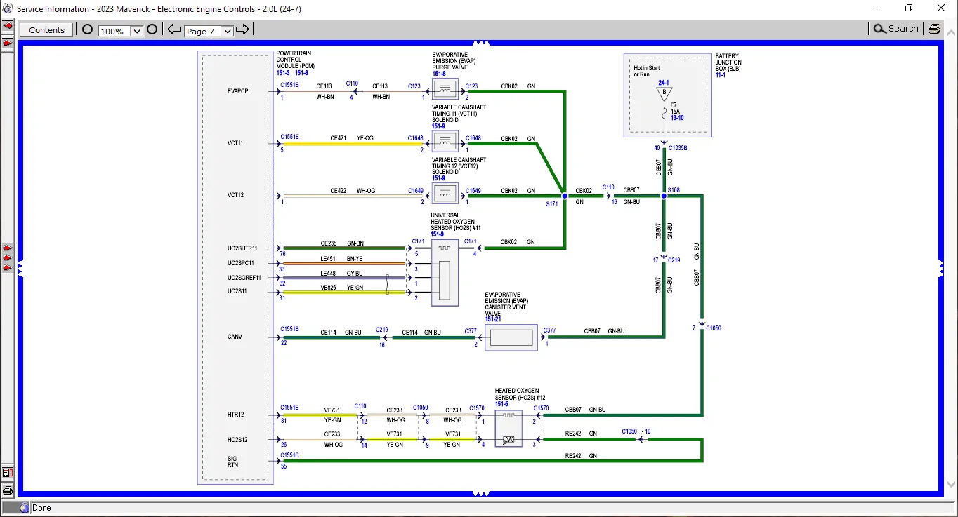

Do not put 12V on the control side of the circuit or you'll damage the PCM
The PCM controls the vent solenoid by grounding the circuit, It's called ground side switching.
It's (PCM) is looking for 12V on the control side with the solenoid acting a current limiter, if it doesn't see 12V -P0446.
I would start removing the insulating tape at the connector & looking for any signs of green corrosion
