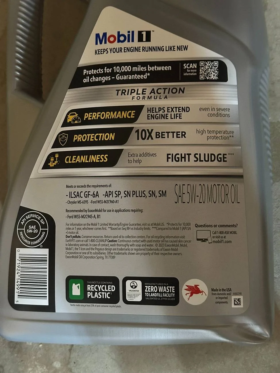

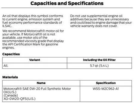

I have a 5 qt jug of Mobil 1 Full Synthetic and the specs do not match what the Ford Specification show, WSS-M2C962-A1.
Mobil 1 is showing 'Ford WSS-M2C960-A1.
I also add a quart of Lucas Oil Stabilizer when I do the 5,000 mile oil change.
Any reason why I should or should not use this since i bought it over a year ago?
Thanks
Ford Maverick OIL Change Discrepancy OIL_Cap&Spec
EDIT- I guess this Spec is not for the 2.0 EcoBoost. Put the wrong picture.
Ford Maverick OIL Change Discrepancy Moble1

A) That oil DOES meet Ford spec for quality
B) YOU purchased a jug of 5w-20. Your manual states 0w-20. That is the difference in the code.
You will be fine down to sub zero with what you have. No need to worry.
Wait... do you have a Hybrid or EcoBoost?
There are different pages in the book and different oil weights for each. But the "quality" of the oil is the same either way.
The Maverick has the EcoBoost in it.
Good, I am going to do next oil change with that then.
Thanks
