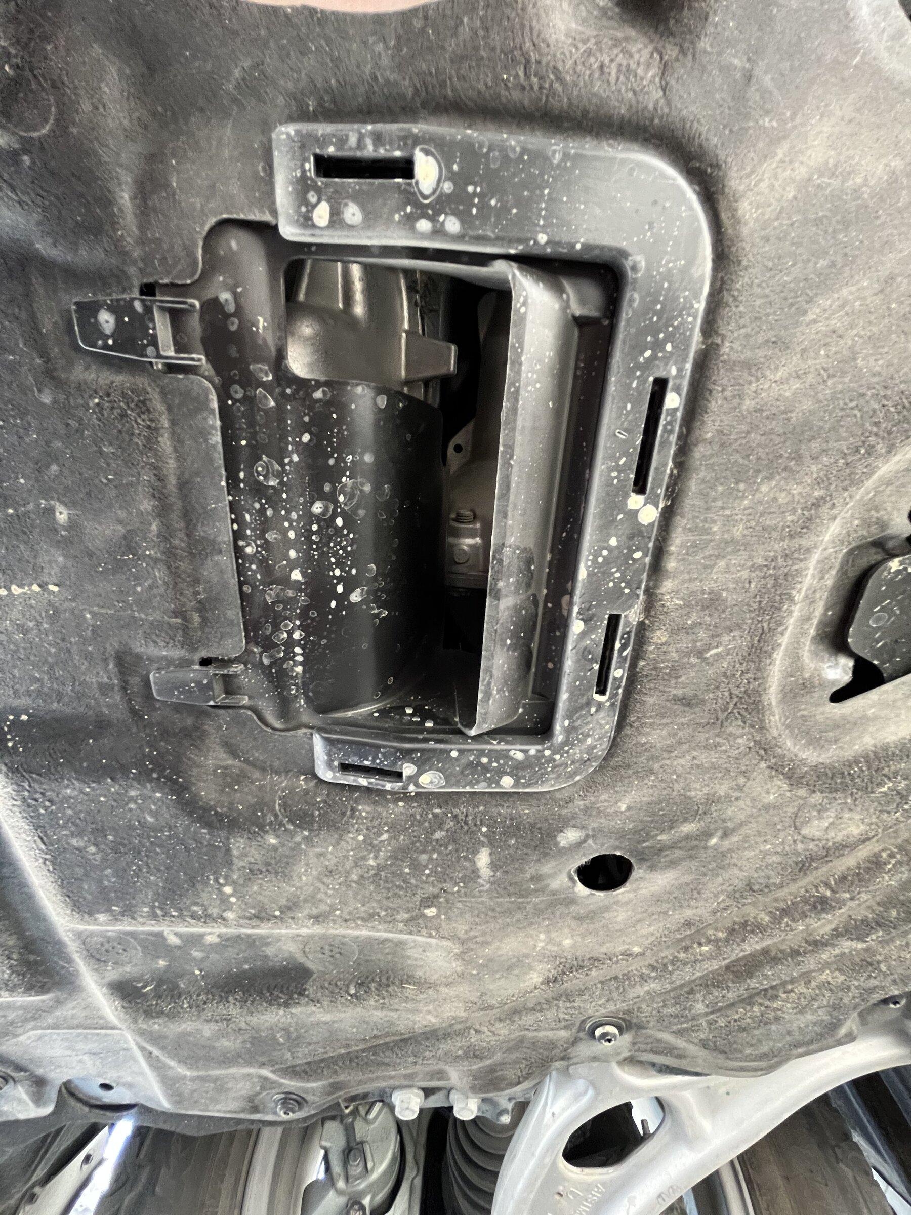

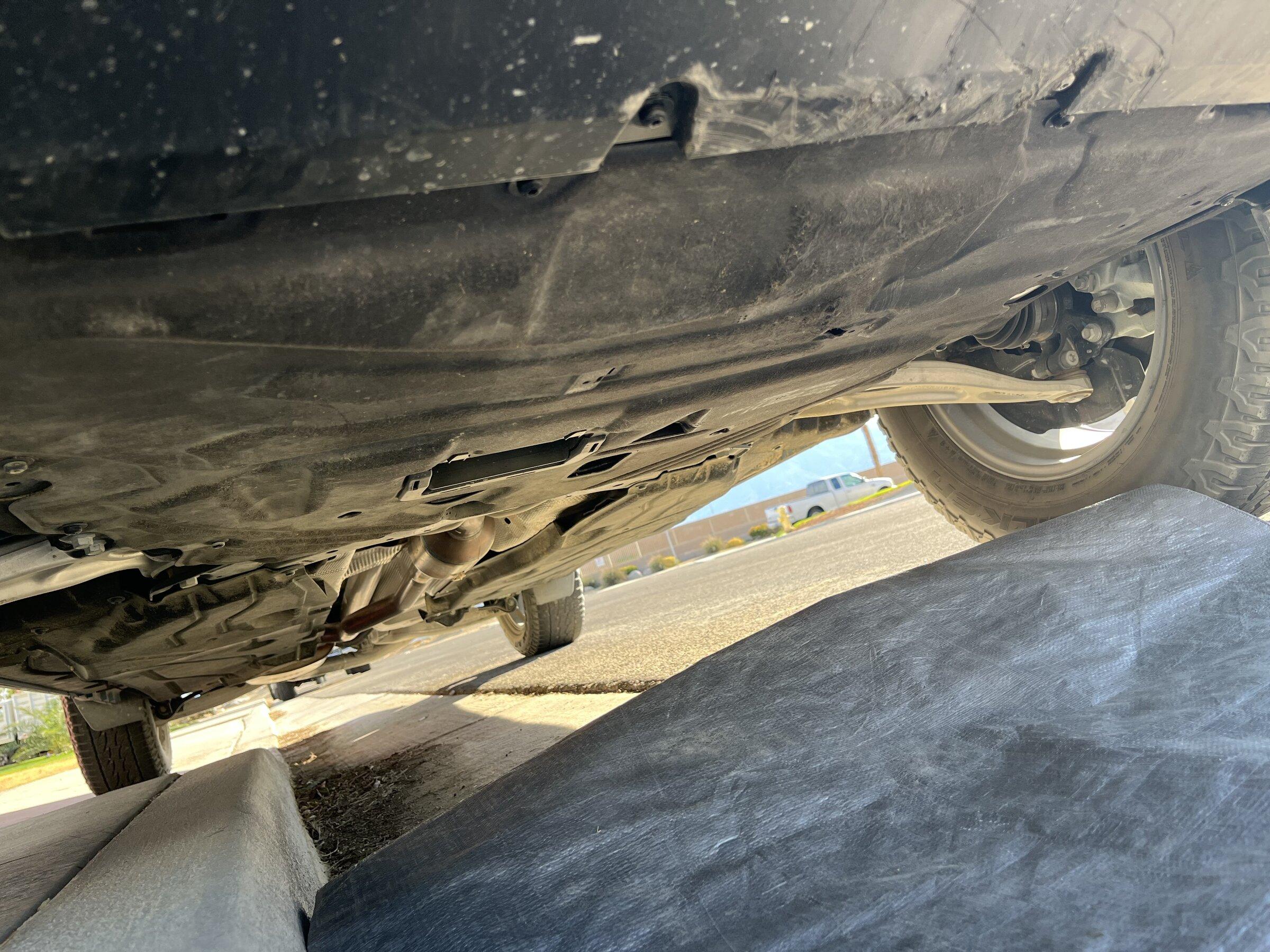

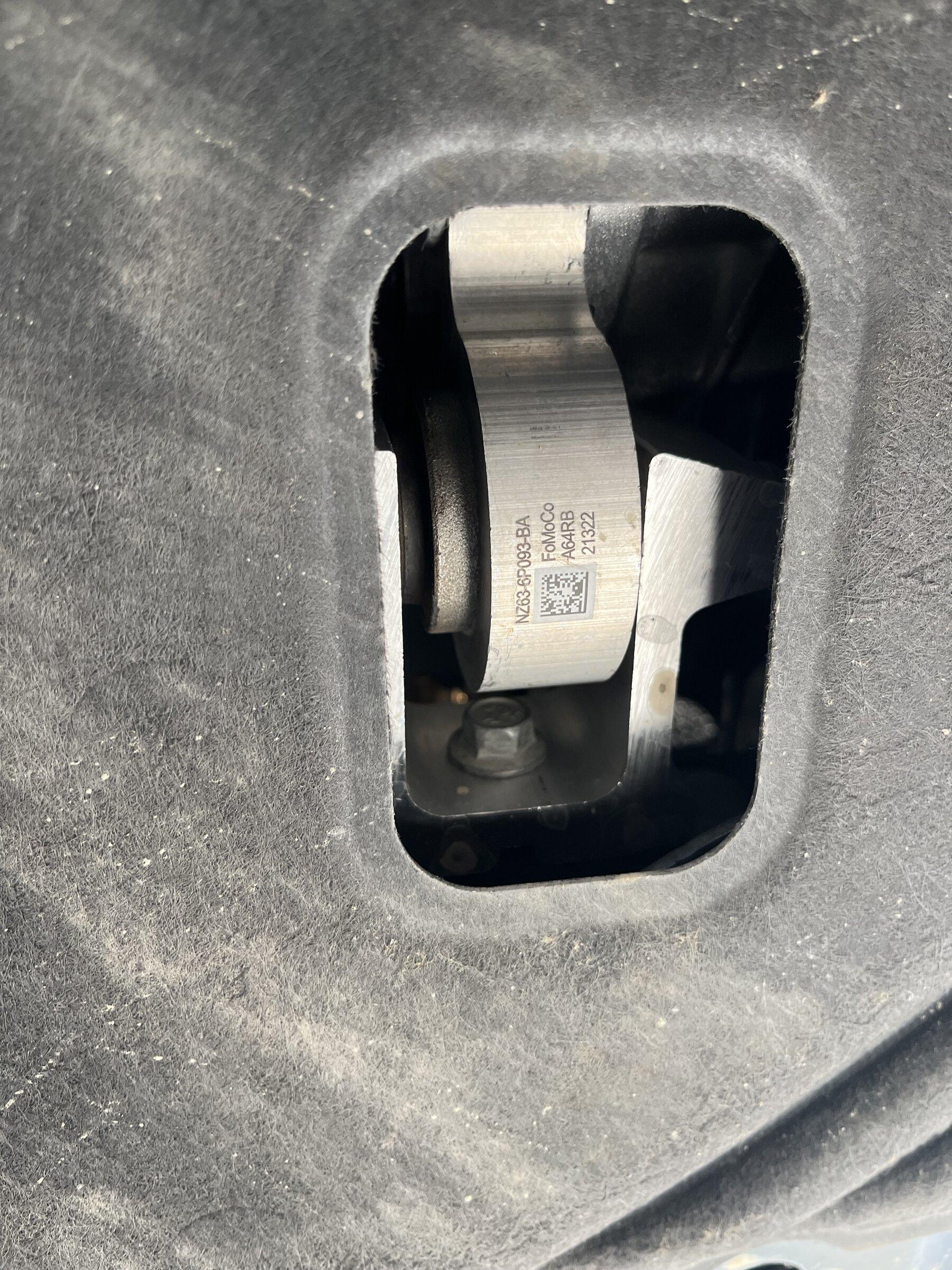

Has anyone done an oil change yet? I read in another post that if you have an FX4 that you need to take off the skid plate to do an oil change; there is no access panel, opening, etc.
I crawled under the Mav today to see what the openings are on my XL "felt skid plate". If you have not seen it yet, its a felt-like material that covers the underside of the engine area. It seems to be the same fuzzy material that you will see in the wheel wells.
Looks like the felt cover will be to be removed for an oil change, just like on the FX4. I counted about 18 screws that need to be removed to do this.
Looking at it has given me an idea: That "felt skid plate" could serve as a template for someone that wants to fabricate a skid plate for their Maverick. :unsure:

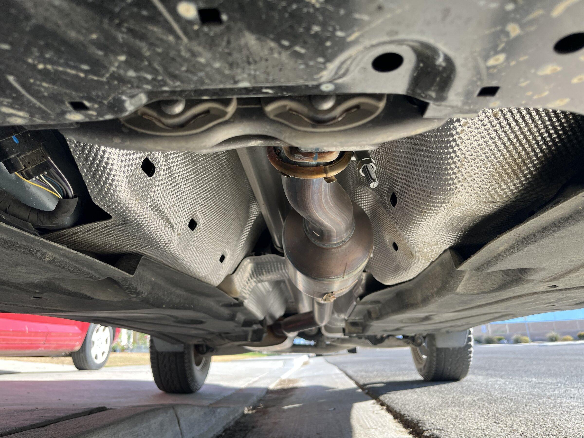

Photos attached. Threw in a pic of the exhaust just because I was down there anyway.

I know it's been mentioned here but nothing to worry about cat converter theft. It's way up there between the engine and fire wall.
