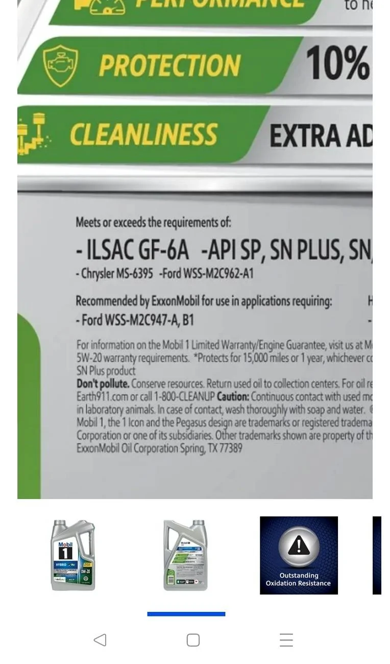

There some 0W-20 full synthetics that don't meet Ford WS-M2C963-A1 specs. Oddly enough Mobil 1 Hybrid 0W-20 does not meet the spec, but their Extended performance does
https://www.mobil.com/en/lubricants/for-personal-vehicles/our-products/products/mobil-1-hybrid-0w-20

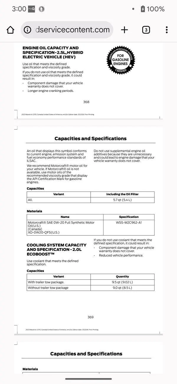

Yes it does.

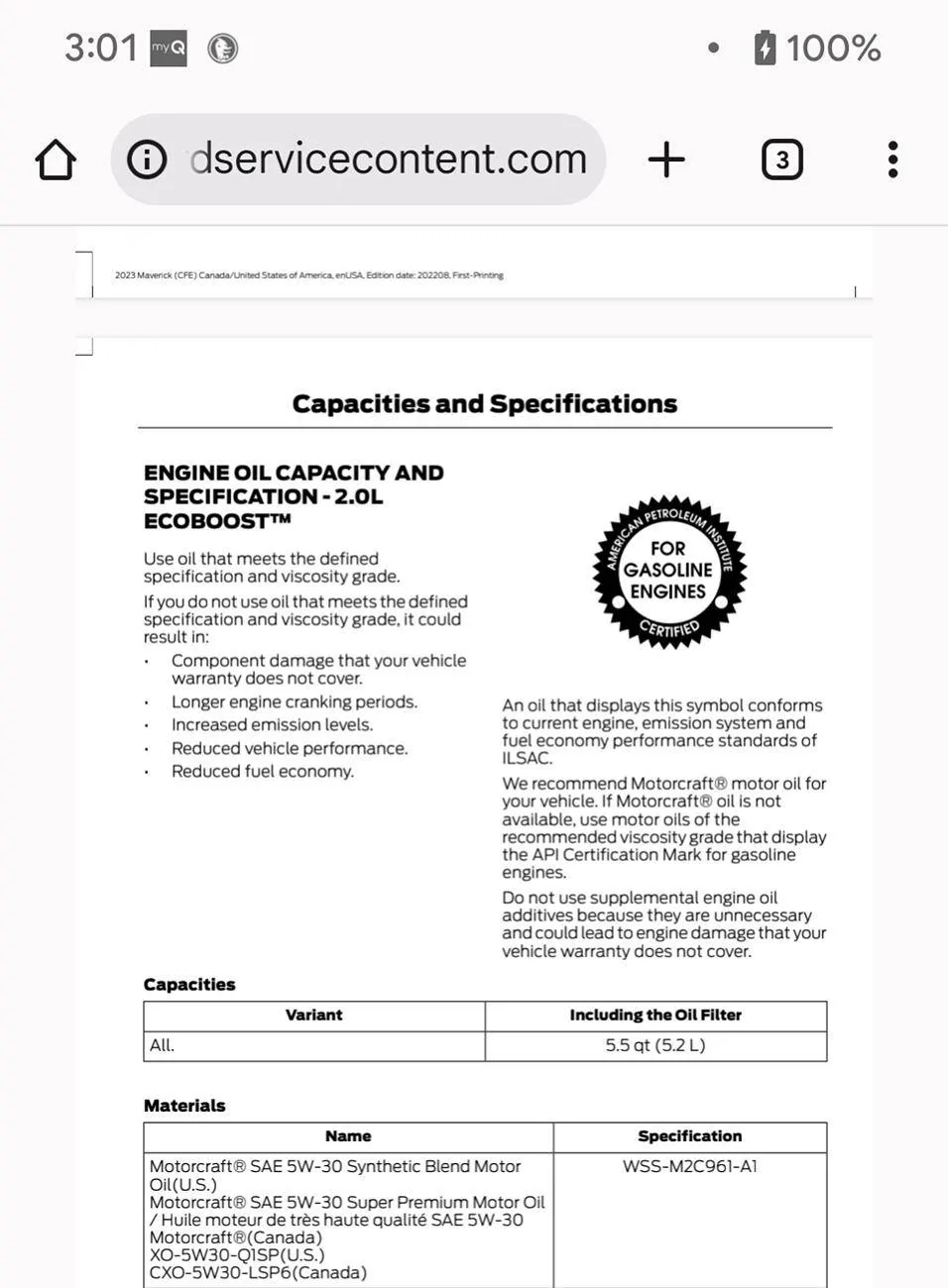

96 2 - A1.
Not 3.
Post above from PDF manual. This from online manual.
Materials
NameSpecification
Motorcraft® SAE 0W-20 Motor Oil
XO-0W20-QFS
WSS-M2C962-A1

Yes it does.
96 2 - A1.
Not 3.
Materials
NameSpecification
XO-0W20-QFS
WSS-M2C962-A1
I know the Motorcraft does meet the spec, my point was for those who do their own oil changes don't assume every 0-20 does
My point was - The one you specifically called out as not meeting spec, does meet spec.
You have the wrong spec. Reread 2 posts in this thread and your manual.

Wrong spec for 0W-20 synthetic for a hybrid. Ford spec for their hybrid is WSS-M2C962-A1, not what you posted. Ford has different specs for different vehicles, synthetic and blends as well as viscosities. The Ecoboost and the hybrid have different oil specs..

YOU misread another post correcting you on the Mobile 1 Hybrid oil, which clearly states the correct Spec. Or you are not reading the whole list of specs in that picture of the bottle. Read a little closer.

Except Mobile 1 Hybrid does meet the spec though.
