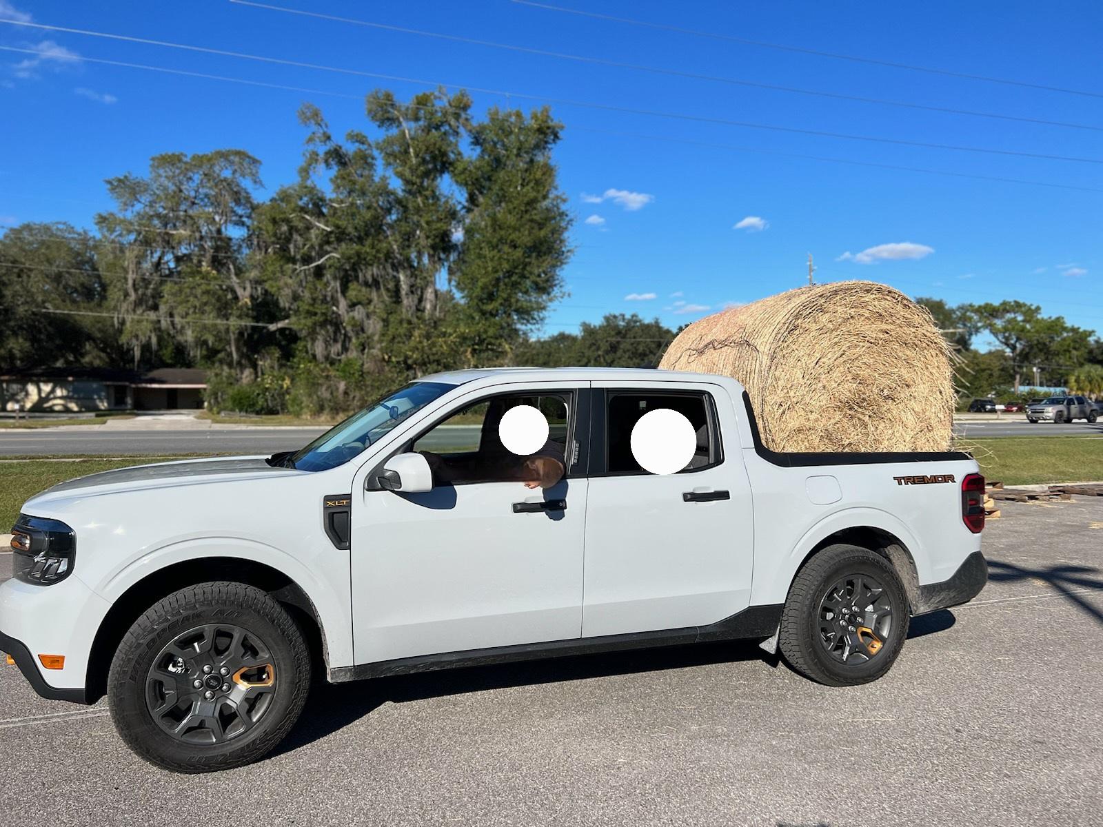

I had a 2022 maverick the totaled it when I hit a deer before Christmas. It should not have been totaled. Because of ETA of parts and having to out source they decided to total it. I was getting around 26 to 29 MPG driving about 100 miles a day going to work.
I now bought a 2023 tremor because the only thing I really wanted from my original maverick was not AWD. So when I found a Grey AWD tremor said why not.
With the tremor driving the same 100 miles it's about the same MPG if any change I would say maybe more around the 26 to 27 mpg. With that said I have alot more bang for my buck with the tremor over my other maverick. Either way I love my truck and I use it all the time even turn heads with what I do with it. Yes this is a weekly trip I make in my truck to get hay with my daughter. The bang for the dollar and all the things you can do in this truck is insane plus when you put 30k a year on a truck my first one held up just fine.

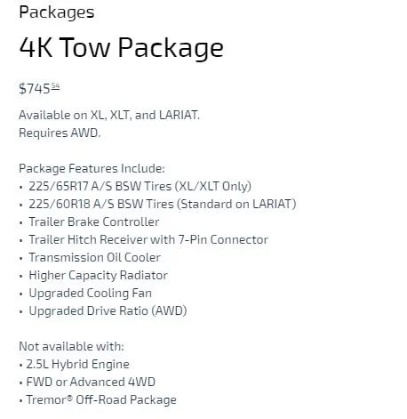

The Tremor has a locking rear differential. 1" lift. Stronger CV joints. Different suspension with hydraulic bump stops. Water cooled PTU. Also the Tremor has better approach, departure and breakover angles. These are the main mechanical differences from the FX4 with 4k.
There are also some appearance differences.
4K tow also gives you some hardware advantages over Tremor & the ability to get BAP.

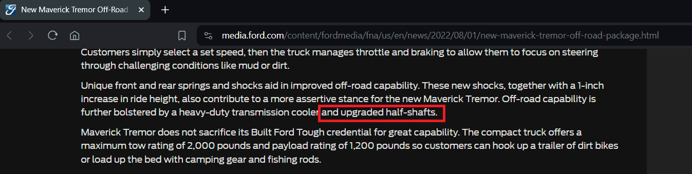

Nice. I wonder if the Tremors are having less issues with the factory CV's due to this?
Well it is a big deal if your towing. I have an 1800lb 2 bike trailer and when loaded with 2 motorcycles @approx 700lbs each now I'm up to 3200lbs which my Maverick handles very well. Along with the towing, I have a heavier rear suspension, the bigger tires and wheels, and cooling system which adds to the durability and performance of the vehicle. Also, I own an F350 which will pretty much tow anything.
Keep in mind there are habitual line steppers here on the forums when it comes to towing. Pushing the limits is not smart, and there are even threads where they admit to being over them or loaded improperly basically saying "I've done this for years" etc etc...
It's all fun and games until ones insurance company gets involved wondering why they were towing over the limit and what caused the accident...
710-oil-614
Cal
Oct 13, 2021
6,133
12,083
2025 Hybrid AWD Lariat
Haven't seen any Tremors report issues with them but the Tremor sample size is much smaller. They don't look much beefier than stock and Ford is relatively coy about what upgraded actually means.
