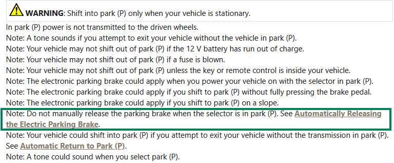

I know the discussion has been focused on the Parking Brake being set and the recall relating to the Integrated Park Pawl (IPM) module for 25-26 Hybrids, however now I find from reading the list of Notes that releasing the parking brake should be done in a specific manner as shown below. I guess I will stop releasing the Parking Brake (P) manually and begin the habit of using the Automatic Release method (accelerate forward/or backwards), or I could just move the selector from Park to Neutral and manually release the Parking Brake in that position.
Ford Maverick Notice of Recall 1771343103804-8h
Automatically Releasing the Electric Parking Brake
  1. Close the driver door.
  2. Shift into gear.
  3. Press the accelerator pedal and pull away in a normal manner.

I know the discussion has been focused on the Parking Brake being set and the Recall etc, however now I find from reading the list of Notes that releasing the parking brake should be done in a specific manner as shown below. I guess I will stop releasing the Parking Brake (P) manually and begin the habit of using the Automatic Release method (accelerate forward), or I could just move the selector from Park to Neutral and release the Parking Brake there if I did not want to pull forward yet.
  2. Shift into gear.
That's news to me. I've always manually released it on every Ford with an electric brake I've ever had (four of 'em).

I know the discussion has been focused on the Parking Brake being set and the Recall etc, however now I find from reading the list of Notes that releasing the parking brake should be done in a specific manner as shown below. I guess I will stop releasing the Parking Brake (P) manually and begin the habit of using the Automatic Release method (accelerate forward), or I could just move the selector from Park to Neutral and manually release the Parking Brake there if I do not want to pull forward yet.
  2. Shift into gear.
Pretty sure that is in there because people not thinking about it would defeat the whole purpose of using the EPB before taking foot off brake to save the parking pawl.
That Note is to keep people from getting in, starting, foot off brake, release EPB - and bang against the pawl.
And if that engagement wasn't complete as the recall seems to be for, rolling.
So instead - just start, foot on brake shift into R or D as normal - and either manually release EPB or gently press gas to overpower and release it.

To answer your specific question about the brake "randomly" applying - is it in these situations?
PARK (P)
Ford Maverick Notice of Recall Screenshot_2026-02-17-17-55-09-33_40deb401b9ffe8e1df2f1cc5ba480b12
WARNING: Shift into park (P) only when your vehicle is stationary.
In park (P) power is not transmitted to the driven wheels.
Note: A tone sounds if you attempt to exit your vehicle without the vehicle in park (P).
Note: Your vehicle may not shift out of park (P) if the 12 V battery has run out of charge.
Note: Your vehicle may not shift out of park (P) if a fuse is blown.
Note: Your vehicle may not shift out of park (P) unless the key or remote control is inside your vehicle.
Note: The electronic parking brake could apply when you power your vehicle on with the selector in park (P).
Note: The electronic parking brake could apply if you shift to park (P) without fully pressing the brake pedal.
Note: The electronic parking brake could apply if you shift to park (P) on a slope.
Note: Do not manually release the parking brake when the selector is in park (P). See Automatically Releasing the Electric Parking Brake.
Note: Your vehicle could shift into park (P) if you attempt to exit your vehicle without the transmission in park (P). See Automatic Return to Park (P).
Note: A tone could sound when you select park (P).
