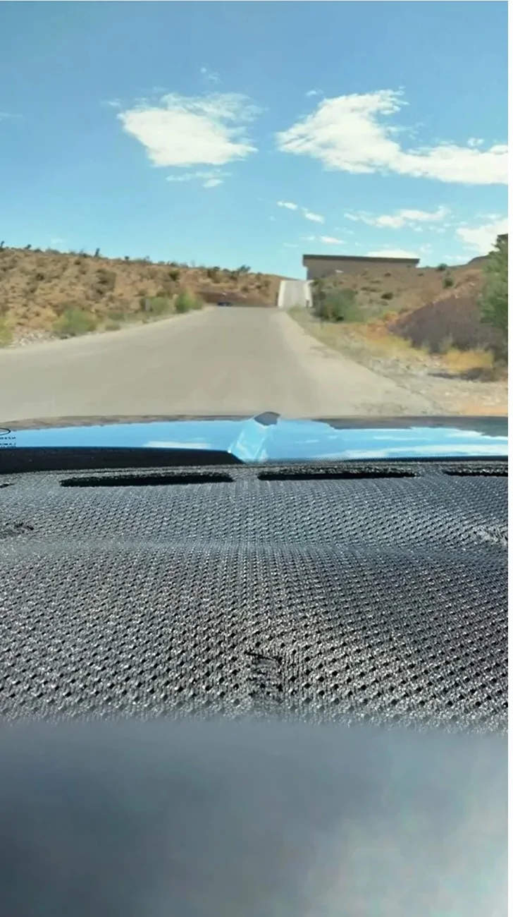

I know on my 2023 whether on an incline or not my parking brake will not automatically set🤷‍♂️
My video shows about an 8 degree incline me shifting from drive to Park opening the door and it never automatically applied the parking brake.

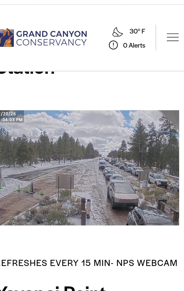

Actually more snow in AZ is a good thing, as we're in a drought.
The head behind the rear wheel in the snow automatic parking brake test.. Not so much.

Auto engage parking brake must be a 2025 feature.
It doesn't Auto engage on my 2023.
Backward or forward.
Not even on this incline
Must be a 2025 Hybrid “feature” as my 2025 EB only sets when I pull the lever up. I’ve checked & double checked.
I always (almost) set my parking brake myself - as it should be.
If I forget (rarely), my poor truck will move a bit until resting on whatever it rests on…
Edit - auto setting of the parking brake is not a “feature” on EB or Hybrids of any year. My mistake!

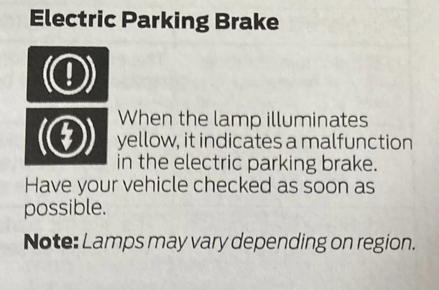

BTW, there is a dash warning light for parking brake issues. My 25 EB lights up for a second in the upper right hand corner of dash during the startup self check routine…
