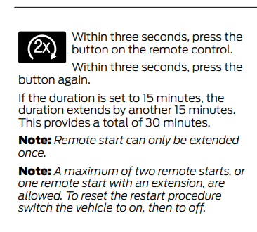

but gotta also comment with a minor correction. 15 minutes is the standard remote start timer. And you can hit one button to extend it another 15 for a total of 30 minutes.

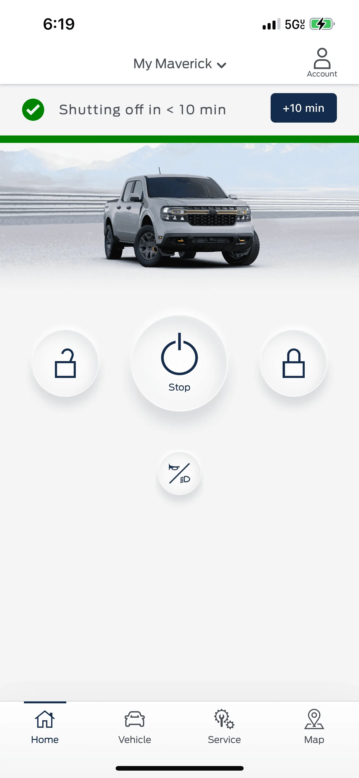

No shit? Is there an option/setting where you can change it to 15min with +15?
My Tremor defaults to 10 min with the ability to +10 min and I haven't found anything in Ford Pass to change it.
Do you have a screenshot of yours?
Ford Maverick No HVAC for Fordpass remote start? IMG_5584
Ford indicates its 15/30 max too. I would like to default the time to 15 if possible that would be better than the 10.
Ford Maverick No HVAC for Fordpass remote start? 1705667248139
Mine is, or was, 15 min by default with the app. I haven't noticed if it's changed.
The fob remote start could have a different setting from the app, though.

Screenshot was from the app when starting from the app.
I also have the remote start through the fob and have observed the 10 min shut off.
Of course the screenshot was from the app; I just meant a 15-min reference to the fob remote start in the owner's manual didn't necessarily mean such an option existed on the app.
What is it set to in the vehicle itself? On the IC display Menu > Settings > Vehicle > Remote Start > Duration can be set to 5, 10, or 15 minutes.
