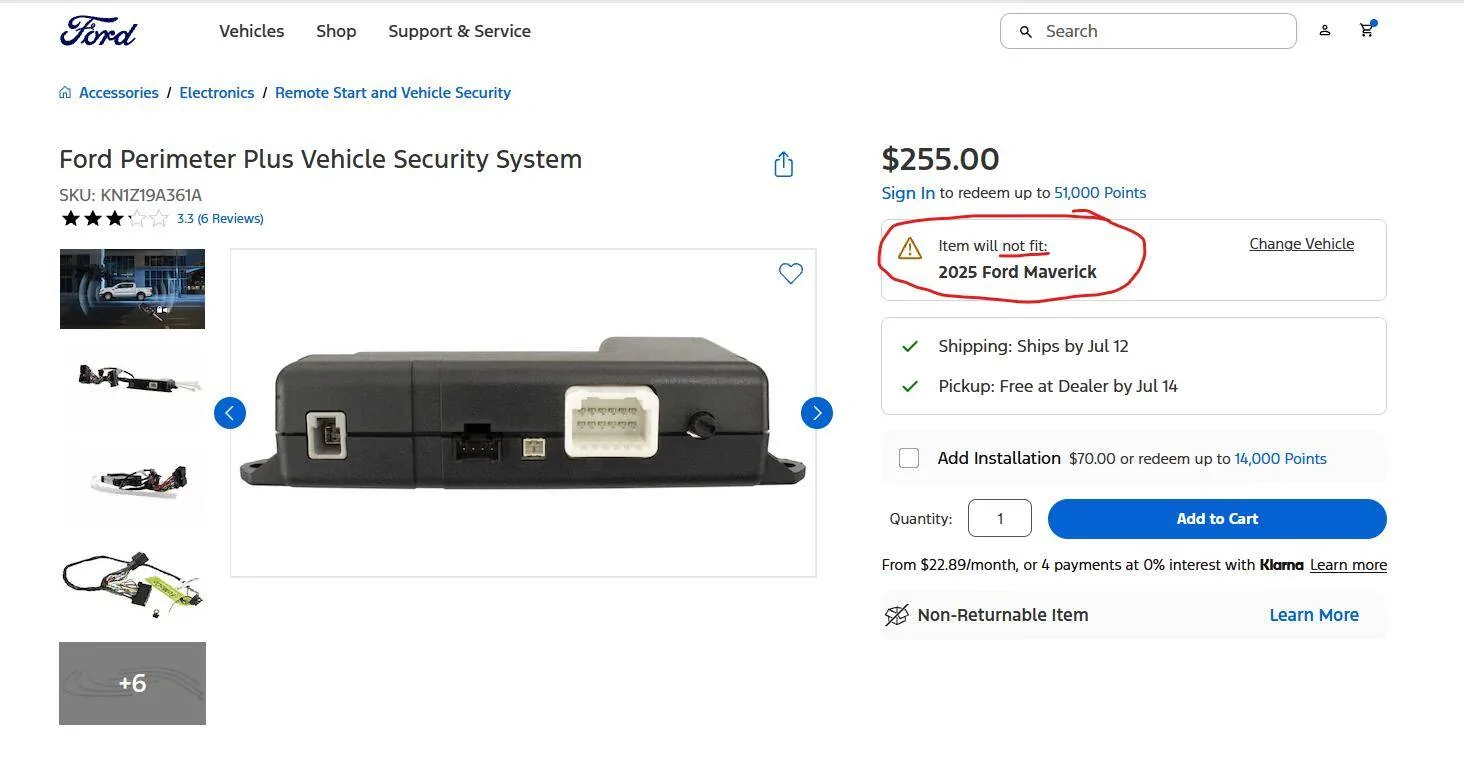

Anyone know of an aftermarket remote start that will work with the original key fob for the 2025 MAVERICK XLT 2.5L HYBRID?
Had a 2024 straight up gas 2.0, Start-X worked fine, but the hybrid has a totally different OBD 2

Thank Will, but different OBD 2

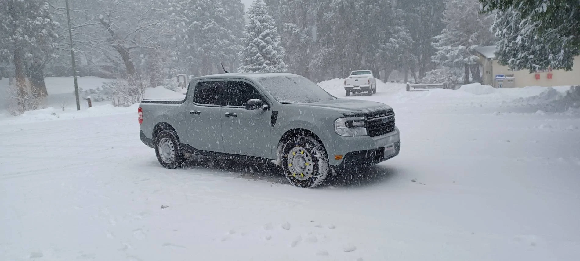

Yes, as I bought the vehicle between summer and winter when I would not use it. The first winter here I was glad I could warm up the steering wheel and seats.
Booyah 👊🏽 😁 👍🏽 🇺🇸
That's what I'm talking about

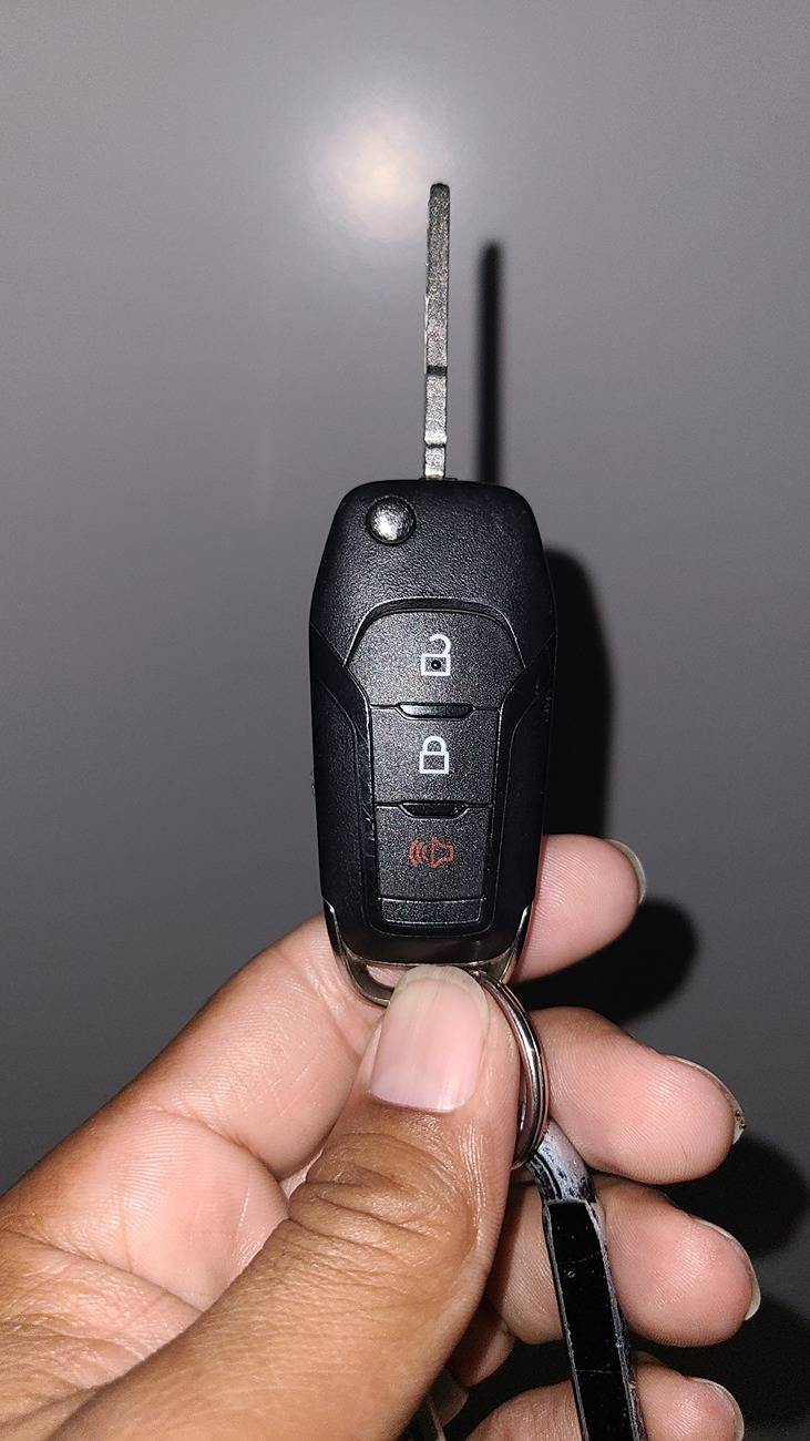

Perimeter security plus, allows you to use your factory key fobs. No extra fobs. It works on XL, XLT and Lariat.
It works by pushing lock unlock lock on the regular fob, it will start. Then unlock lock unlock to turn it off.
I have experience with XL Hybrid, XLT and Tremor models and both gas and Hybrid models of Maverick.

I looked and this supposedly works with 2025 XLT hybrid BUT it says the perimeter plus must be installed. So maybe there is a 2025 version of that module?
https://parts.southlakeford.com/p/F...-Button-Fob-2-Pack/133673752/JS7Z15K601C.html

No extra buttons needed it uses the factory fob. With button pushes to activate and de activate remote start.
Start - lock unlock lock
Turn off - unlock lock unlock
Perimeter security plus does have to be installed. Programmed and on the hybrid there's a jumper word necessary.

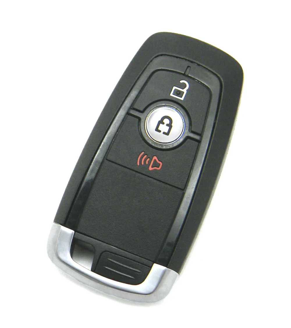

Thanks again AutobahnSHO
But I'm looking for one that works with the original key fob, Please see PIC..
