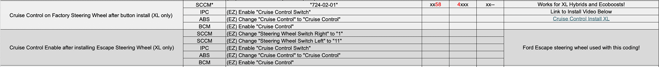

I have a basic XL. Just had recall done and now no cruise. Knowing XL no CC. I had a guy for scan. And need to got the codes again
One of these two depending on how it was done.
Only the BCM coding was likely reset.
So I would just try enabling cruise control in the BCM and see if that fixes it.
So do the dealerships have forscan that they could reset my Escape wheel BCM back to "Enable Cruise Control"?
