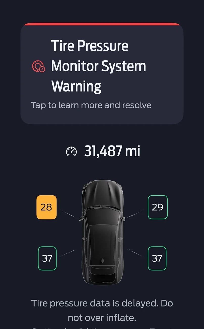

Final Update:
The service guys finally took it out and test drove it on the highway. I was sitting in the waiting area and my FordPass app pings that the tires just went low 🤣
Ford Maverick New Tires Lose Pressure at Speeds Greater than 60 mph IMG_2577
They finally agree there is a defect and replaced the two tires under warranty. They were all saying as well how they’ve never seen something like this before.
Thanks all—It’s been an adventure.
