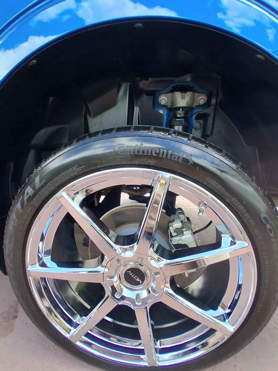

My 20" Continentals are might smoother than factory Continentals. Factory ones had 1 ply sidewall, disliked that.
