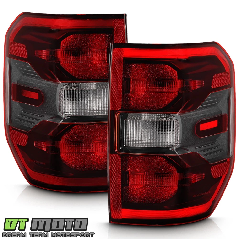

These look great, for sure, but you got rid of the LED signature lighting from the stock Lobo tails by going to these fully halogen units.
Your stock tails certainly had this LED bar on the perimeter and in the middle of the light, which the fully halogen units do not have.

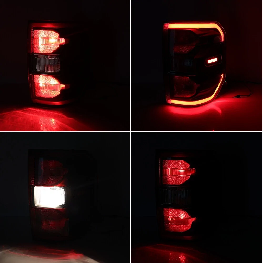

Upper right corner shows the LED bars that your stock tails have. These are on with the bulbs unless you modify the bulbs to only illuminate at full power, like many of us have done.
I wish the seller would make the LED signature lighting version with these gray/clear lens.
You are absolutely correct. When I pulled out the stock taillights I noticed the 4th plug which was an LED. Then pulling out the new taillight assemblies it did not even have a spot for that 4th light.
I was then at a "ah crap" moment deciding if I was going to send them back. Nope.. I like them to
much. :)
