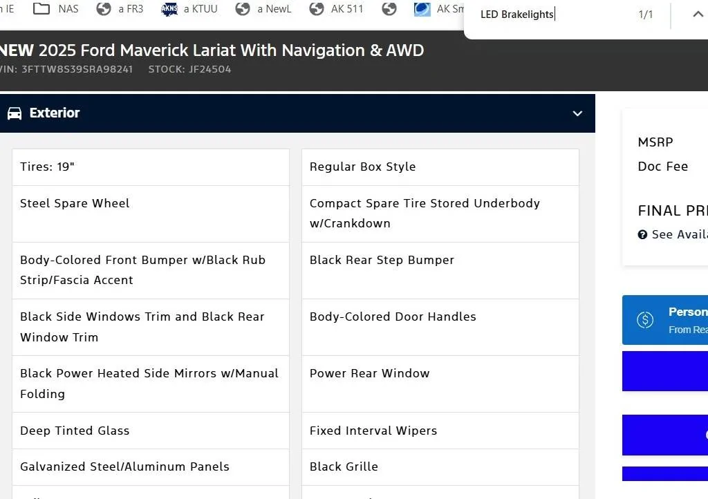

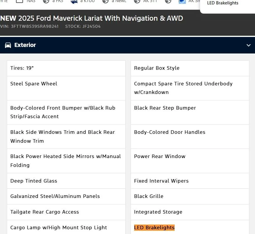

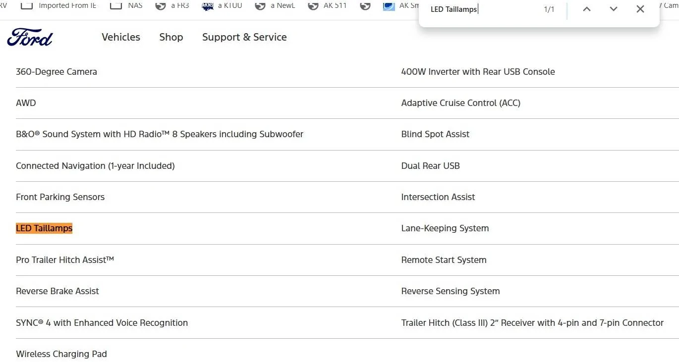

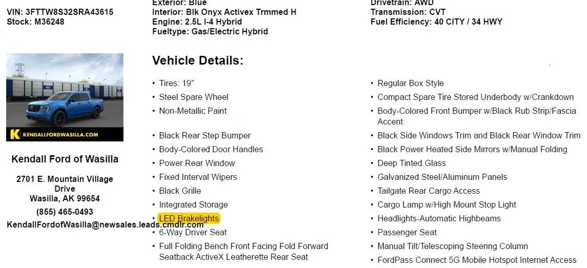

My face is RED, My rear brake lights are not LED. I checked while installing the Lasfit Backup Light Bulbs T3-WT21W. All four are Halogen.
Maverick LARIAT:
Ford website says "LED Taillamps."
Ford Maverick New LED bulbs From Lasfit to fit Maverick Ford website Maverick LARIAT
Dealer website says "LED Brakelights."
Ford Maverick New LED bulbs From Lasfit to fit Maverick Dealer website Maverick LARIAT
From my 2025 Ford Maverick Lariat Dealer website printout:
Ford Maverick New LED bulbs From Lasfit to fit Maverick Dealer website My Maverick LARIAT
I will be talking to my dealer on Monday.
I found out my 2025 Ford Maverick Lariat has LED Brake lights. LED Brake lights are standard on the 2025 Ford Maverick High series.
Hmmm, I know I changed my brake lights on my 2025 (produced in December 2025) Maverick Lariat Hybrid. Mine was an early build, though. Things can change.
They were halogen of the "least expensive order".
Now my led brake lights work great with the led pulsing 3rd brake light on the back of the cab (where it strobes 3 or 4 times and then stays on solid) when the brake is applied.
I do have the what other people call "hyper flashing" indicator in the cab. But I don't care about that, as I think that makes sure I don't forget to turn off the signal after a lane change!
If they do come out with good LED tail lights that don't set off the "bulb out hyper flash", I may consider them...but happy with what I have right now.
Now, if someone could make a good quality running/brake light for putting in the hitch receiver that would be great! All I could find are ones that also flash when a signal is selected.
Andy
