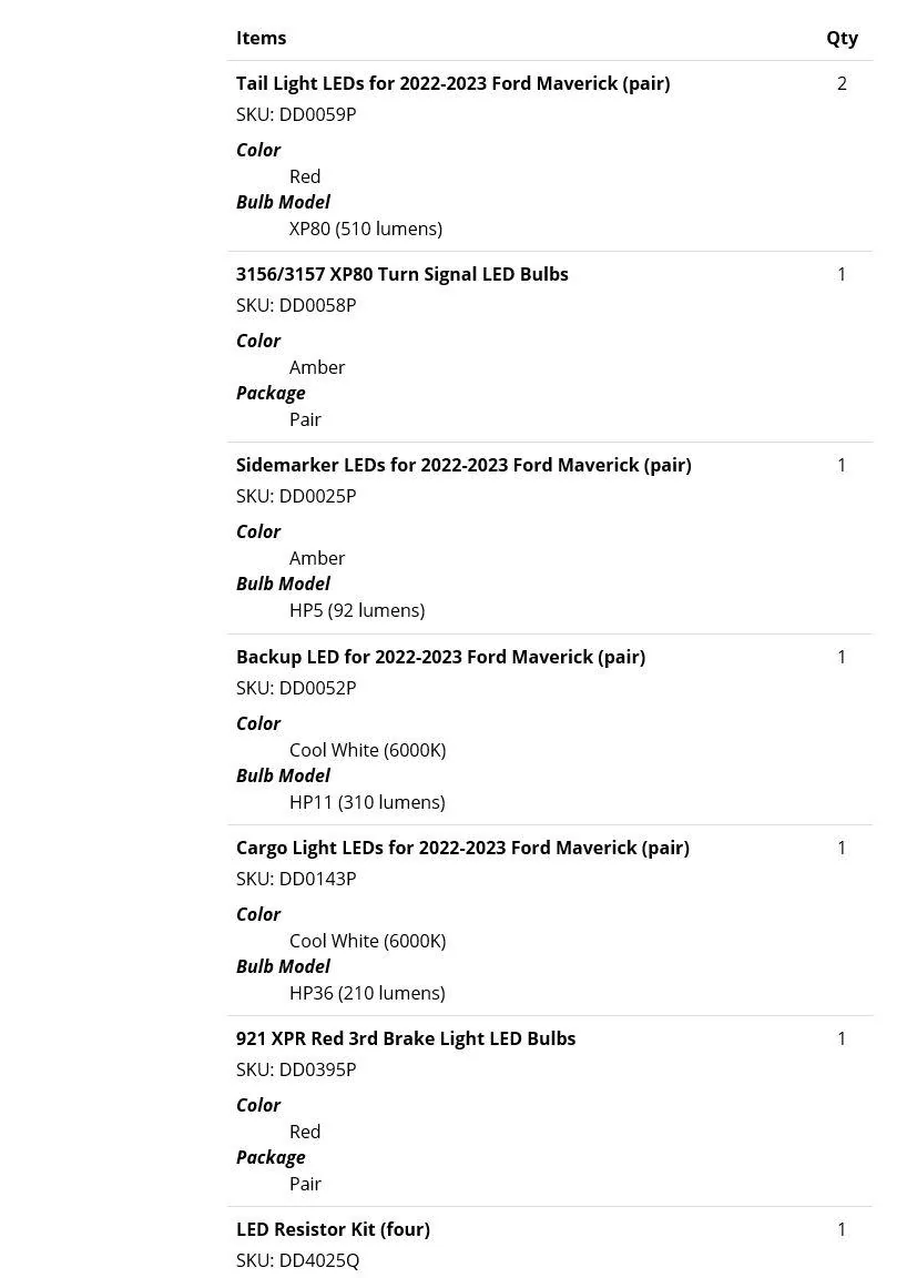

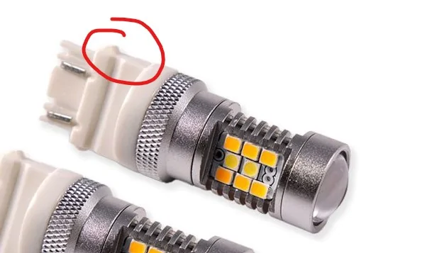

Here is what I used. Just be aware that you will need to shave of the little side tabs to use the DD bulbs in the rear tail light and front turn signal locations. I also had to add in the resistors to prevent the internal turn signal indicator from hyperflashing. The exterior bulbs were fine with no hyperflashing. No other fitment issues on our 24 Mav Lariat Hybrid.
