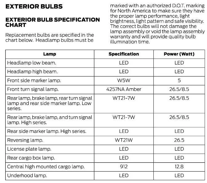

🤓 🤨. I’ve replaced my LASFIT taillights more than once. The last time they were supposed to to be like the latest and the greatest. I always kept my oem bulbs, but have missed placed them when I moved to OKLAHOMA. Now I just need to find the numbers for the OEM bulbs and I‘ll get the replacements, then put them in.
WT21-7W
From the 2025 Maverick users manual. (page 363)
Ford Maverick New LED bulbs From Lasfit to fit Maverick 1750788602341-y
Owner’s Manual Printing 2 (PDF)

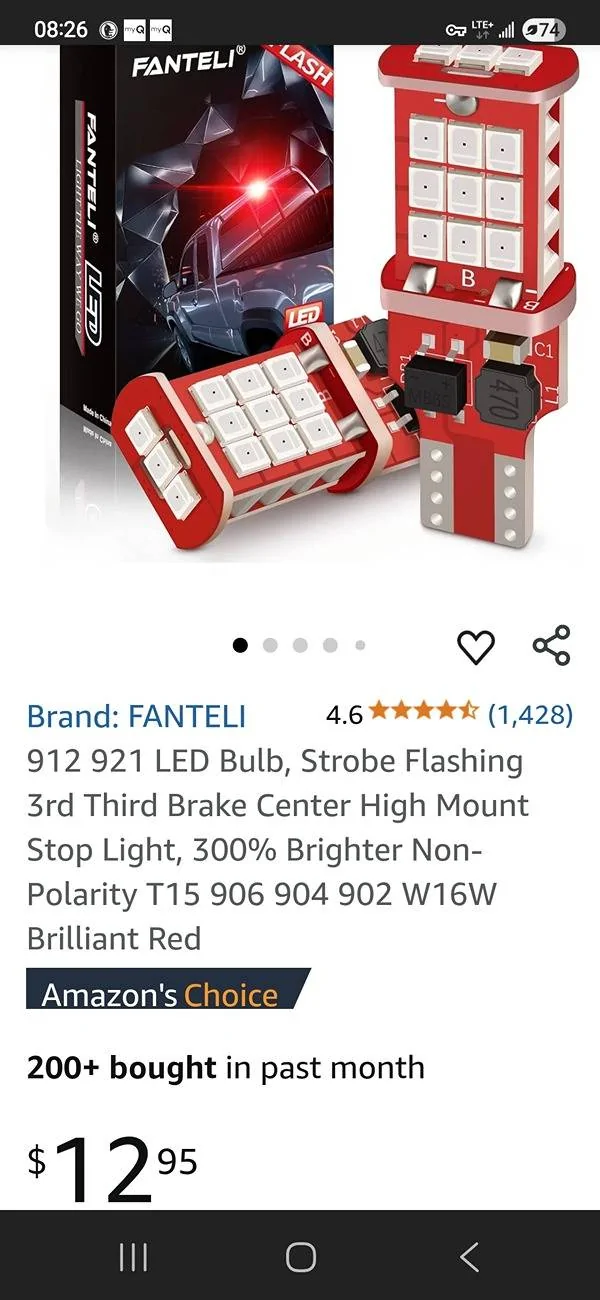

I just got these and replaced the 3rd light on our Mav (and the 2 high box lights as well...different bulb of course).
(I just edited this image, to indicate the STROBING 3rd brake light replacement.)
They come as a set of 2, but I only used one for the center overhead position and have a spare.
They fit properly, nothing to cut or modify...I like that, and things working right out of the box!
They Look and feel good quality as well. It says they dont fit our Mav, but i beg to differ...they do!
They look exactly the same as Glen Baker LLC's video shows. Several flashes and then steady on.
Cheers,
Andy
Amazon states they won't fit the Maverick because that strobe bulb is not considered an OEM replacement item. They're probably just being cautious about any misconceptions and/or lawsuits.

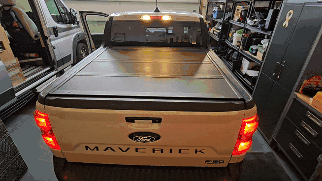

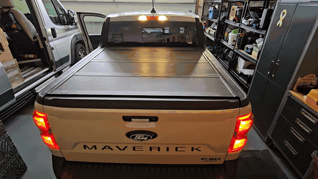

Good afternoon, @AutobahnSHO
So, I had checked, with my wife's assistance when I changed the rear LED brake lights and 3rd brake light, to make sure everything was working (I was going to add it in my previous post but was attempting to not write as much as I normally do).
Everything checked out.
But, you raised the question so we went back to the garage and we recorded the whole light test...and I then watched the video...so, I can now confirm in triplicate that the lights are all operating normally.
The only difference is that they are more visible now, and the hyper clicking on the cab in the truck is the only indication that there has been a change.
Here is a little example of the lights....I had to learn how to make a GIF.
Last note, when we pull our truck out for the first time every day, I do check that all my brake lights are coming as needed...running lights, brake lights and signal lights - I just watch for their reflection on the wall behind me (I always back into our garage...backing onto roadways is an unnecessary risk, even on our quiet street).
Now that I learned this new tool, I can go back to my close calls dash cam thread and actually try to add my videos to them, so, not a waste of time learning how to make GIFS and trim video's here!
Cheers,
Andy
Thanks for posting, Andy. As you can attest, all kinds of unintended consequences from reaching out to club members.
