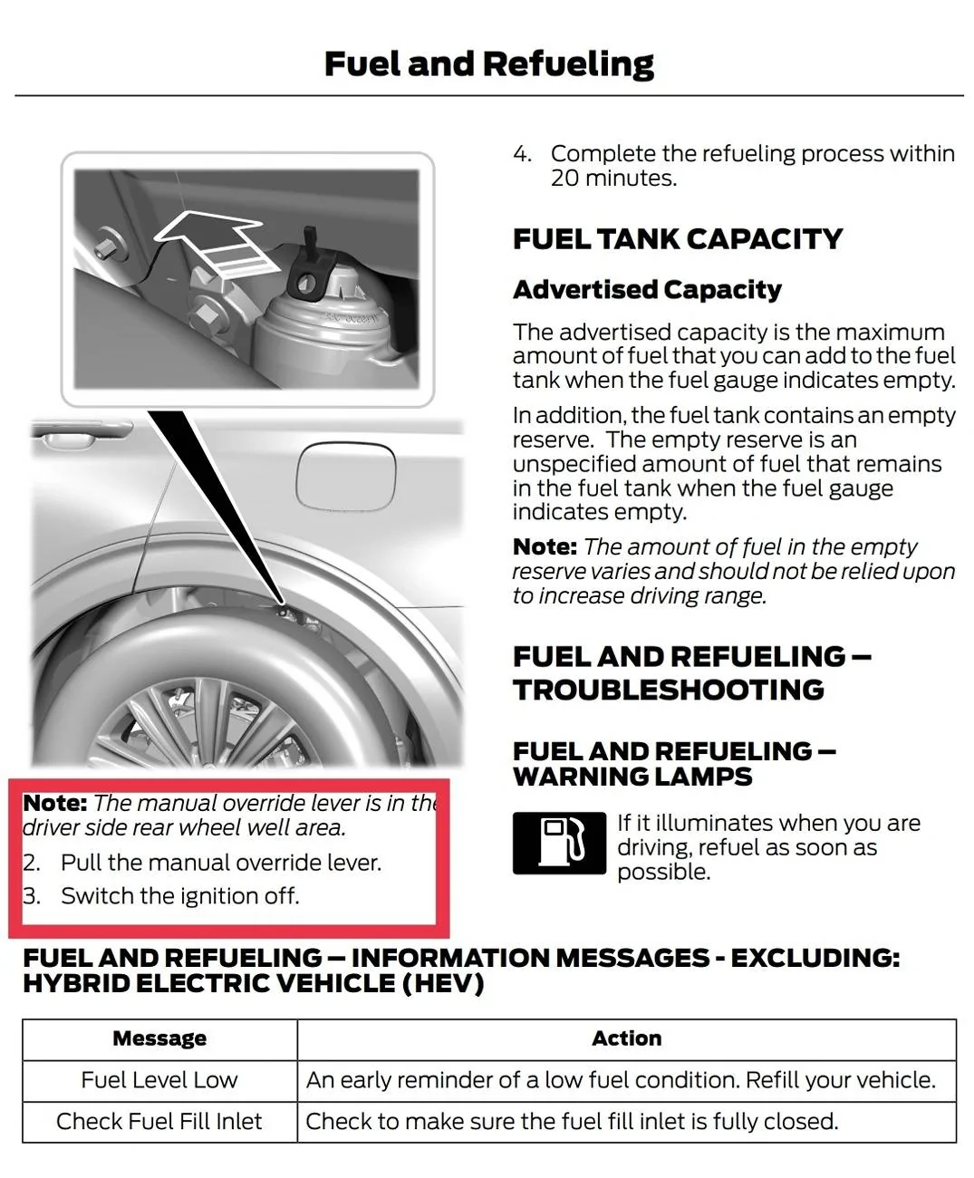

Will I find it in the index if I look for "green plastic thingy"?
The manual for my 2022 XL Hybrid says in an emergency I'm supposed to use a plastic tool stored with the jack to pry the fuel door open (p.178). It doesn't mention the thingy.
I just went to the garage and saw the thingy, which I've never noticed in three years. I pulled it and nothing happened, even after I turned the key in the ignition. Am I supposed to pull harder? I'm afraid I'll break a half axle if I pull too hard.
Here you go.
Ford Maverick New guy here...whats this thingy? IMG_20250430_162952

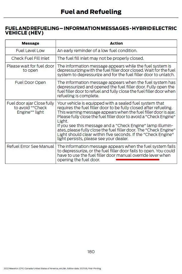

Here you go.
Glen, what is step 1 in your manual? That photo is not in the 2022 owner's manual. I searched for "override lever" and did find one mention on p.180 that said I could have to use it, but no instructions or photo.
Ford Maverick New guy here...whats this thingy? t1
Oops sorry
Ford Maverick New guy here...whats this thingy? IMG_20250430_165559

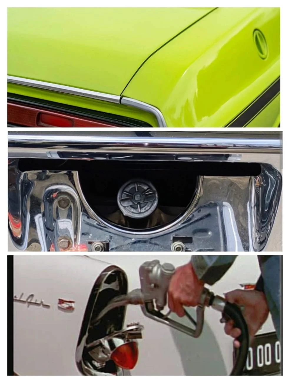

Im so old i remember when the gas tank just had a gas cap and a door that opened to get to it😳
I remember no door, just a cap.
I also remember opening the tail light or pulling the license plate down.
Ford Maverick New guy here...whats this thingy? IMG_20250430_173743
