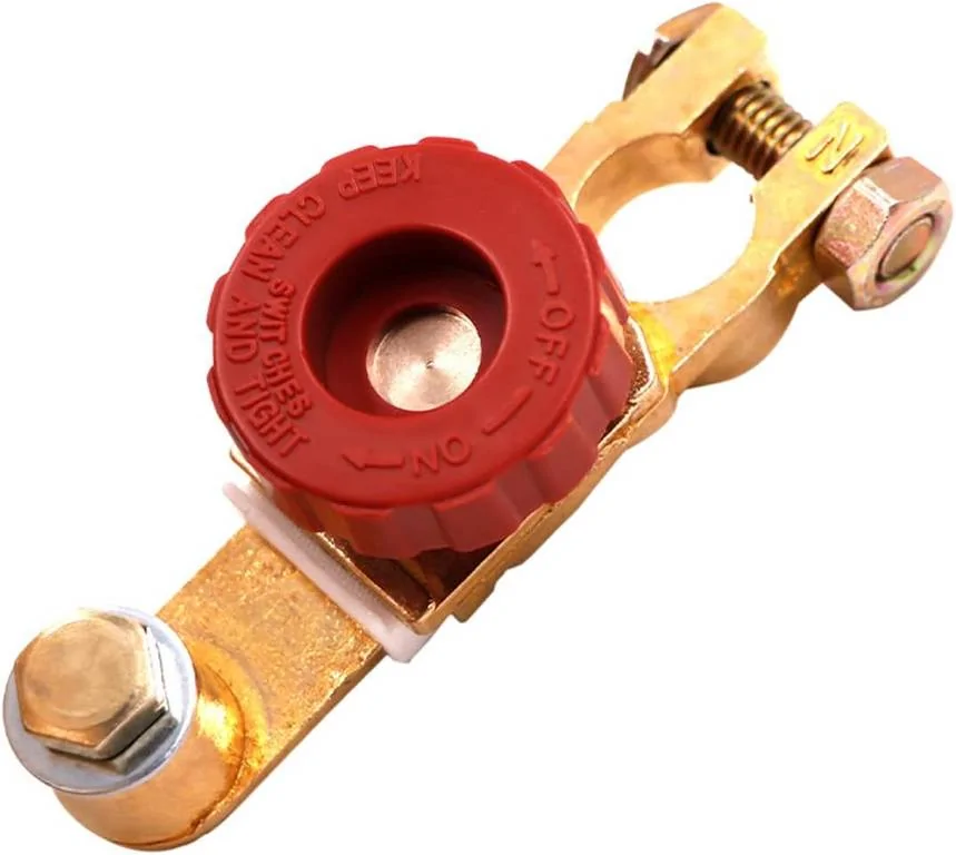

This might make your life a little easier for the remainder of your trip.

john can I ask where you purchased this disconnect
Johnkn
Jan 19, 2022
73
2,320
3,519
MD
I didn't purchase it, it's a representative example available on Amazon and probably most auto parts stores..... I thought it might help the OP on his trip so he doesn't have to continually physically disconnect his battery cable while traveling...

Sorry for the late reply. The battery is under the rear seat under a plastic cover. Easy to disconnect. Will possibly install a selector switch I use on boats!

Amazon has a remote controlled disconnect for $30.
I also open a case with Ford to see if they have a fix.
I like the idea of a remote control disconnect. I believe I have a case # as well. On my 2nd stop and working properly so far.
